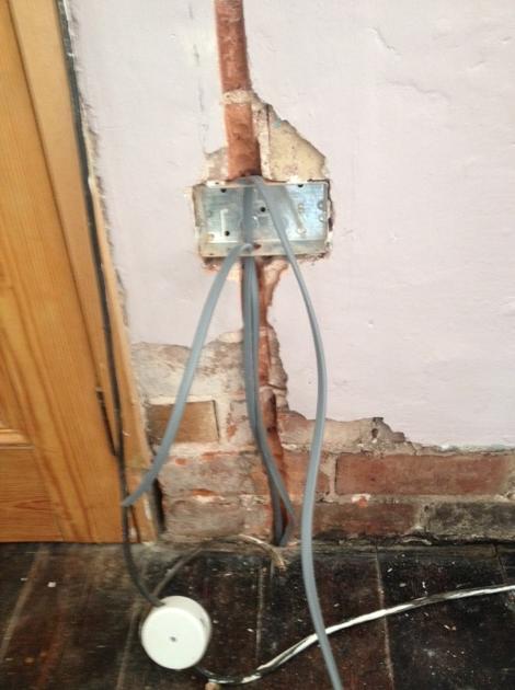

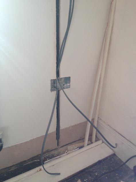

In the last thread I asked about running 2.5mm cable in the same chase as 1.5mm cable terminated at a light switch. There's been some debate about whether this means the 2.5mm cable would be in a safe zone or not.
My solution to the problem is to run the 2.5mm cable in the safe zone in the corner (150mm from the corner) - and then to run a horizontal safe zone to the light switch. Does that sound like a sensible solution?
I've started patching some of the chases this weekend - so far so good.
I also did a big chase today which will house 5 x 2.5mm cables and 2 x 1.5mm cables. I'll run a socket of this chase too. It's not as neat as I'd like, but hey ho, it's only going to be covered up.

your photo of the back of the dbl socket shows the wires cut very short within the sheathing which may make folding the cable back inside the pattress neatly more difficult.
I prefer to put a earth wire in between the socket and the back box.

That double socket termination is horrific. Horrible. The sheath should be cut back to the grommet in the box (just within). The inner cores should then be left around 5-6" long, and neatly swept inside the back box. You should also allow an earth fly lead from the box to the socket.
You said you were cutting more sheath off, so I wonder how short the cores were before!?! I can only assume your trying to save earth sleeve, lol.
It's a very poor design if you have to run a group of cables in a chase down the corner of a room. Every electrician avoids these safe zones. While they comply, it's considered poor practice to use them.
Just looked at the other thread, and all the photos are the same. Your opening yourself up to exactly the same responses.
Why hot glue? Oval conduit would hold the cables, and would probably be cheaper than wasting glue sticks, especially the quantity you have fired in.
1.5mm? If you're that strapped for money, why not 1mm? Not only cheaper, but easier to install and terminate for a diyer.
I was trying to do it too neatly - I'm leaving about 5" now.
This design was proposed by a couple of electricians who came to quote. In a house without wall cavities and without a cavity between the ground and 1st floor, I really don't know what other option there is. This is why runs for sockets on the bottom floor come down from the loft. We've also got exposed beams to avoid etc.
An extra £10 isn't the problem - also I'm concerned about voltage drop due to the lengths of the runs. 1.5mm gets me well into the safe margin.
Lectrician said:
Why hot glue?
The chases aren't perfectly smooth inside so fitting a semi-rigid conduit means having to cut the chases deeper. The purpose of conduit also, is to allow the cables to be removed/replaced. So its a personal choice on my part not to use conduit due to ease of installation - if the cables need to be replaced then the filler gets removed. No biggy. So I'm left with needing a temporary solution to fix the cables into the chases before they are plastered in, and hot glue fits the bill perfectly. It doesn't damage cables, it adheres well to dusty walls, it's easy to use.

Specifically on hot glue and PVC cables. Some hot glue will affect PVC by leaching (removing) plasticising material from the PVC. This makes the PVC brittle.
The immediate damage will be limited to the surface skin of the PVC sheath and unlikely to affect the insulation on the conductors. It is also likely that the leaching will have ceased when the glue had cooled to ambient temperature. Leaching or other reaction with the glue may occur if the cable becomes warm due to current passing through it.
The safe zone in the corner of a room is known to electricians but as mentioned they seldom use it since other trades and DIY people may not be aware that there may be cables buried in the wall in the corners of rooms.

Perhaps in that case you have a suggestion? The context is a property with only one cavity, the loft (no floor or wall cavities). The CU is on the bottom floor. The only sensible way to wire 2/3rds of the downstairs is by running cables down from the loft.
How do you suggest getting the cables (5 x 2.5mm, 2 x 1.5mm) from the CU, into the loft?
The remaining 1/3rd of the house does have a floor cavity which makes it a whole different kettle of fish.
Cables are designed to run at upto 70 degrees. This is normal.

Take the cables up in a duct.
Not dissimilar to my "context", mine also has stone/rubble walls that cannot be chased.
You could take a single cable as a sub main from the meter location to a CU in or just below the loft. This might mean 2 consumer units but if it makes for safer installation a small price to pay.
