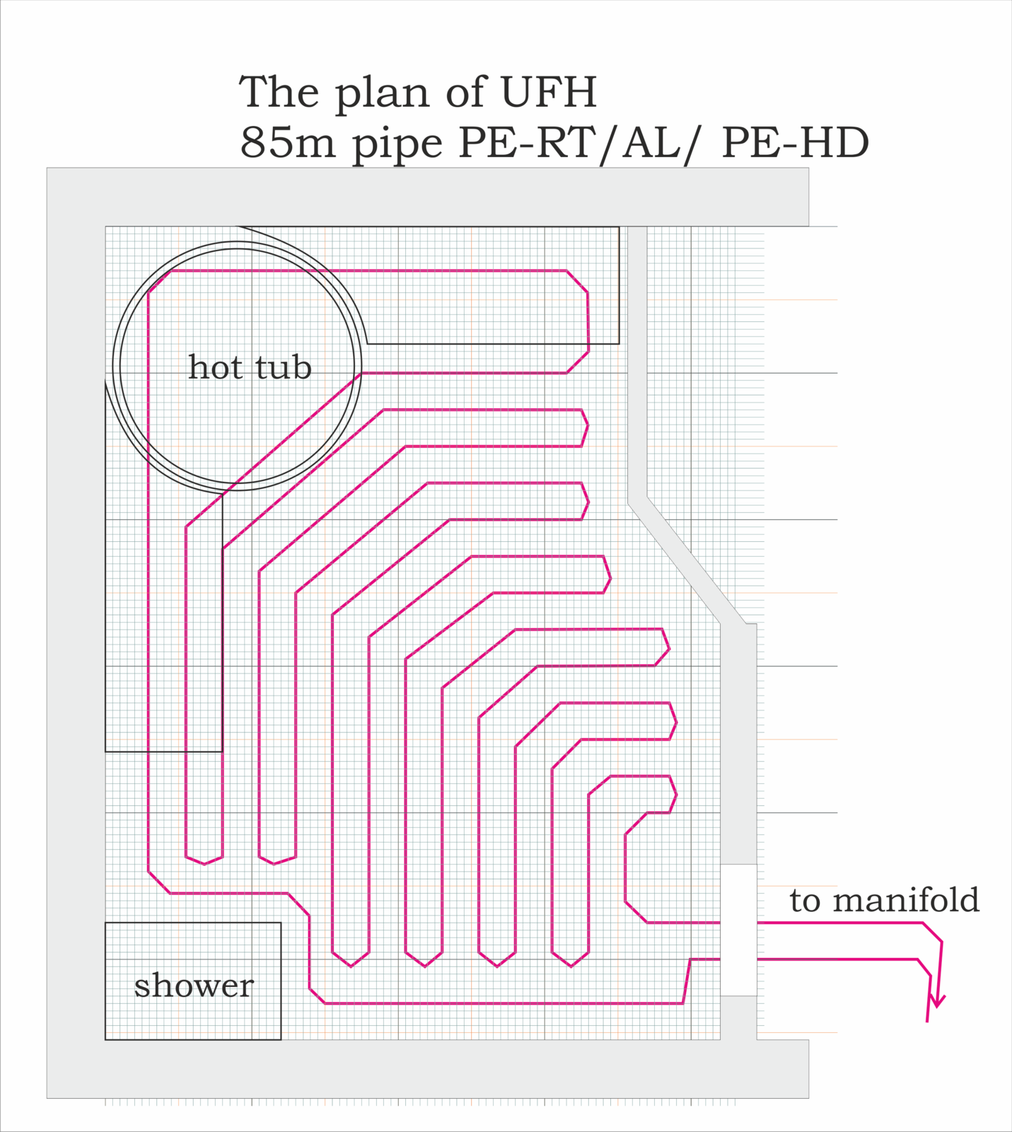

Нi Friends
I am Zmicer
I will show you a new project.
I hope it will be useful to everyone who builds a house.

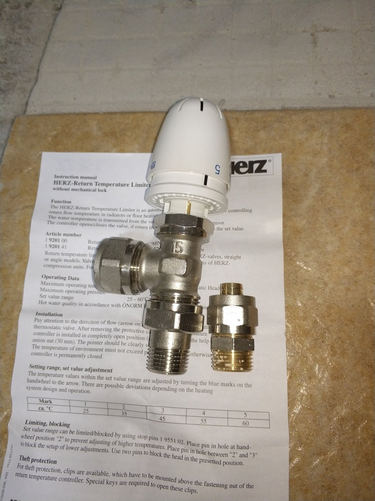

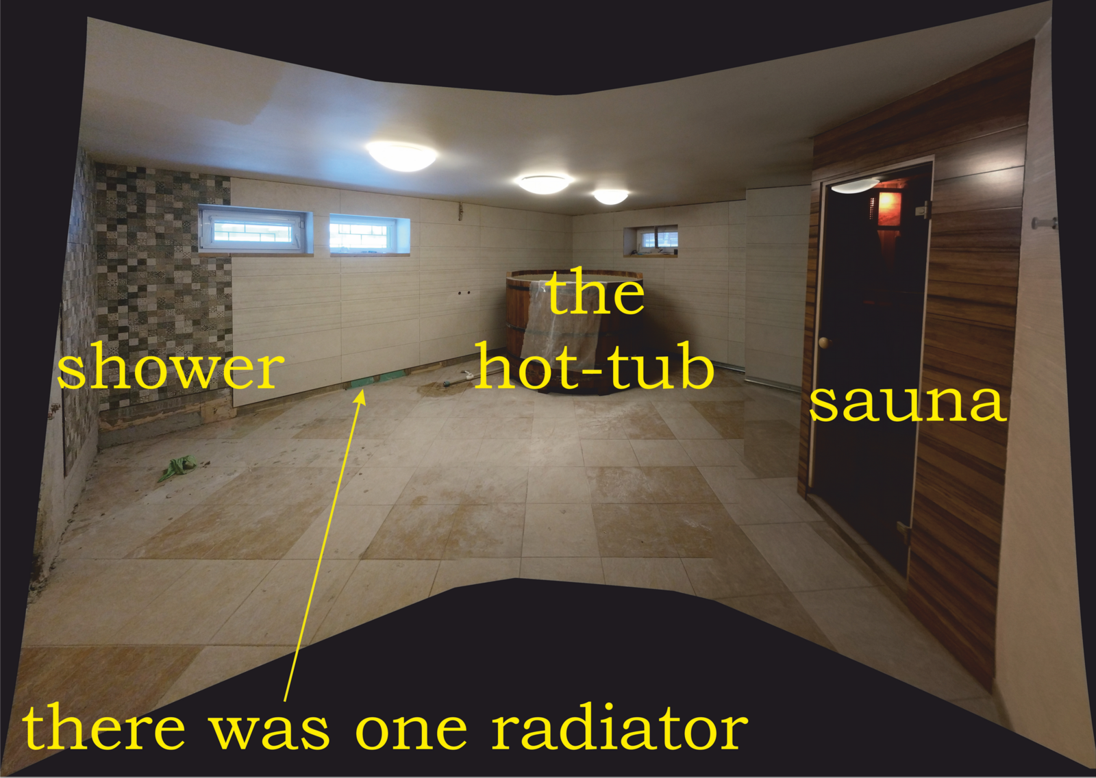

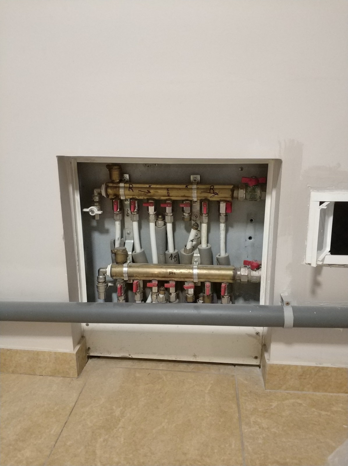

Equipment did not work the proper way.
There were installation mistakes from the very beginning, and
Underfloor pipes of heating system were leaking.

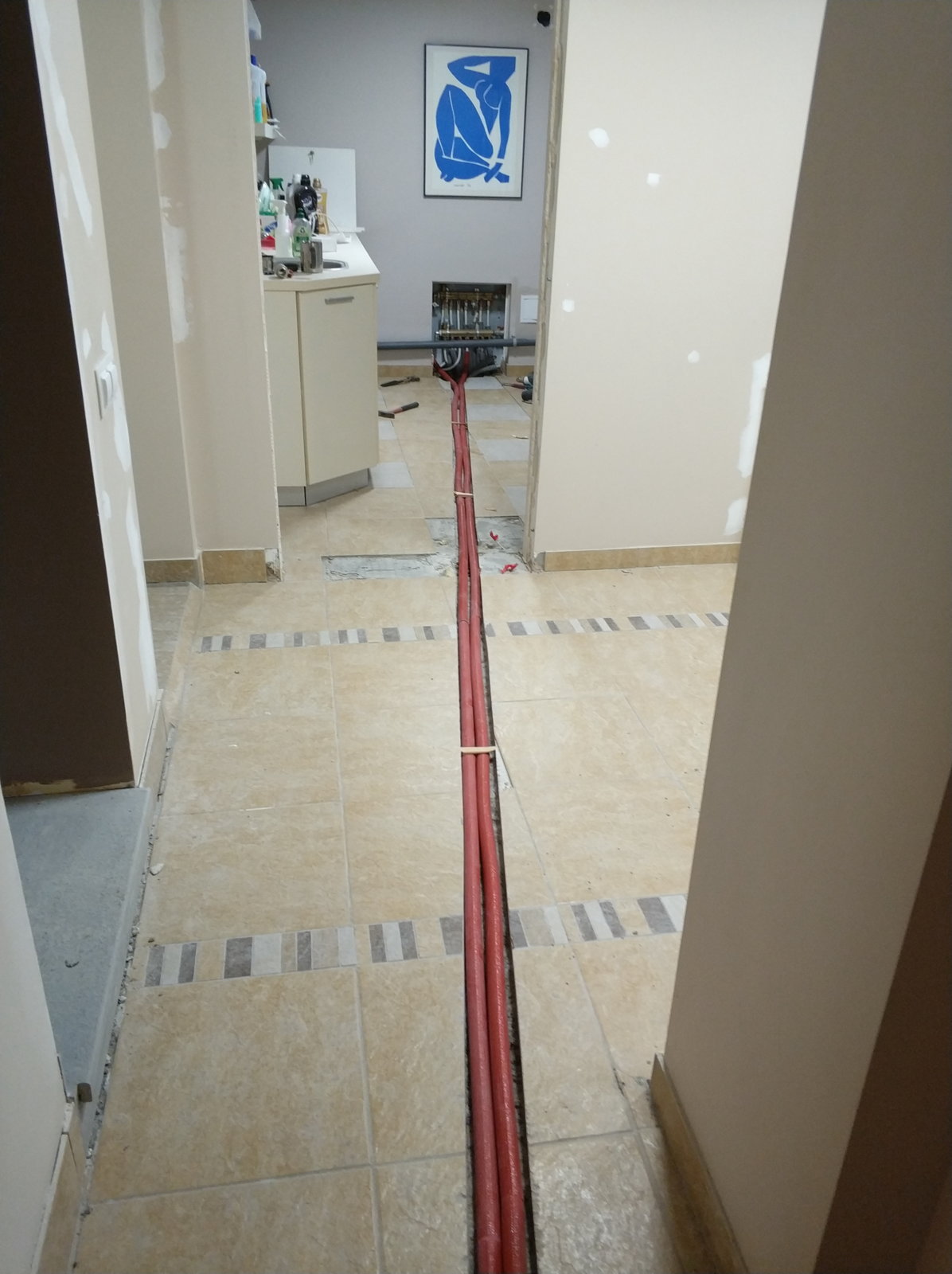

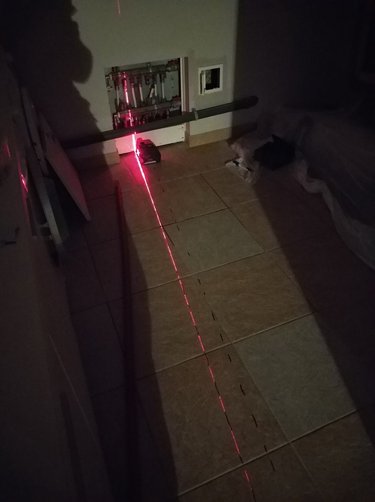

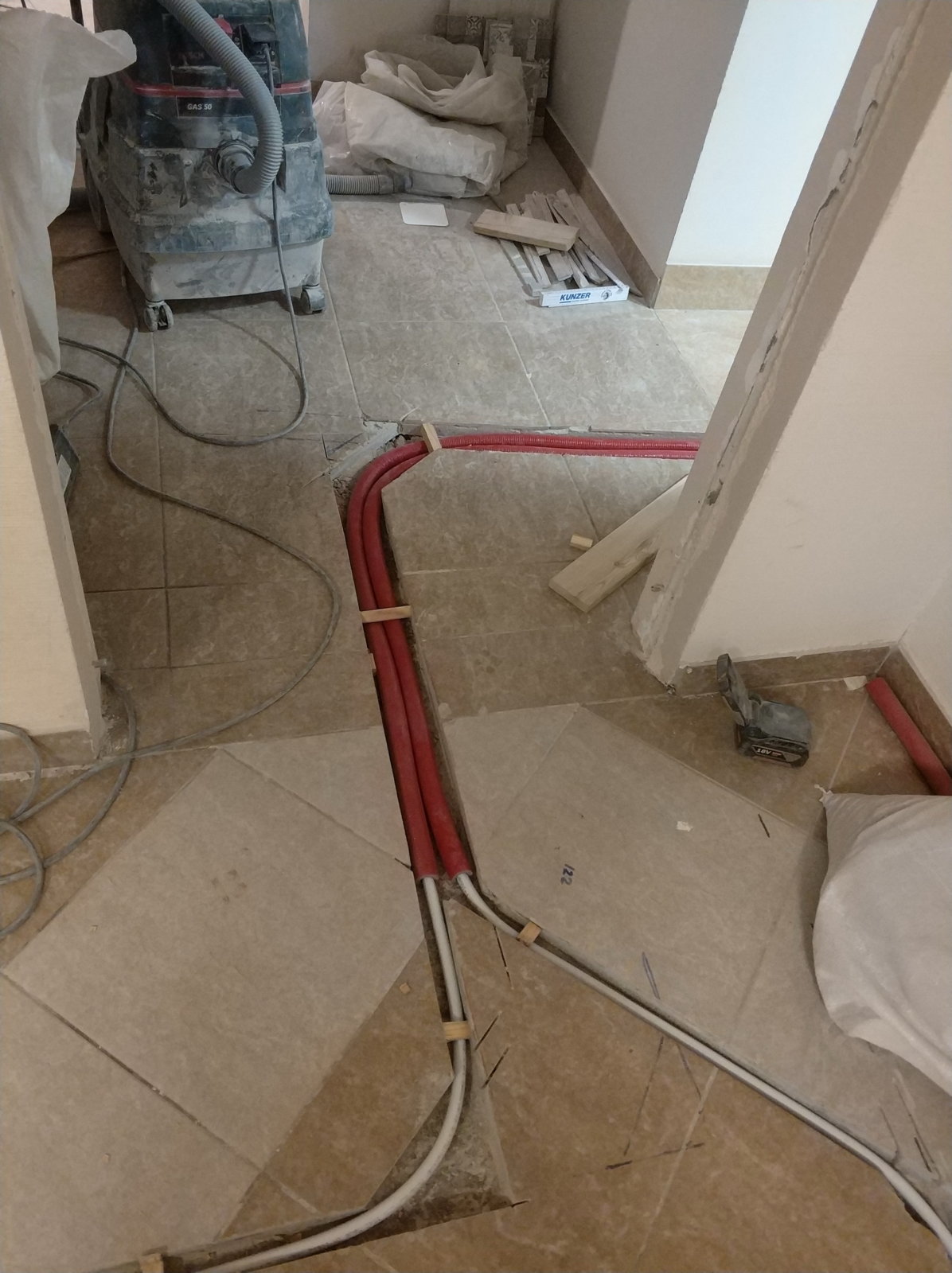

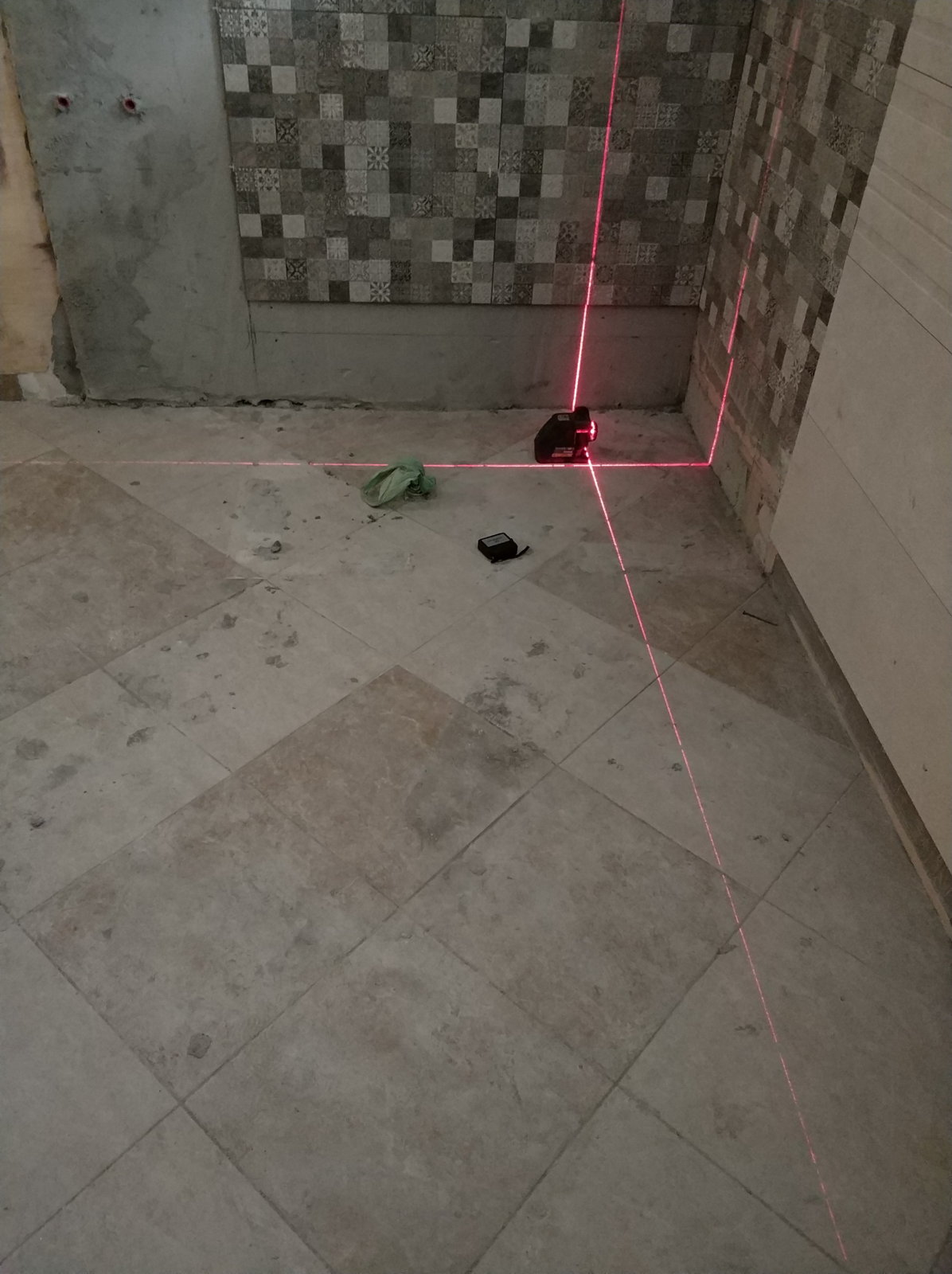

We decided to replace radiator to one loop of UFH with RTL valve.

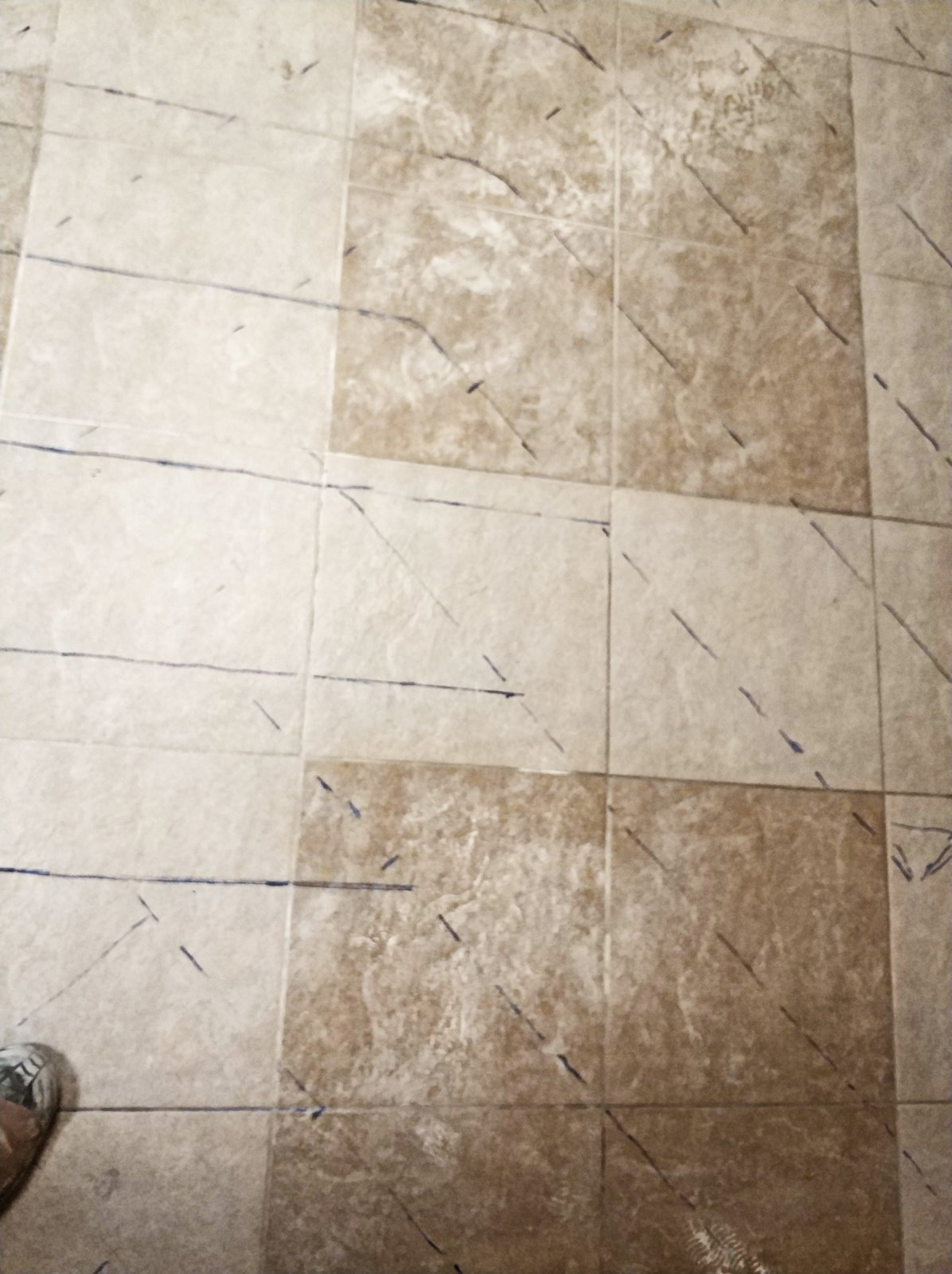

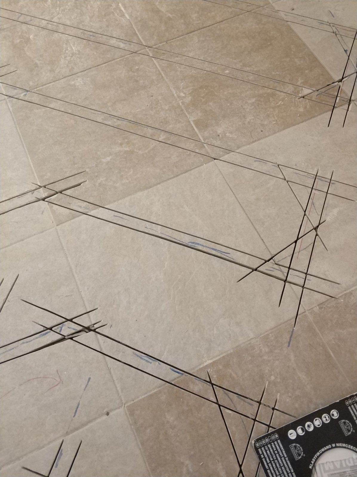

basement bathroom о.png the manifold of CH.jpg IMG_20180222_135452.jpg draw channels.jpg draw channels 1.jpg draw channels 2.jpg the crazy step cut channels.jpg cut channels.jpg cut channels 1.jpg

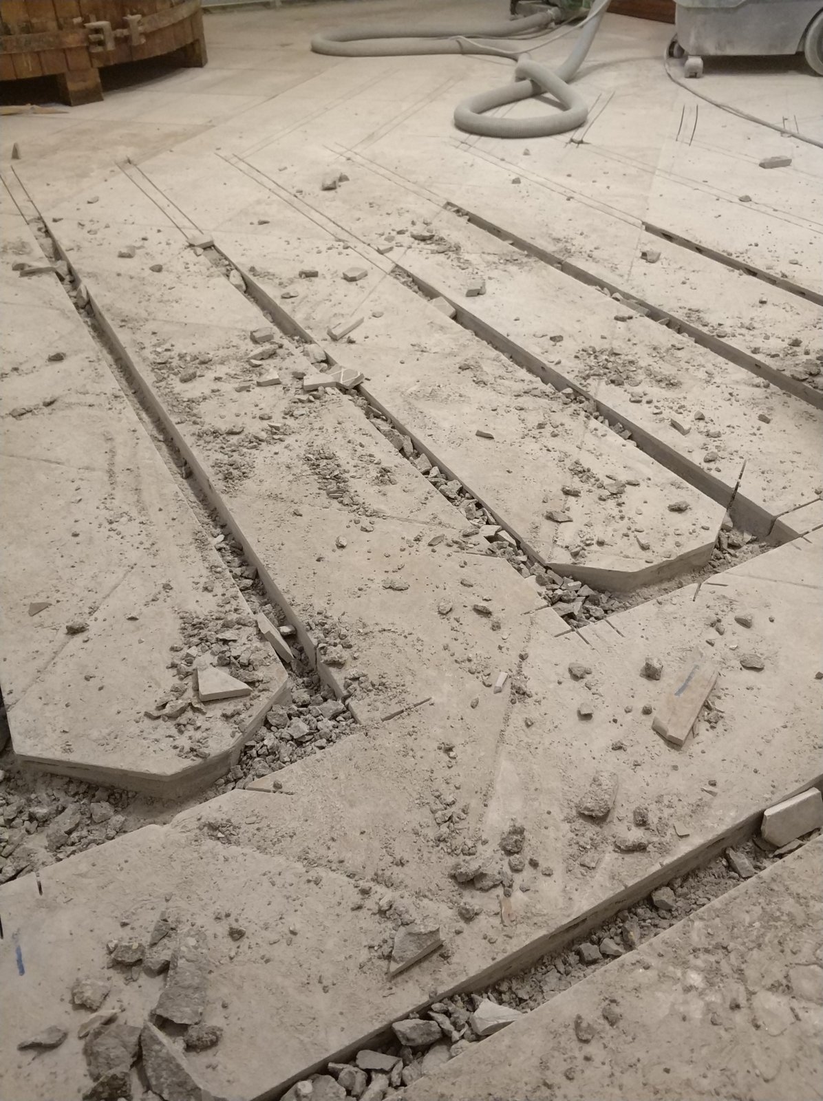

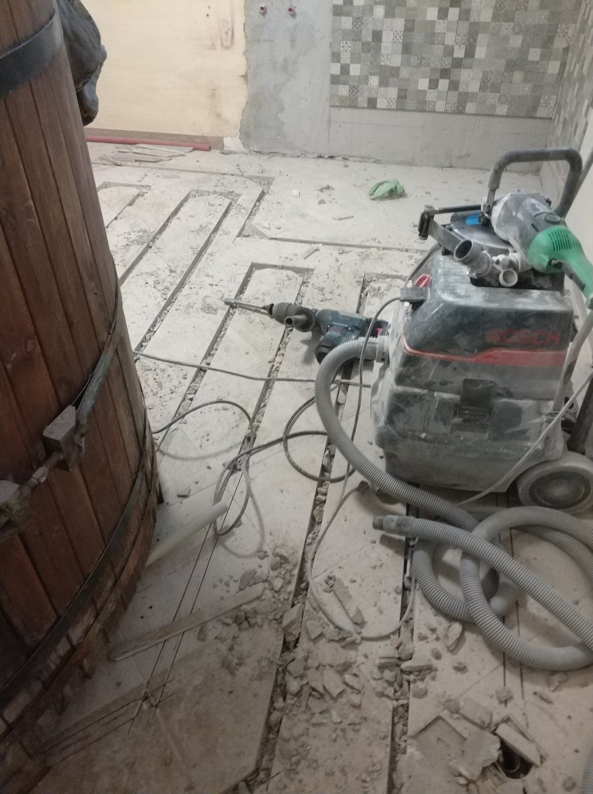

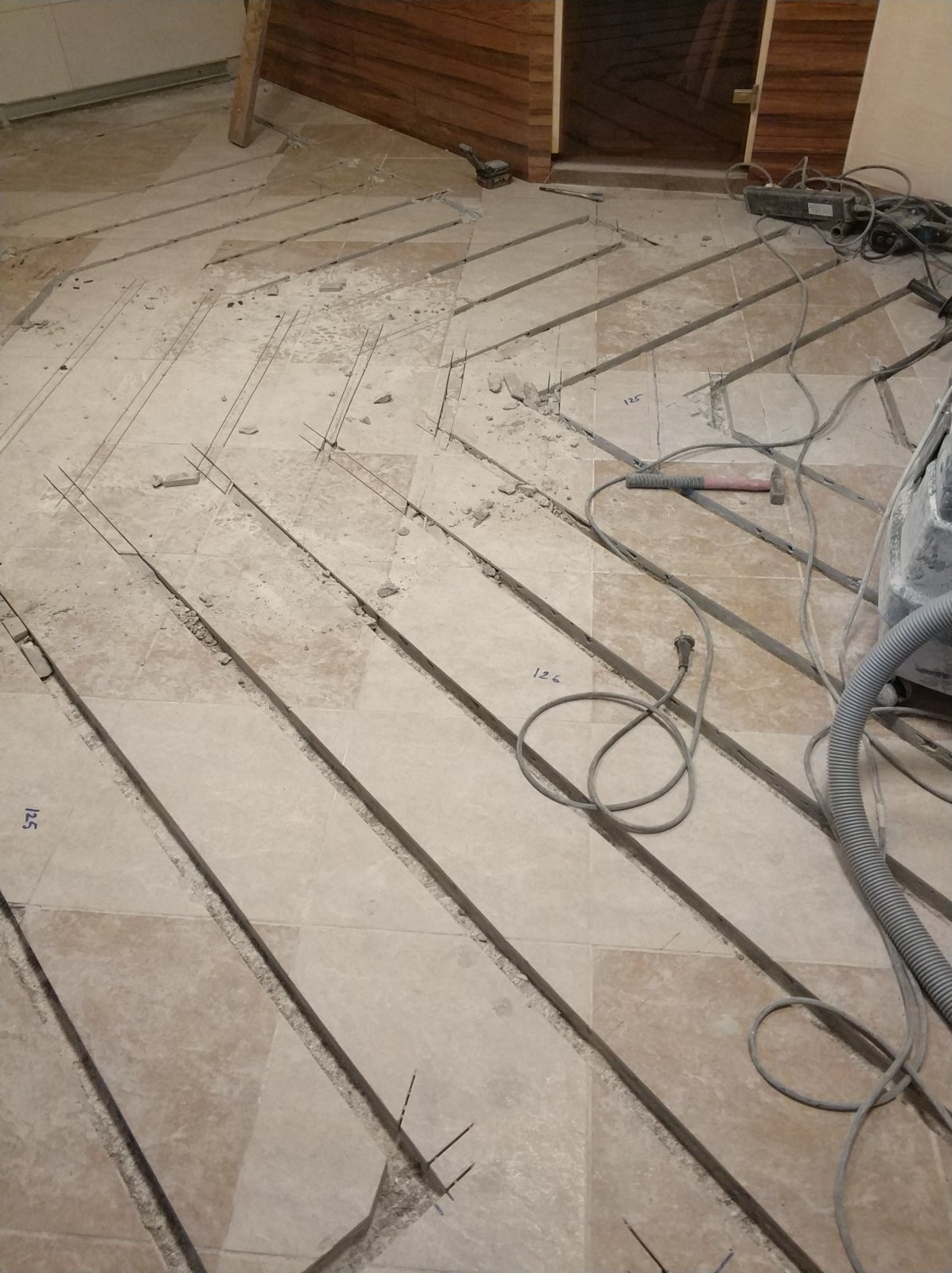

very much concrete cutting.
Should have taken the tiles up, fitted insulation, done the pipework, and then relaid the tiles. Your way is going to be expensive to heat, and not as hot as it should be.
Thank you for your advice.
Yes i know about it.
This work is a necessary compromise.

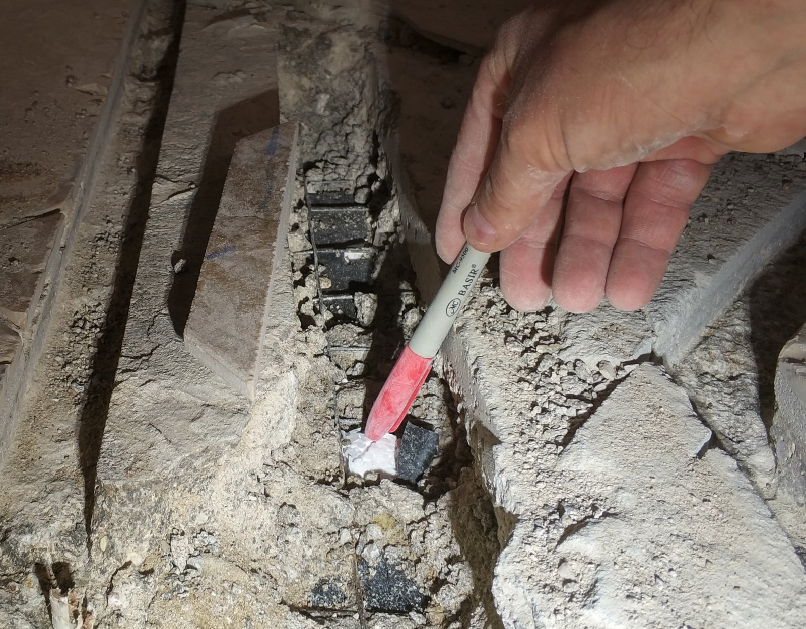

It is not so bad. The basement has small heat loss and under the cement screed there is insulation.
in the pictures more detals.

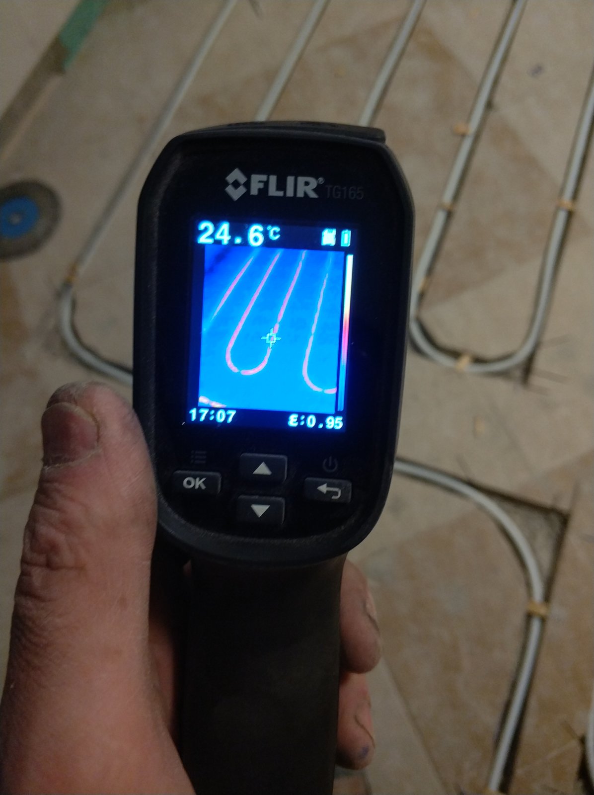

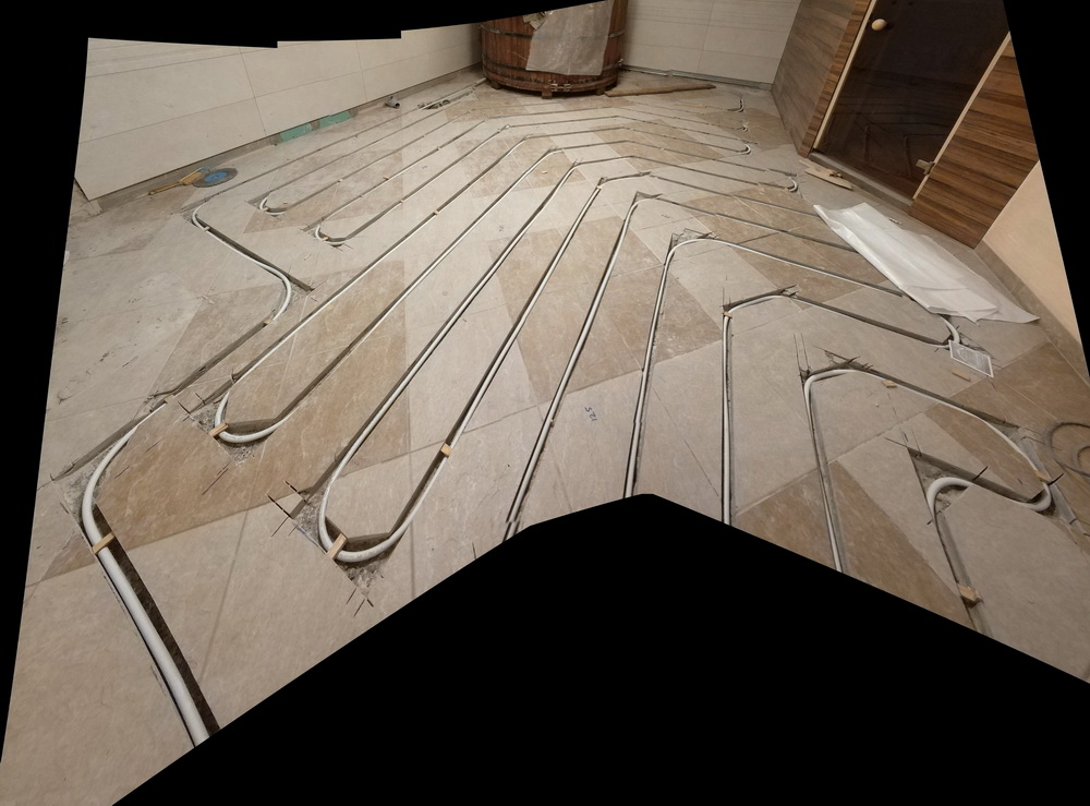

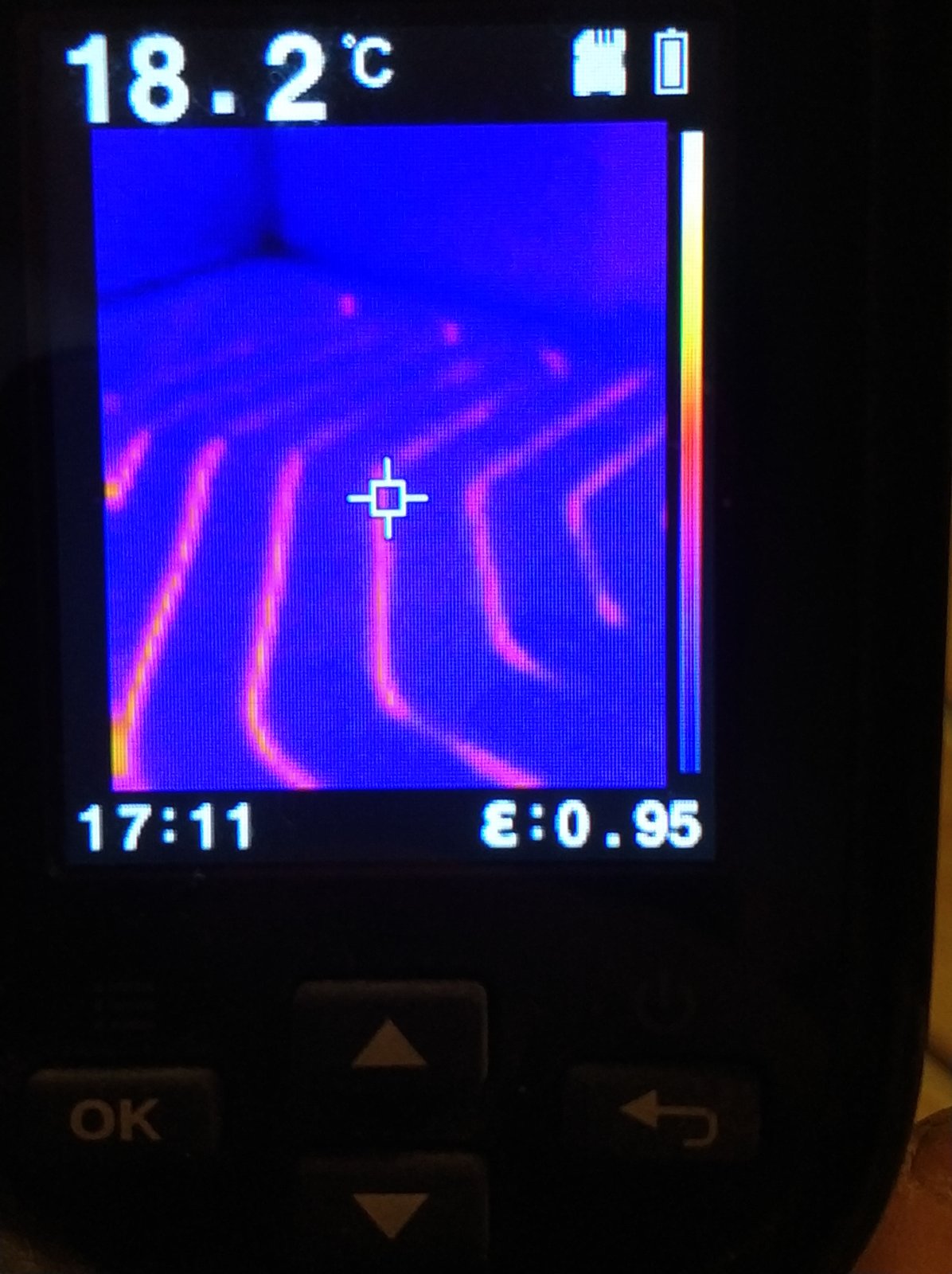

That's what I did today.
