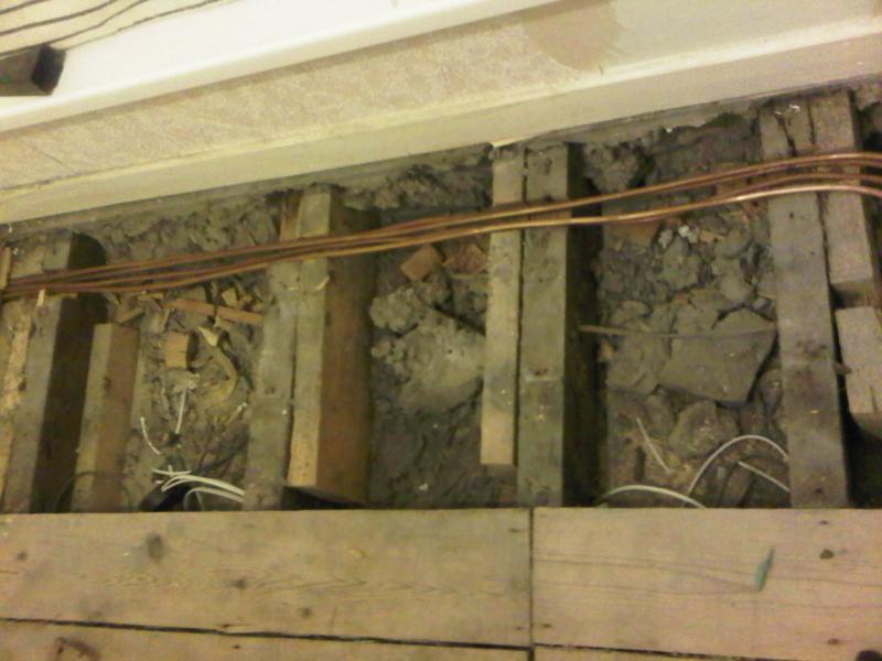

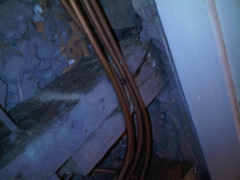

** IS IT SAFE FOR THESE ELECTRIC CABLES TO BE SO CLOSE TO BOILING PIPES? **
Take care when you're pulling up the floorboards as they're worth a bob or two!
No
Heat reduces the current-carrying capacity of cables, and also shortens the life of the PVC insulation (if it is old rubber it will already have been ruined and need to be replaced)
For a start put Climaflex or similar insulation on the pipes. This will prevent the cables touching the pipes; and will lower the temperature of the underfloor void, and will also save heat wastage.
If you cannot reroute either the pipes or the cables, then put a plasterboard partition (which is fireproof but not much of an insulator) between them as well. Clip up the cables so they are not draped on the pipes. If there is room put a layer of loft insulation under the cables (do not surround the cables in insulation) as well as the Climaflex.
Put a thermometer in there with the heating running and tell us what the temperature is in that void around the cables.
Cables should not be bunched together as this also reduces their current-carrying capacity.

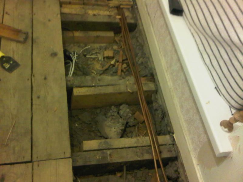

While writing this reply i had a look under a few more boards and Ill post the pics up now..
the joists are doubled-up (any ideas why this is ?? ) and i have come across a central heating system, that has pipes laying on top of joists, crushed between joist and floorboard :eek:
This seems to just be unsafe!
also, the stone wall seems to have started collapsing and has left alot of stones and rubble between joists.
What are your toughts? Is it something worth worrying over?
1. pipes crushed between joist and floor.
2. new seperate joists next to original ? why ?
3. space between joists filled with rubble from walls
thoughts needed asap.. pics are up too
I've found all sorts under my floorboards including rubble, ciggie butts and even a tampon :eek: (unused thank God!).
When my Auntie had her shower tray replaced, there was a half-eaten sandwich under it!!!!!
Maybe the joists are doubled as whoever's installed the pipes has had to notch the existing joists and the double joist will provide a little extra bracing.
I'm a Building Services Engineer by trade and photos like that bring me out in a cold sweat, however "house bashers" seem to have a fondness for installing pipes like that as it's quicker and less hassle than bracketing properly and insulating the pipes. Then the poor homeowner wonders what those knocking noises are when they turn their heating on/off

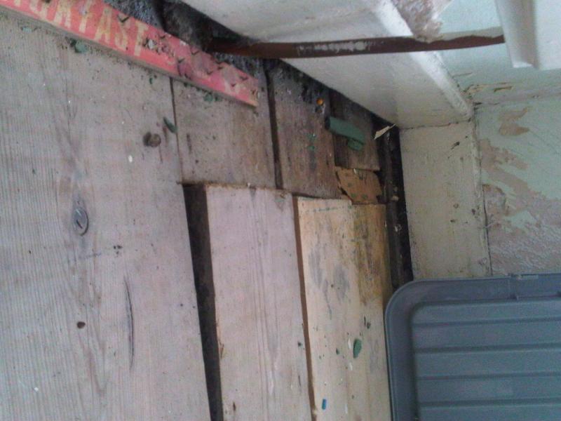

MY ONE PROBLEM IS THIS.....
at one end of the room foorboards continue under a partiton wall from
bedroom 1 to bedroom 2.
how on earth do i get this out??!? because i can garuntee the previous didnt take any nails that are under the wall out so it was easy to remove the flooring.
so so*s law: the wall will be on top of a joist, on which the floorboard is nailed into with a 4inch nail !!
what can i do?
