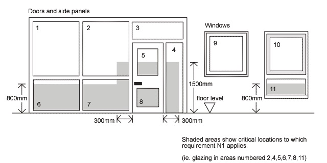

Below what height must we have toughened windows on the first and second floor of a house because I have seen and heard different heights depending where I look. Is it below 900mm or 800mm and is that the glass or the wooden ledge?

Ok. My concern is that some of my existing window openings are at 760mm ie the glass within the UPVC frame starts at 760mm height but the frame is a little lower. If we now replace those windows these will definitely have to be toughened right?
If yes then can only part of that glass be toughened (assuming you can toughen some part of the glass and not the rest?
There is no requirement for toughened glass.
The requirement is that glass within a critical location - in this case within 800mm from a floor or platform, should be in either small panes, be protected from impact, or if it breaks to break safely.
And no, you can't just have part of a pane toughened
There is also a requirement that glazing within close proximity (300mm) to protected areas be made the same.

Some glazing firms have indicated that only the inside pane is toughened and the external pane is not.
Also if you have panelled glass with a break in material, I guess it's only the lower sections and not the upper ones which are in their own pane that don't require toughening.
It's both panes of a DG unit, as the requirement relates to any glass pane within the critical zone.
Likewise, yes a glazing bar will break up the zone, so only glass within the critical zone needs to meet the requirement.
