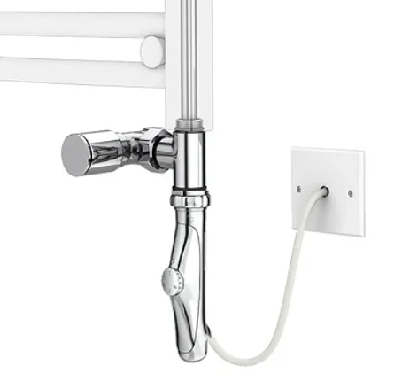

I've just replaced my towel rail element, as the one that was there before was only 100w, and it never got above luke warm.
I put in a 400w one (https://www.screwfix.com/p/flomasta-towel-radiator-heating-element-white-400w/245tf) , but this is so hot you can barely touch the towel rail.
Should the rail be this hot? The rail itself is 500x1000.
If not, how am i supposed to know which element it requires? I dont want to get a thermostat controlled one, as these are expensive, and i thought the whole point of an element was to reach a specific temperature.

Well, I suppose it begs the question "How hot is this hot?" but - generally, yes.
It wouldn't be much use otherwise as you have found.

A heating element provides heat energy the whole time it's turned on.
In a radiator, it will only stop increasing in temperature once the heat losses from the radiator are equal to the heat input from the element.
The only way to change that is to install a thermostat which switches the element off when a certain temperature is reached.

400w is clearly too much for that level of heat.
Blup
Well a certain Victoria Plumbing supply a 300 Watt element with a towel rail kit of that size, for what that is worth.
Flomasta quote a 299 Watt output rating for that size in their range at deltaT 50.
I expect even the simplest heaters must have a built in thermostat, just to limit the temperature of the fluid in the towel rail? This place https://www.electricradiatorsdirect.co.uk/news/a-guide-to-our-towel-rail-heating-elements/ reckons 65 C --- which would suggest a bit hotter than that at the top when the fluid at the bottom element reaches that 65 C point via thermal convection.
It is a potential burns risk (as are all CH radiators where the circulating water is around that temperature).

From table 42.1 A part intended to be touched but not hand-held metallic 70°C. A part which need not be touched for normal operation metallic 80°C but I would say a radiator could reach 80°C but you need to touch a towel rail to put towels on/off it so 70°C.
However I fail to see how one can ensure this with simple time, as how many towels and how thick the towels are would change the temperature, and clearly if the water was to boil, there is also a danger with pressure, in the same way as we are forced to have a cut out on the immersion heater the same must also apply to a towel rail.
Yes a simmer-stat in suitable box, could control the temperature, but then we get into type testing, and what is safe for use in a bathroom, I did look at a thermostatic version 1698401268845.png it was £40 so £17 more, but can't see how one would fit on my towel rail, it comes down to far, I suppose at 100 watt it is unlikely to get that hot, but at 400 watt that is the size of the heater I used to keep my caravan warm, I used time for my domestic hot water, and there all timers designed for an immersion heater
but that costs £20 so more than a proper element with thermostat.
