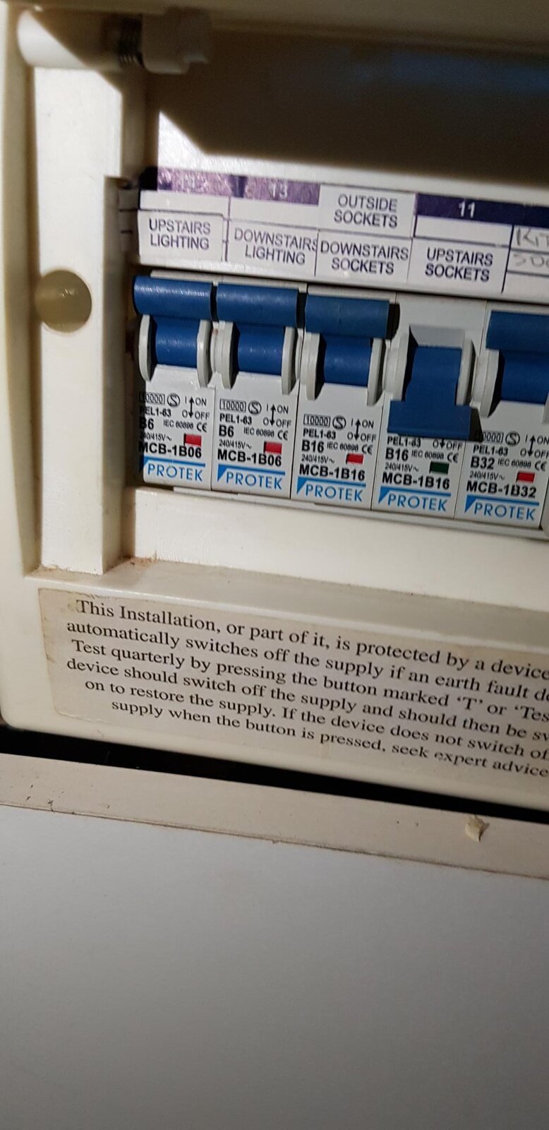

Hi all, I have a problem with upstairs power sockets (upstairs and downstairs lighting and downstairs sockets are all ok) The fuse for the upstairs just trips out and wont re-set. There is a dead short on the circuit somewhere....we have had problems with a mouse between the floor and ceiling and I suspect it has chewed through the cable insulation causing the short. Is there any way of tracing which part of the circuit has the problem section of cable without having to take up all of the floorboards rather than just the affected bit?
Firstly: Is the tripping device an MCB or RCBO? Picture if you are not sure - just copy and paste.
Is it a ring final or a radial?
how many sockets are involved?
Have you got a test meter?

Thanks all...here is a pic of the tripped fuse
Ok, that suggests there is a fault, either with the device because it has been supplying more than 16A for items plugged in - not really likely for upstairs circuit, OR
there is a fault between L & N or L & E which should be detectable with the meter using the method suggested above.
