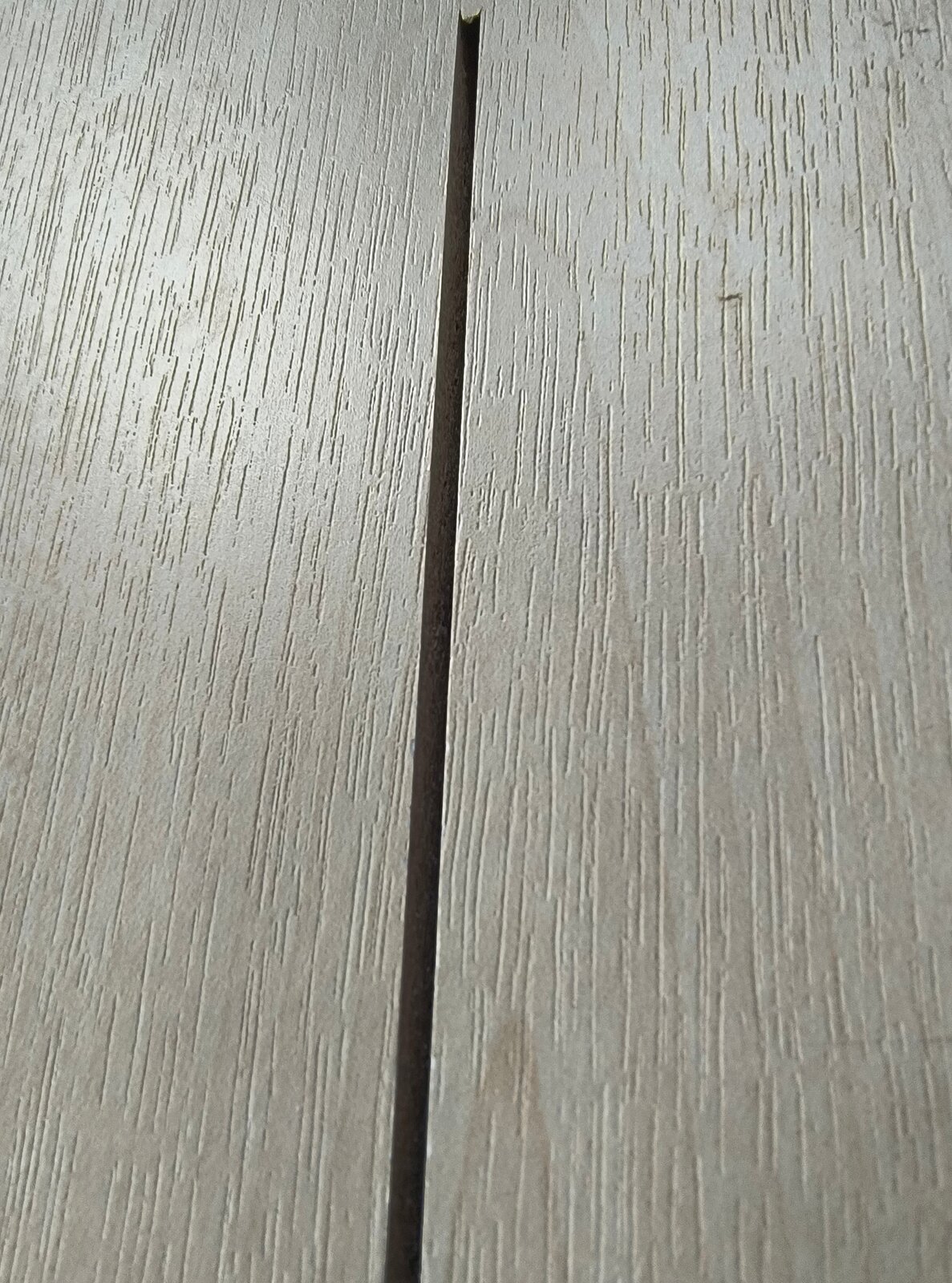

How to cut melamine mfc with a Plunge Saw and rail.
The rail rubber needs to be in mint condition.
When cutting the top edge using the rail, set the plunge saw so it only cuts a depth of 2mm through the board, instead of cutting away from yourself, set the saw at the end of the cut a Plunge 2mm and pull the saw backwards "slowly" effectively scoring the mfc, then set the saw to cut full depth.
To stop the underside chipping, lay the board you are cutting on a sacrificial piece of wood, so you cut through the board you are using and into the board underneath, this stops breakout on the underside.
Lightly sand both cut edges to stop breakout when fitting.
Some MFC just chips, I use 48 tooth Triple Chip blades.

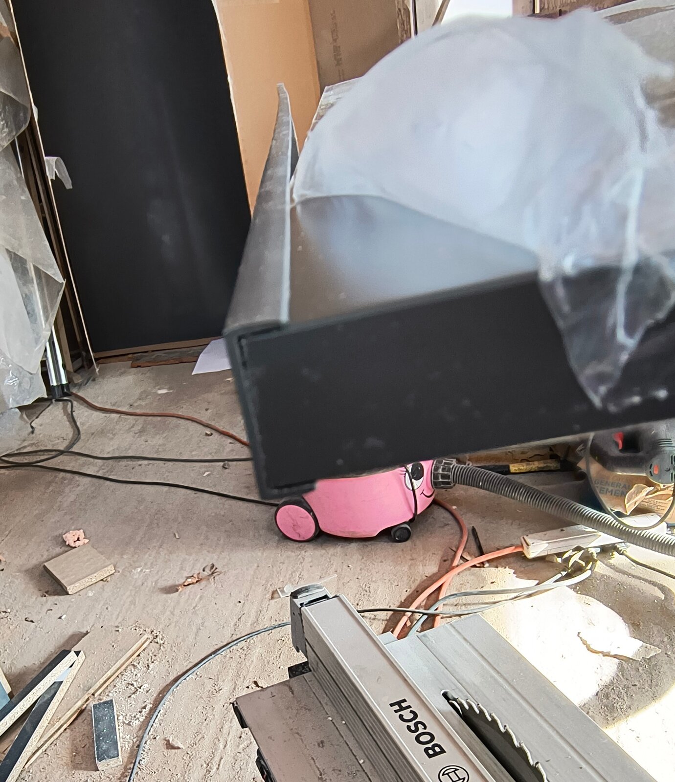

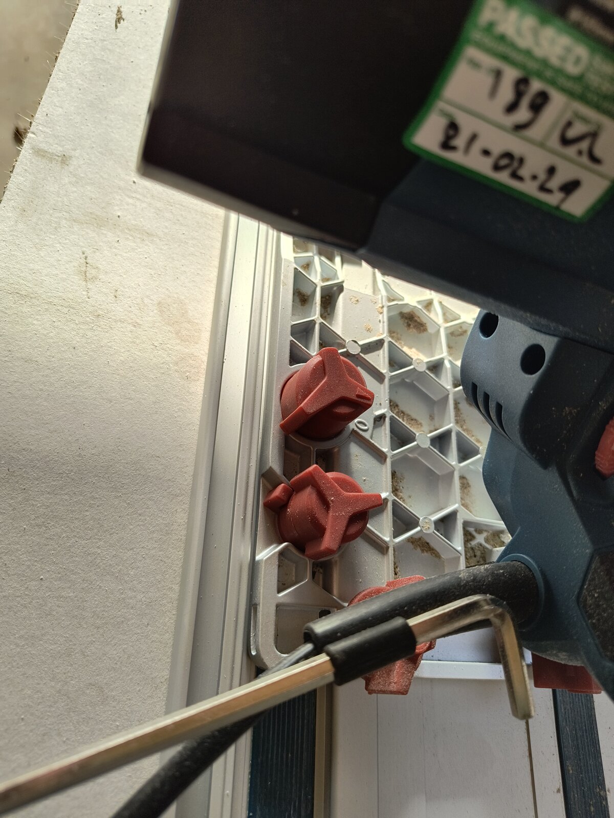

Thanks, rails are new (2 x Makita 1.5m). The saw does have a "score" setting so I'll try that - it doesn't seem to want to slide backwards - there is a spring loaded knob on the plate (not the front one that locks in into the track) that stops the saw sliding backwards - but I can hold it open I suppose:

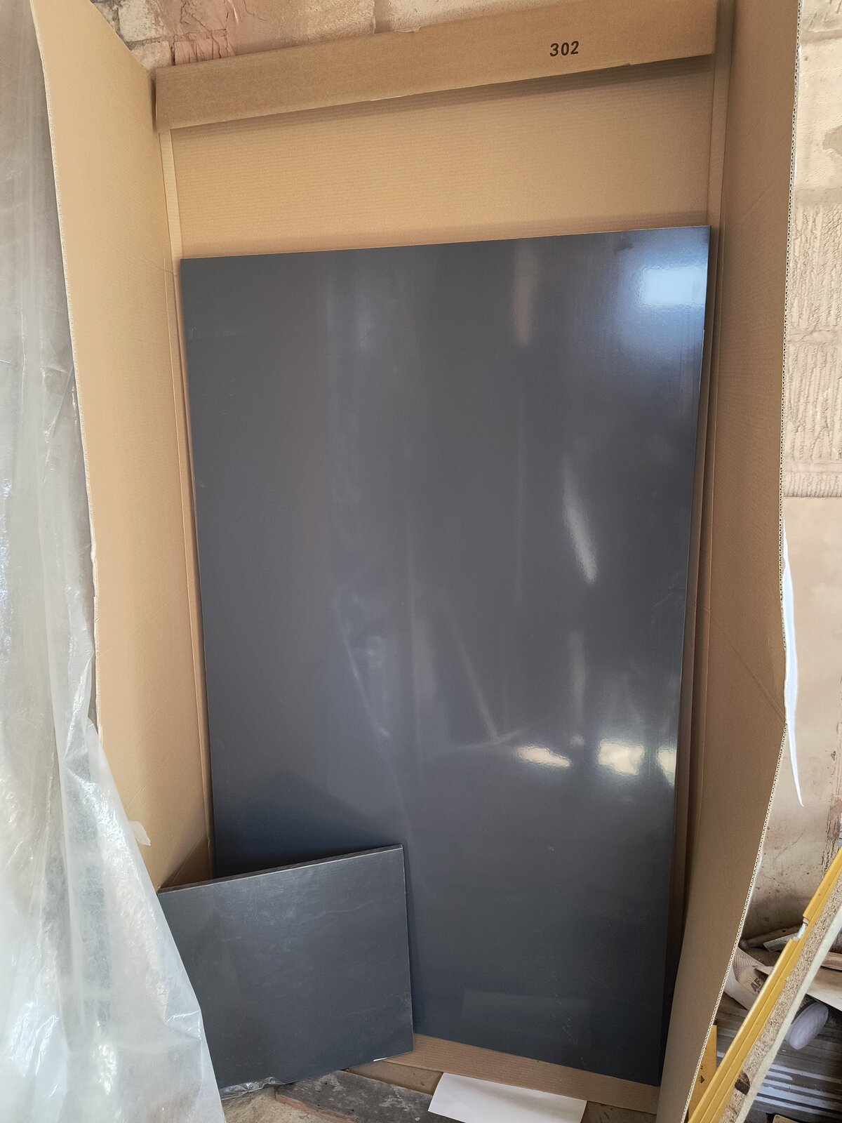

I don't know what make the sheets are, I think they're actually back panels for breakfast bars.

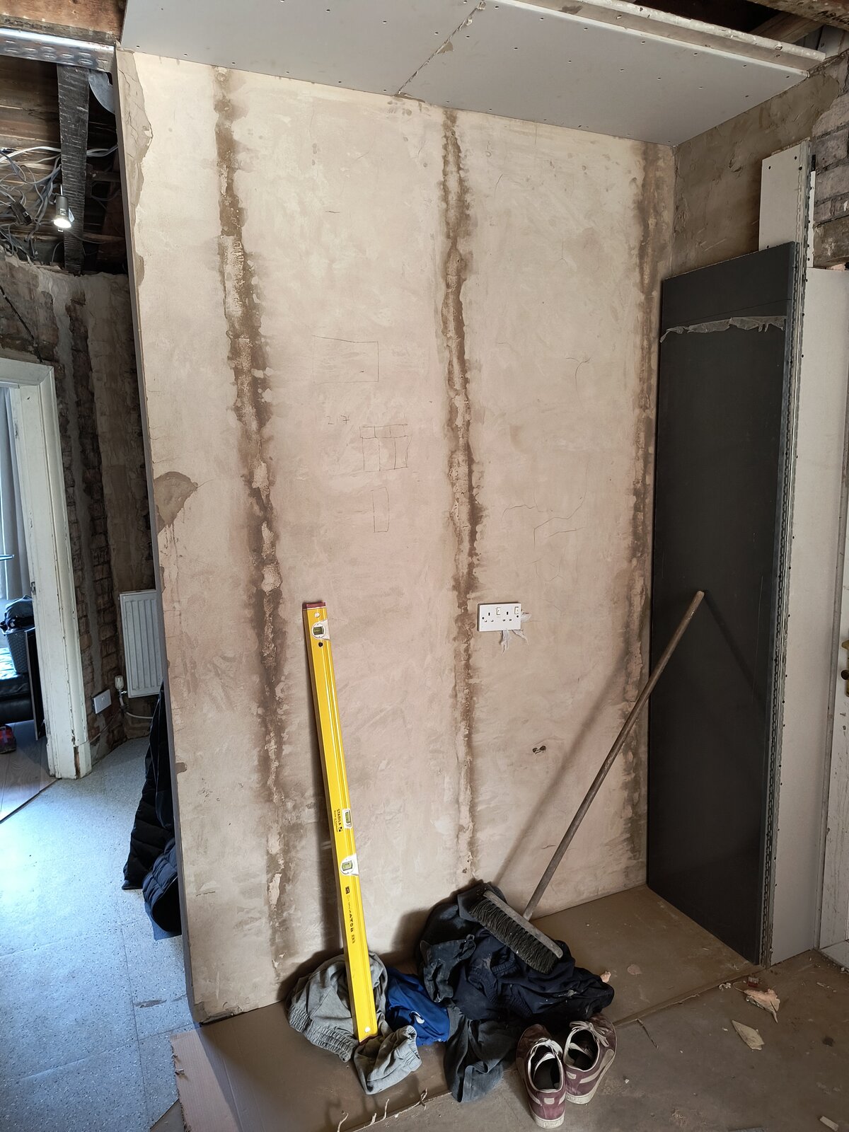

The job is to build 3 x tall larder type units to fill this space:
The units will built in to studwork with slab doors and Gola true handleless rails - if it goes ok I might have a go at the entire kitchen - this is just a trial to see how I get on - with these cuts, the rails, using the confirmat screws (snappy RTA on its way) and fitting the doors - they're Howdens and pre drilled for hinges so it'll just be the carcass holes, internal drawers etc.

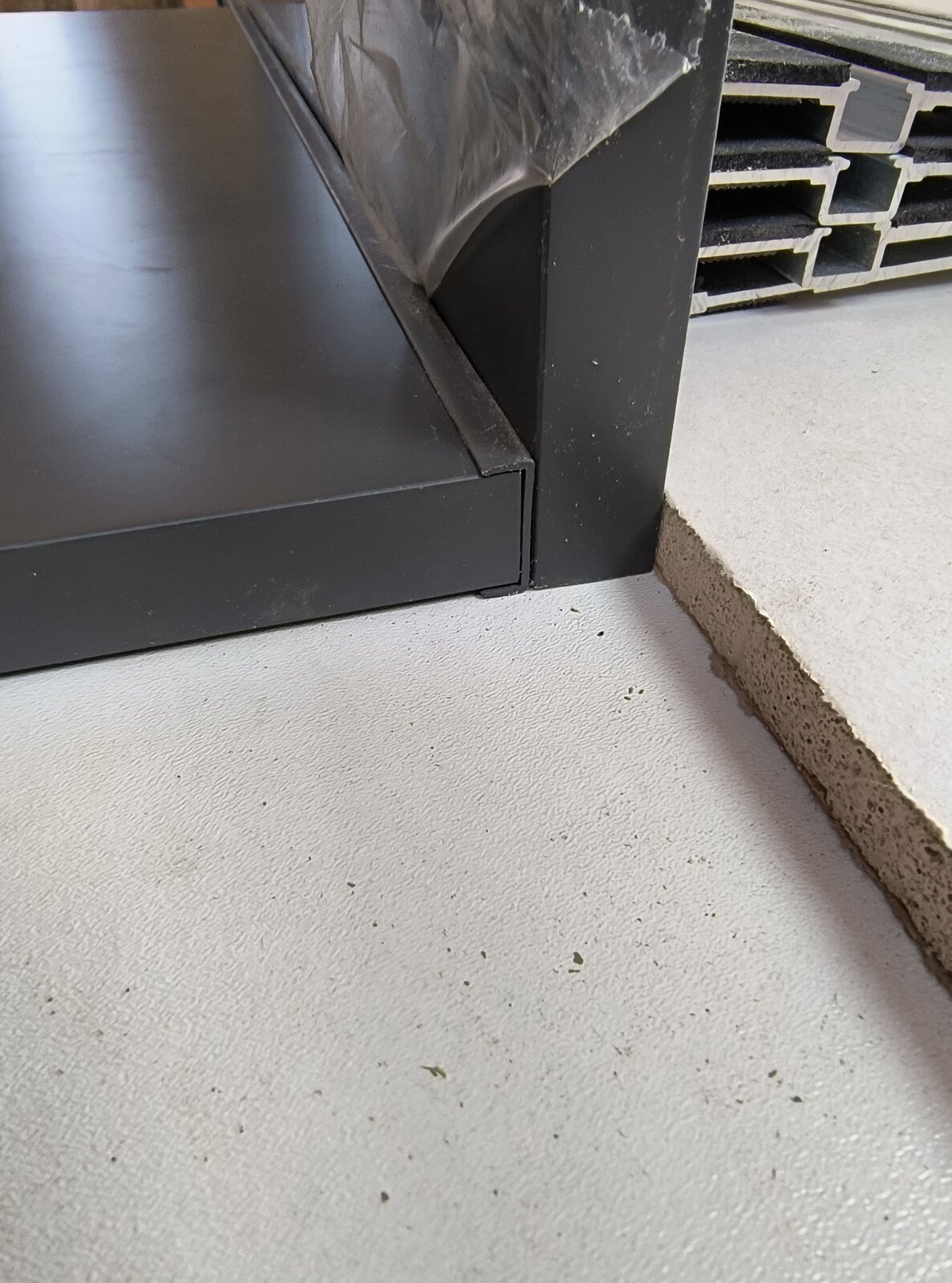

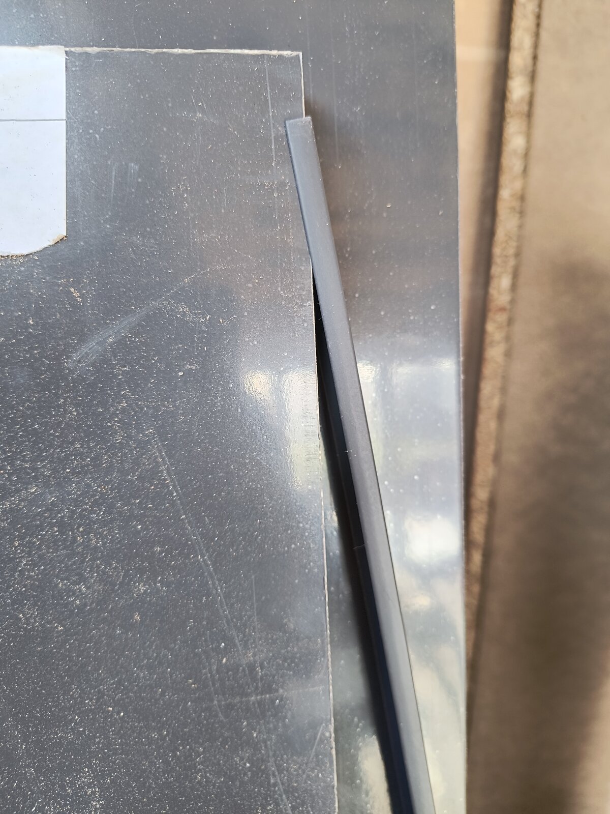

The only other thing, I suppose you could call it a "get out of jail free" card, is that the boards come with some trim sections which actually look pretty good on the visible internal cuts and hide a multitude of sins!
I know it's a cheat but I don't think it's that bad as a detail.

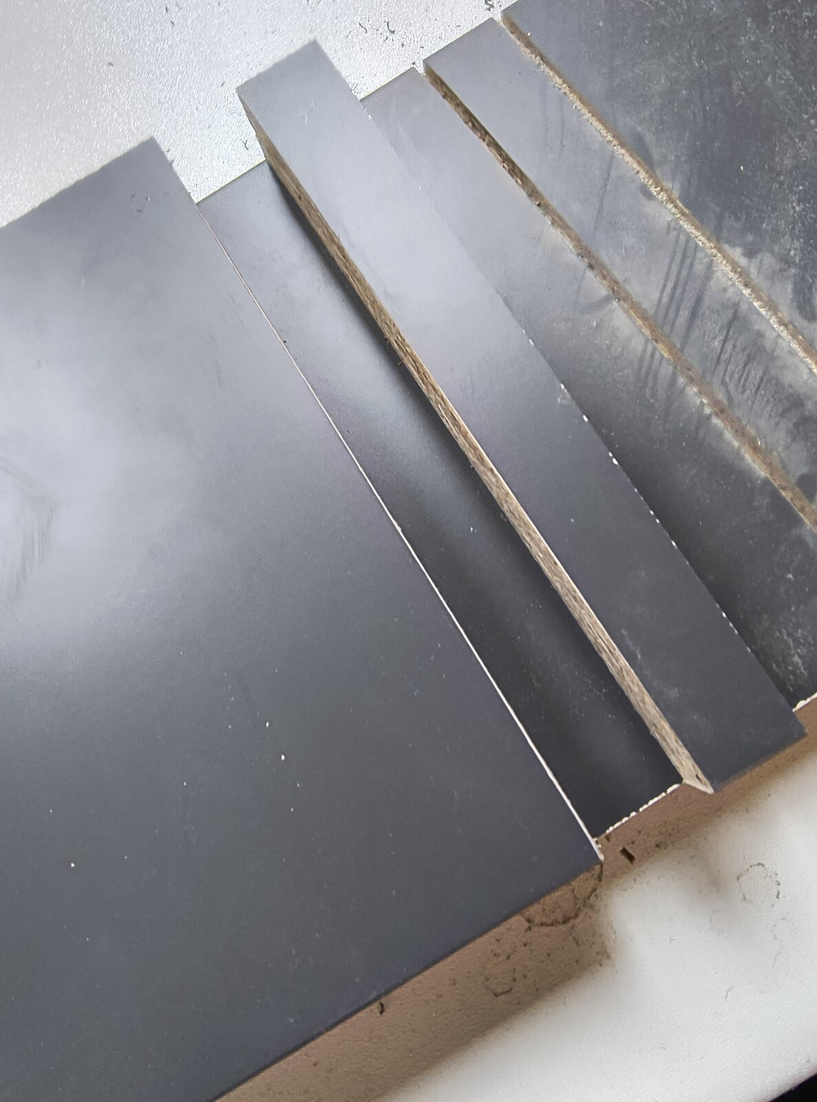

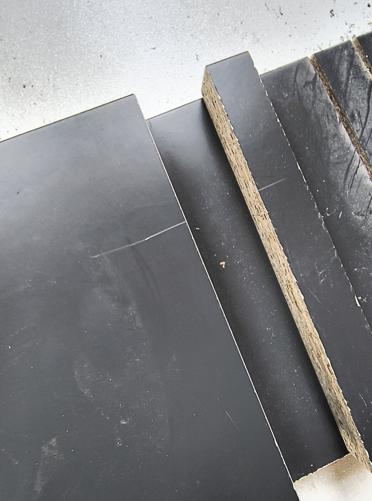

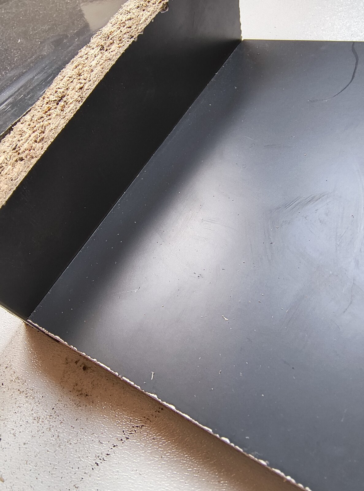

Today's attempt, the new blade, score and then full pass, second piece underneath, gentle sand down afterwards.
Top of cut:
Underneath of cut:
Top of cut butted against a panel:
So a pretty big improvement, it didn't help that I've run out of offcuts to practice on so it was a small piece and the track wasn't completely stable and the hoover hose got caught, that's my excuse anyway.
As I understand it this will be the inside of the cabinet and at the back so I think you are there with it, you could always run a very thin beed of black silicone down the corner after its built if there are any chips still showing. Same with the outside edge if it shows run a fine bead of silicone at the unit and wall junction.

do you have the blade only 2mm sticking out the bottom??
another option a bit off [sacrificial board]sheet material say 6mm mdf under the cut line preferably the full board your cutting or more then move the work to a bit un-grooved for the next cut you should get zero chipping then but the undercut chipping is shocking with the new blade
I blame the material here now I think.
Try cutting something else that is laminated.
thats exactly my thoughts so was hoping it was a setup or operational error otherwise mass or premature delamination may happen during assembly or in use ??
I think you're right!
Just tried something else, no scoring or material underneath and it's near perfect on both sides.
Must just be very brittle laminate, no indication that it's delaminating.
Anyway, it's good enough for the job at the price.
