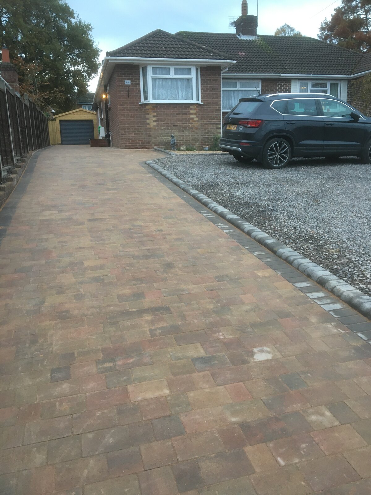

I am not sure a diy system would work for me as my drive is on a slope. Nice and level side to side but no where near flat.

By the way, does doing tracking on a very slight incline such as a driveway really effect a tracking job that much?
Can't see it affecting the toe readings.
For camber I set my angle finder across the strut towers to account for ground not being perfectly level before measuring.
My driveway slopes up and down
That's more of a slope than I thought. If you put (say) a football at the top would it roll down by itself? IF so, I agree with Keith, not likely to hugely affect toe readings, but not ideal. Will the car (or at least the front half of it) fit on the flat bit next to the house at the top?
Okay, just measured it and its about 1 in 12. The car would fit on the almost flat bit but wouldn't leave much room to get past or work from underneath along the sides. A football would roll down on its own no bother!
Personally, I probably wouldn't, in that case. Most cars have pretty squidgy rubber bushes in their suspension systems, so on a slope, the wheels might not adopt precisely the same angle as they would on the level. Assuming that (like almost all cars) the handbrake works on the rear wheels, this effect should be absolutely miniscule on your front wheels, so if you wanted to give it a go, you'd get a pretty close figure, I think. However, for a "pukka" reading, it's best done on the level with the car having rolled forwards to a gentle stop in the position where the measurements are to be taken.
