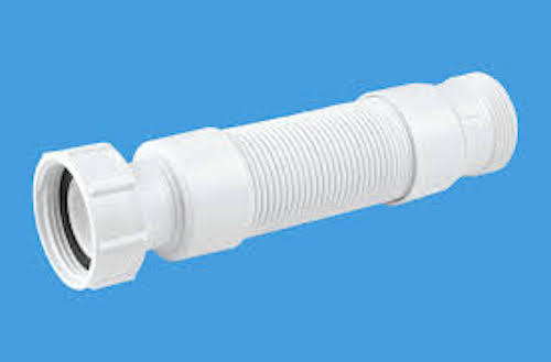

Mcalpine do a waterless shallow trap

Wirquin do one too

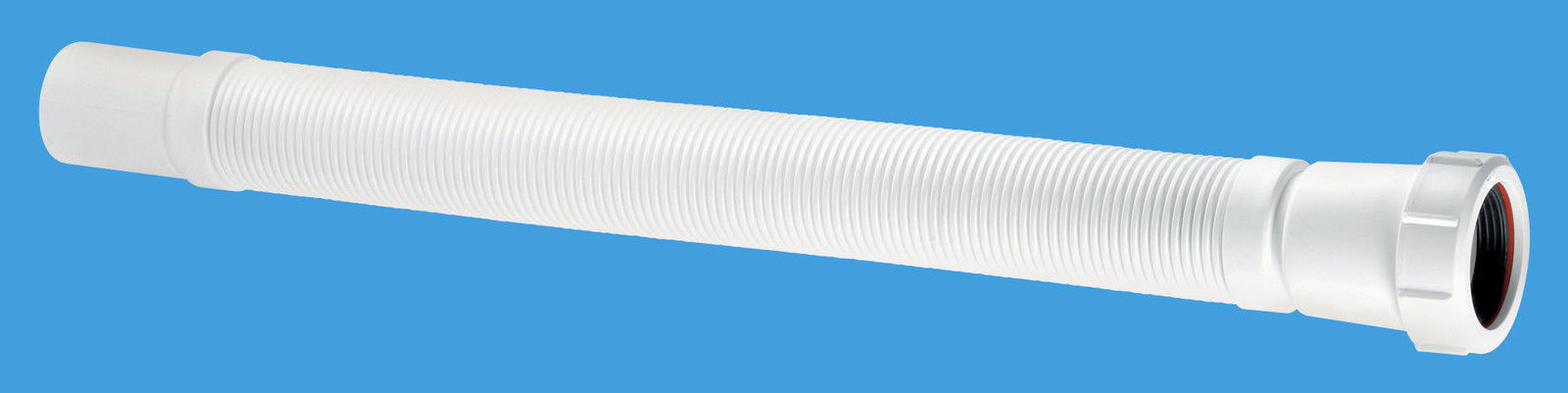

thanks! Unfortunately I think the top one is slightly too long and the bottom one looks hard to get hold of where i am. If I got a flexible waste (not one with a built in trap system such as the bottom) would it work if I bent it into my own shallow u bend?

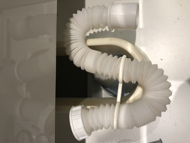

Hi all - apologies for the late reply, my wife has unfortunately been unwell and in hospital. I’ve attached a photo of what was there - I basically had to remove it to move the sink for retiling and putting it back in has just turn the thread - the plastic is so thin and cheap. I’m guessing they used this because nothing else fit but hoping there’s another option.

thanks for the reply and sorry for my late response. The problem I’m having with that is the shortest waterless trap I can find is the mcalpine one he posted which is still slightly too long. Im now seeing why maybe they used a flexible waste pipe and made their own ubend (like I posted). Is that advisable?

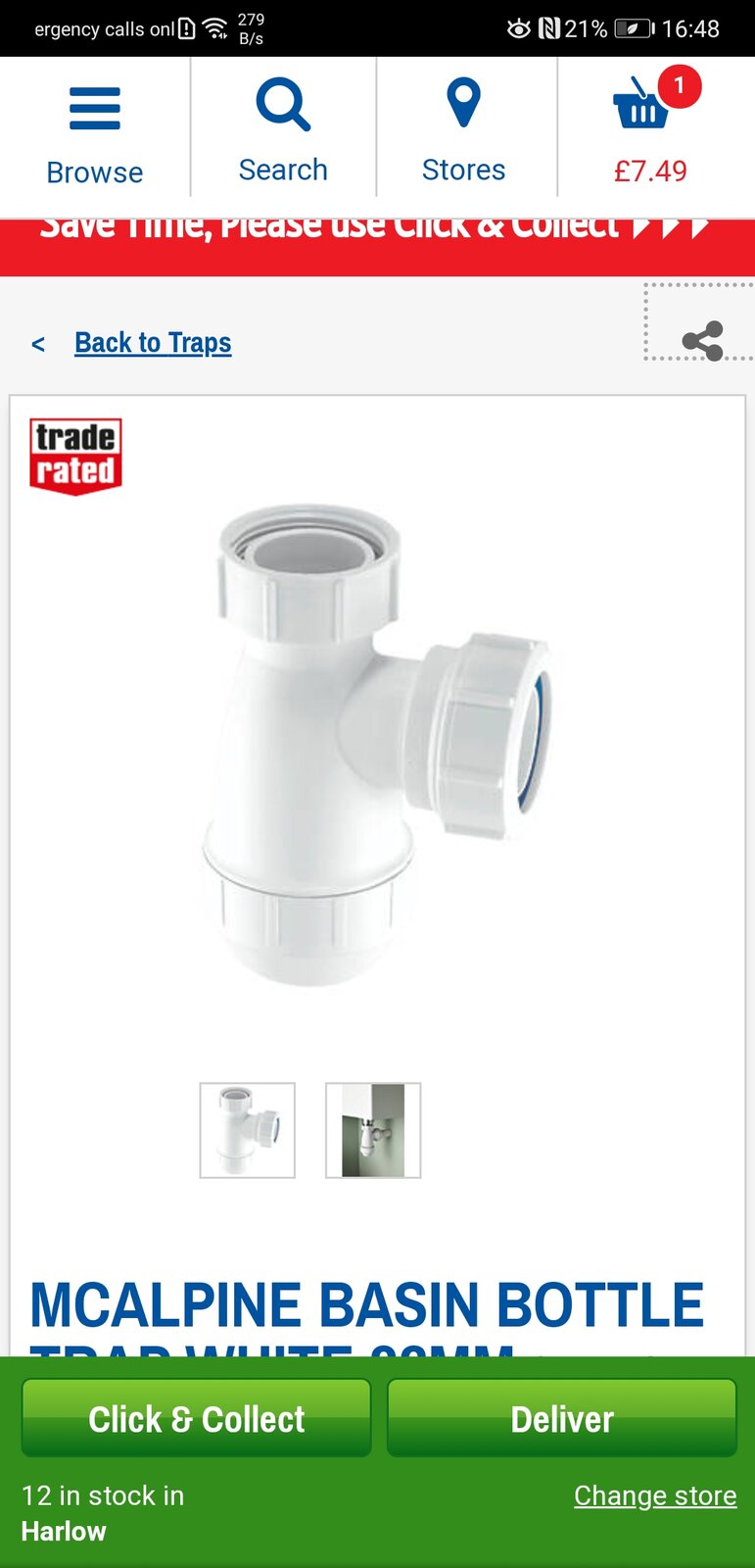

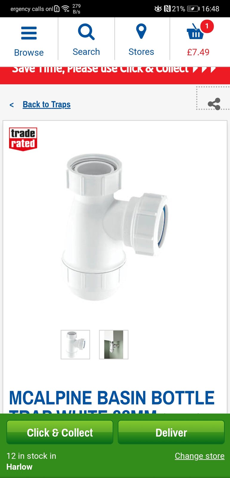

How about this. View attachment 200613
It's a very small trap
Thanks but unfortunately that's the first one I bougth and it's about 10mm too long. Currently still my best option but involves me cutting into the drawer which is a bit annoying as its plastic so will never look neat
But the thing he's replacing isn't a trap either. It's one of those bent in an S shape...
Yes, and the OP has already said he could do the same thing again. I think he is looking for a better solution.
