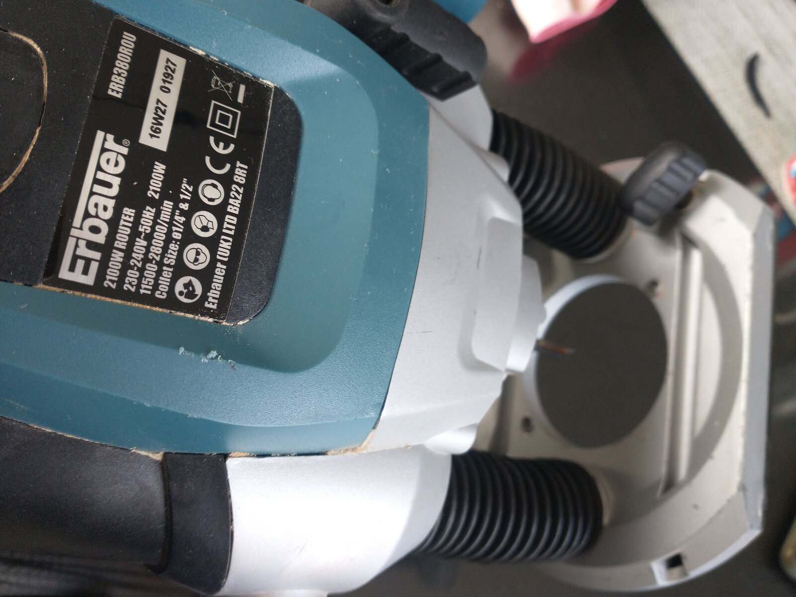

I have a trend router table and a erbauer router which won't fit.
Anyone know if I can adjust it anyway to make it fit.

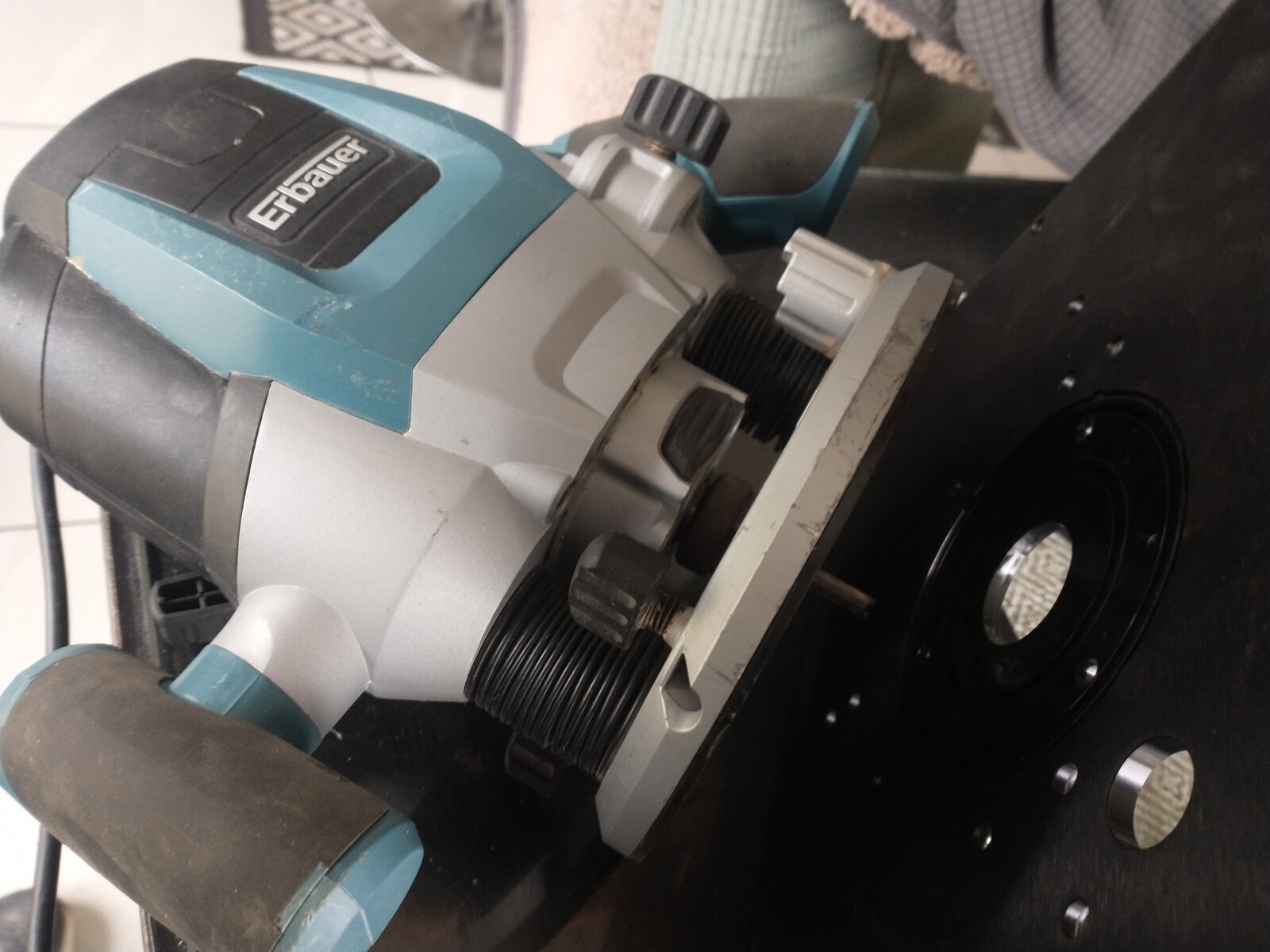

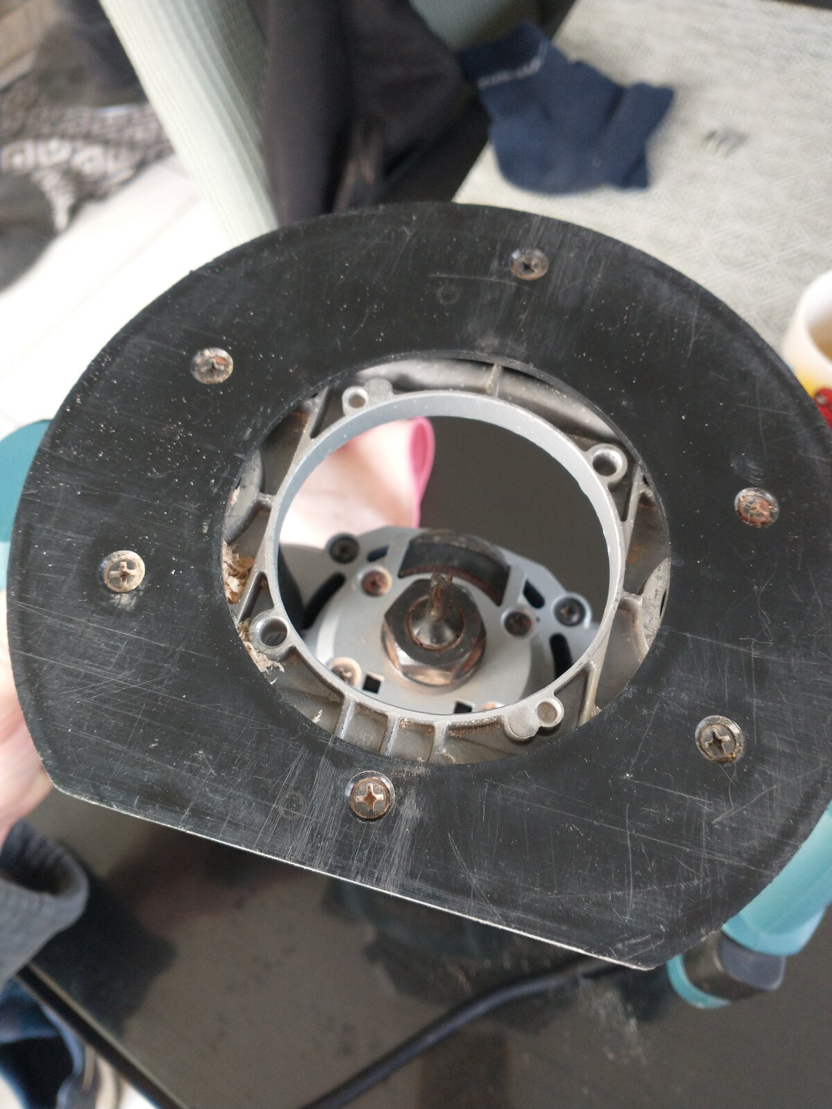

If I drill holes in this to accommodate my own router, what about adjusting it up and down. Will this still be easy enough to do
So is it a case of trying to line this up centre as best as possible and drill new holes through the router base and through the plate countersunk and good to go.
What if it's slightly of center by a slight of a mm, will this matter?

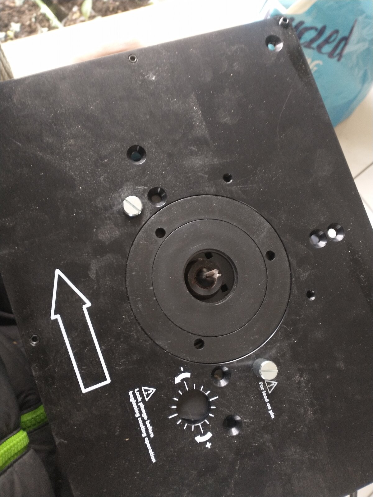

Don’t the three holes on outer ring match screw positions on router?
No, not on this router. Maybe that's where it attaches on another type router but not this. I was hoping it would though.
Should I use these holes?
Would be good to use one and drill out for other two ,( they fit on my router, Erbauer)
It does not clip to table you use the three screw positions on the base of router to screw it on.
Did you attach a erbauer to the same table as mine. All the holes don't match us or even one hole if I use it and drill another two, it'll be of center.

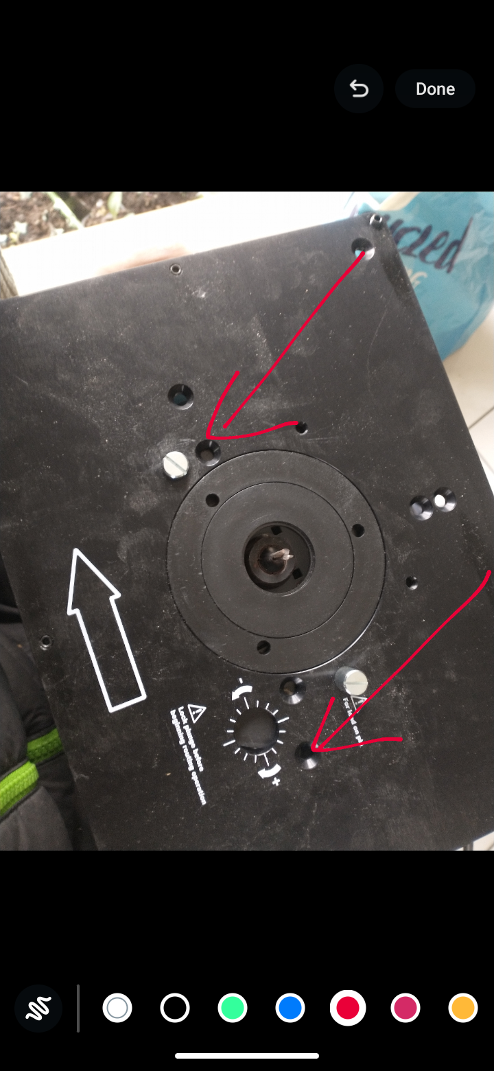

Was thinking of drilling holes through my router and using these holes where arrows are for screwing through.
