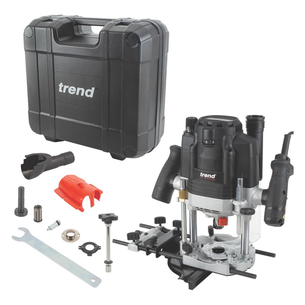

Yeah I'll be upgrading in the future to a trend router that is compatible with this table but for now I want to find a way of mounting this router I have just for this project although I'm thinking of just bitting the bullet and buy a new router now. I was thinking of the T8ek which is ideal for this table.

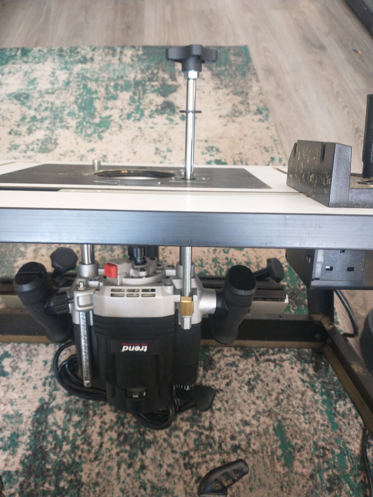

Just a follow up on this thread. I got the new router although just something that concerns me. Am I doing something wrong..
Router screwed onto table. When I turn the part to lift it, it's very tight but when I loosen it, it's easy enough. I'm afraid to twist this part to much Incase I break something. Any tips on how to use it.
Obviously make sure the plunge clamp is loosened off. I have a bit of grease on my threaded bit, and I do tend to wind mine up and down with a socket in a cordless for the large adjustments (just be careful not to wind it off the end!!). It should be pretty easy both ways unless something is distorted
It's a brand new table and router. I have the clamp loosened off but still it's very tight to wind up. Feels like it'll break if I keep forcing it.
Any videos of yours winding up and down a d how you've it set underneath
Take it out the table and see if it is the same. Sorry, no vid at the moment. It really should be about the same both ways. The brass nut should spin easily on the thread bar -
