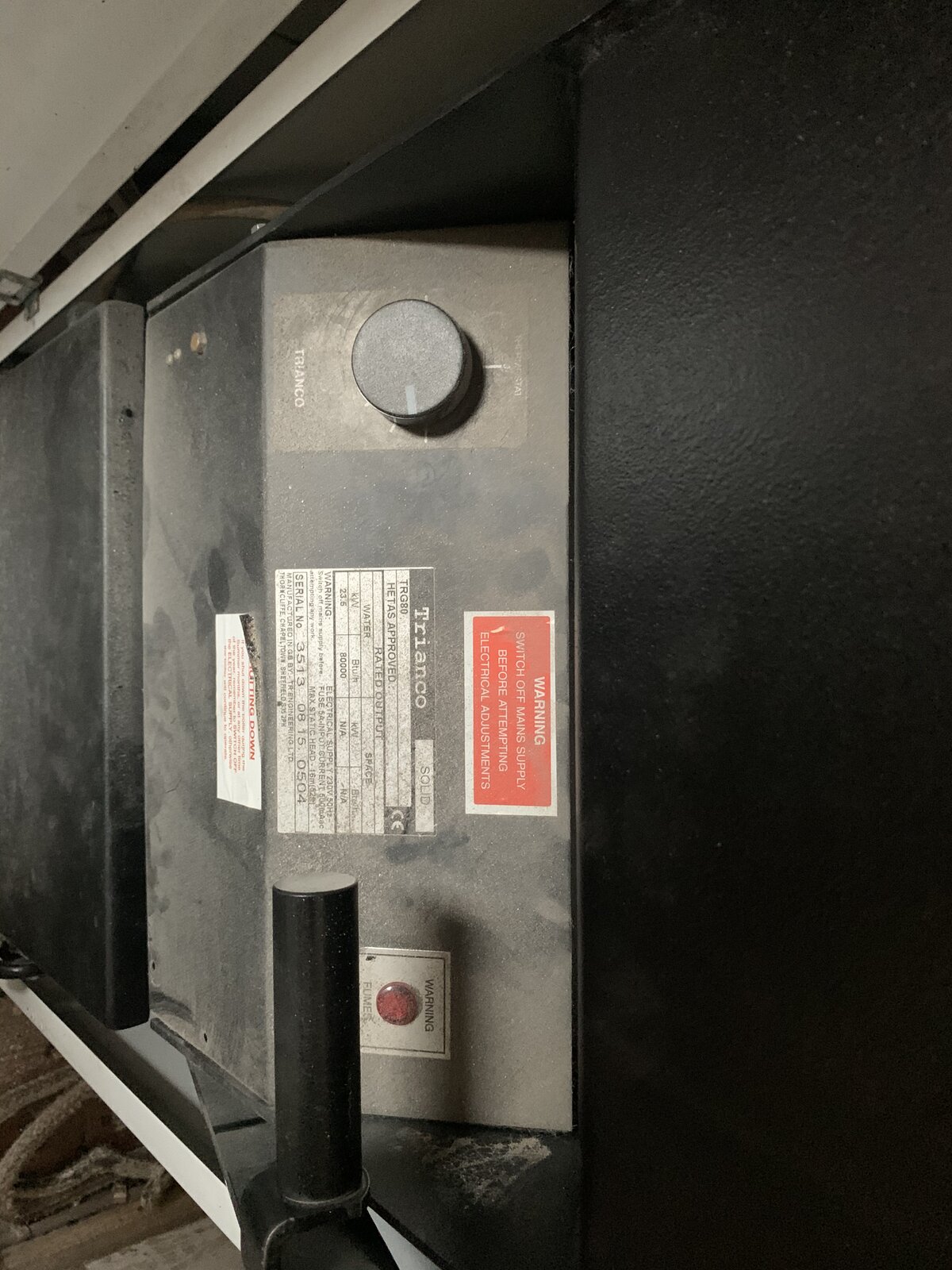

Also what would you regard as the best setting for the dial on the door in the picture as I’ve been given different information

Please please please help . We have had an ongoing situation with our heating for a while now and different solutions are now making any difference . I’ll try to explain as best I can .
We load our trianco boiler with anthrosite every night . The problem we have is that we have to leave the heating on constant , this is because every time we put it on timer and the central heating goes off for a while the water in the tank gets roasting hot and bubbles and bangs fairly loud to the point where it starts piling out the overflow pipe . We’ve put new seals on the doors to the boiler ( no difference ) . We’ve had a new towel rail fitted to act as an extra heat source which I’m told is the first in line ( no difference ) .
We really are at our wits end as not only costing us plenty in coal/anthrosite , the house is getting far too warm . Don’t know what else to do now . Please someone help
Sounds like your air supply flap is open too wide open your fan door look over the top of your fan you will see two screws the nearest one to you turn anti clock one turn if this is too much and boiler goes out turn clock
