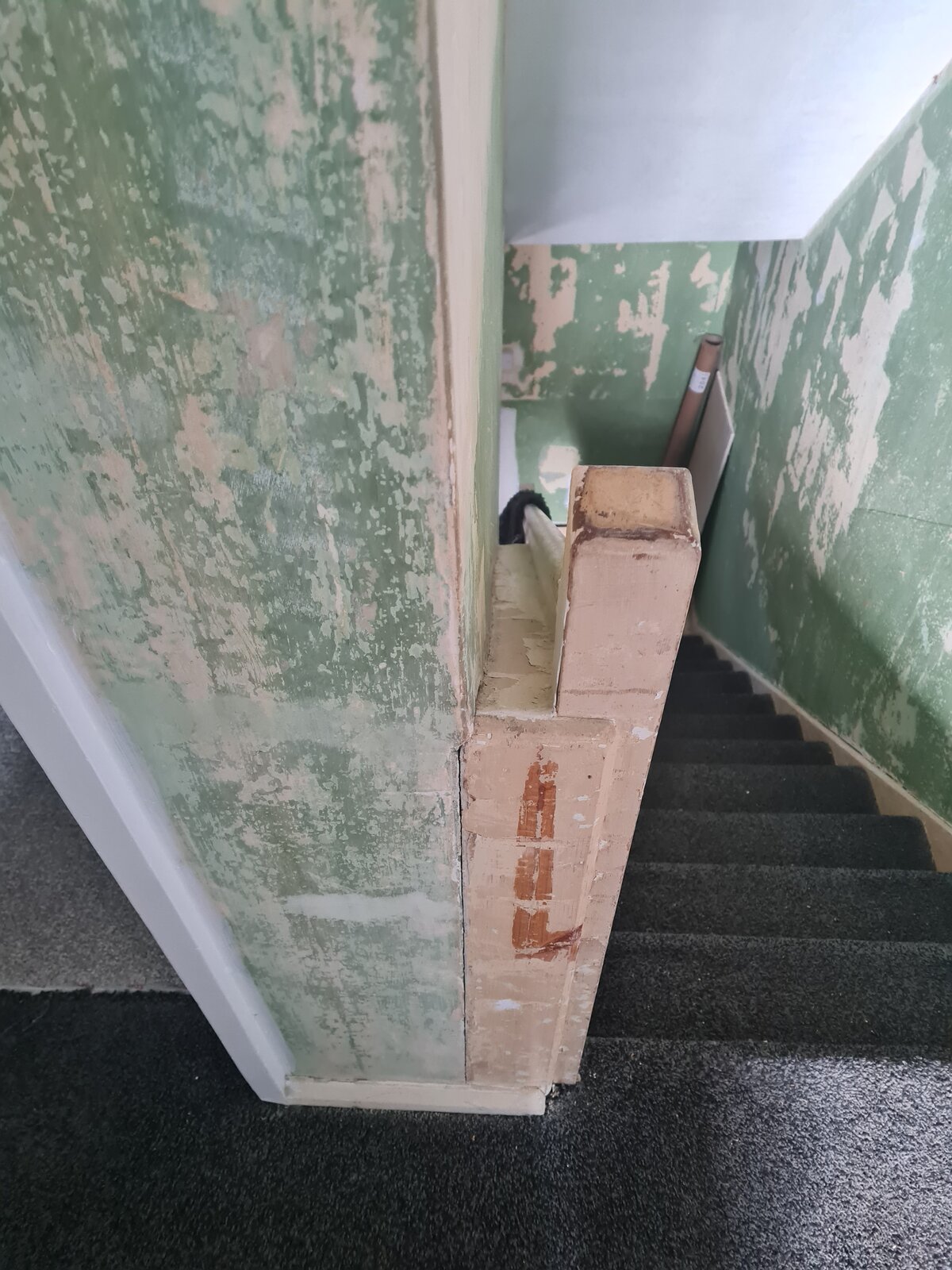

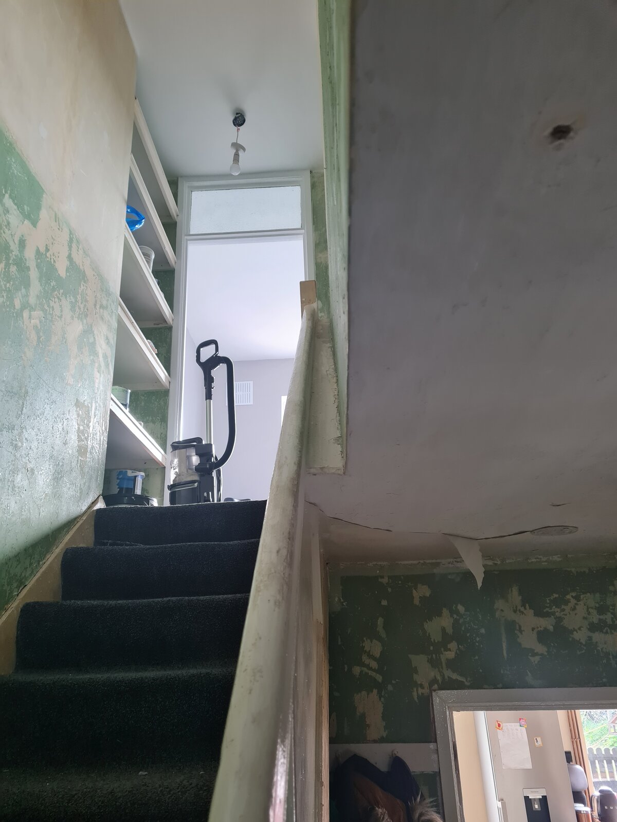

I am looking at replacing my bannister/newells and making the side glass instead of wood.
However there is this triangle wooden bit at the top (between top of stairs and wall) that I am unsure whether it is safe to just remove. I am wary of even removing any of it to look inside. It does sound hollow when banged though.....
Could anyone please advise?
Pics are of the triangle bit from top and bottom of stairs.

I would just leave that bit as it is after making it look nice and start the glass after it. You may find inside its a load of nogging/s ugly supports that you can not remove easily.
I thought maybe leave it but because of the angle the glass panels would leave a weird space near the top...
Hoping I can get this one....without the top straight section
I cant quite tell the shape of the section from that angle in the picture of your stairs.
I'll take off that top panel at the weekend and have a peek. I'll update as I go.
Thanks. I'm a bit of a diy chicken after I screwed through a gas pipe laying floorboards!!

So I pulled off the end panel and it was totally empty inside so that's one hassle sorted.
Unfortunately I then realised the string isn't wide enough for the grooved base rail so I am going with a different plan which saves me all kinds of headaches.
