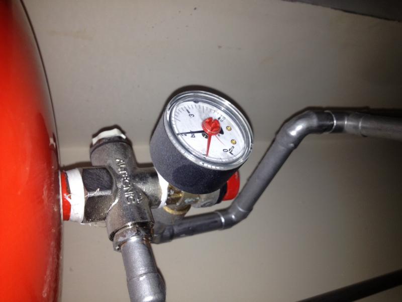

Hi guys
I live in a 2 year old property with a Tribune HE boiler. The builder explained that it was a 3.5 bar system and it would have no problem running the showers on the ground and top floor.
The top floor shower is fine, however the ground floor shower is a bit of a trickle (warm though, so hot water is getting through). A quick call to my Dad (standard procedure, lol) and he advised it was the pressure.

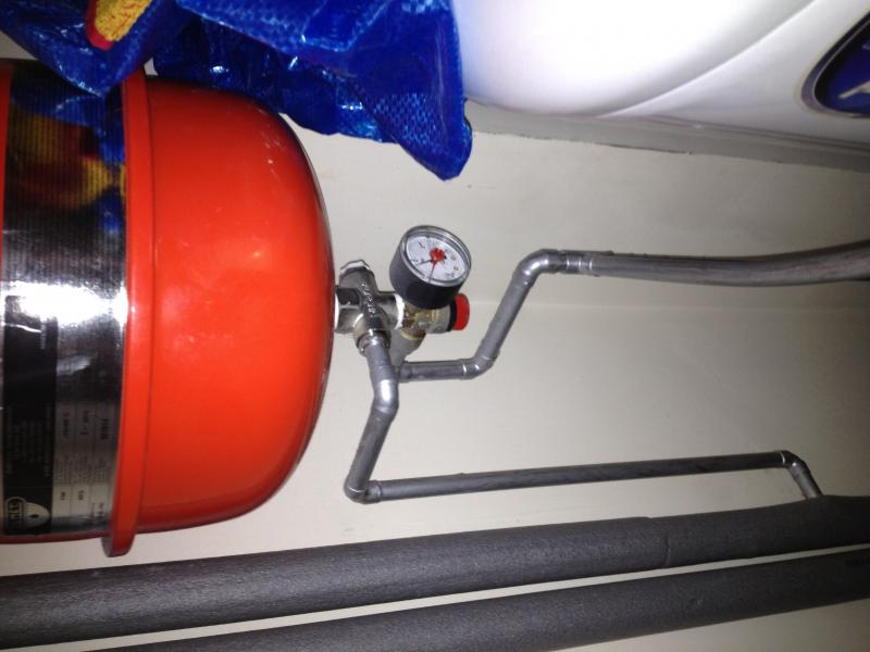

I checked the boiler and there are 2 needles - a red one reading 1 and a black 1 reading just under 2, from which I deduce that my system is running at just under 2 bar (not 3.5 as per the builders comments). :confused:
How can I increase the pressure? I've attached some photos and would really appreciate some advice on this :)
Your dad has got it wrong (as dads sometimes do) the top shower would be affected if there was a problem with the pressure, its more likely to be blocked filters in the shower,
The gauge your looking at is to do with the pressure in the boiler/pipework and nothing to do with the pressure of the hot water/showers ect.

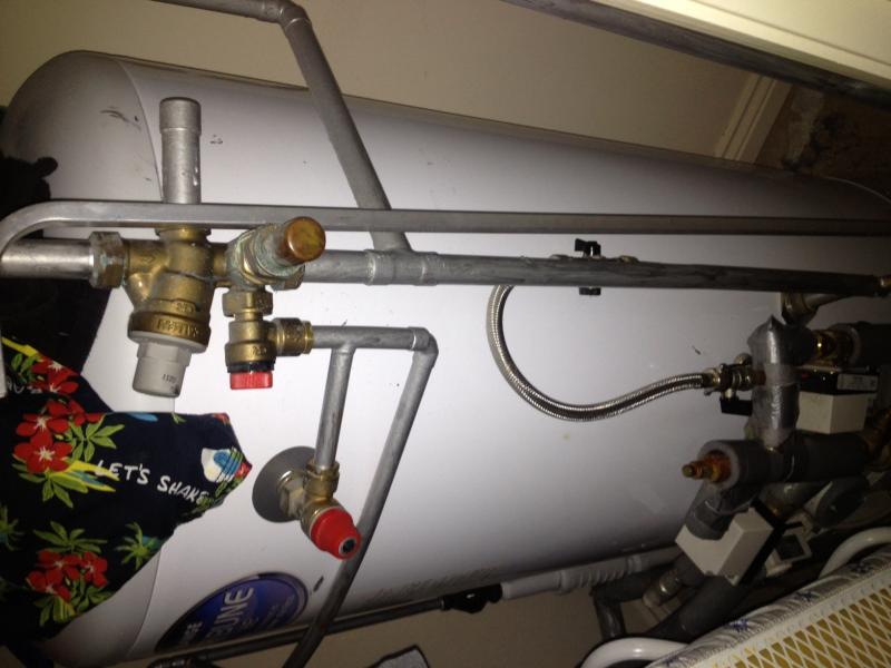

Picassos right, you need to understand the different types of pressure. You have a boiler on the wall that heats the radiators, and the Tribune hot water tank that runs from the mains water and gets heated by the boiler. The pressure gauges you are looking at are for the central heating pressure and have nothing to do with the flow of water to the showers. When the builder quoted you 3.5 bar pressure, we don't know whether he was referring to the maximum pressure that the central heating can run at (as controlled by the small red tank), or whether he'd checked the pressure of the incoming mains.
Picasso is right when he points out that if the upstairs shower works fine, then the overall system is okay, so you need to check out the downstairs plumbing, but it's unlikely to be a shower head problem if it's down to a trickle; this implies a more serious problem. Has someone done any plumbing work recently, and forgotten to turn the isolation valves back on. Is it a thermostatic shower downstairs, as the thermostat could have become faulty, although unlikely.

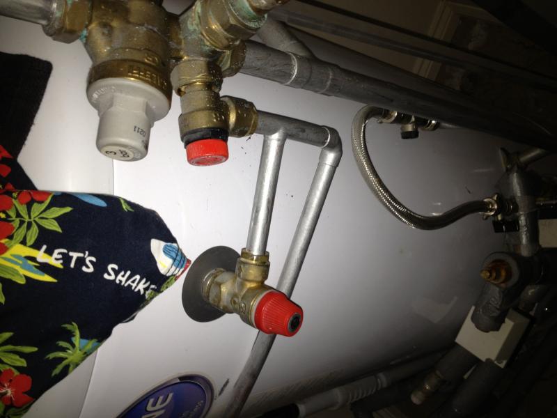

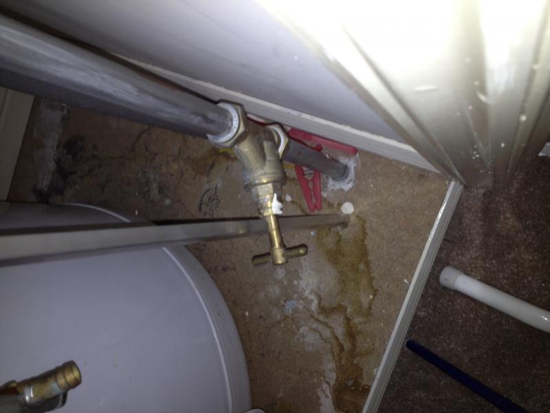

Shower aside, is there no way of resetting or repressuring the boiler? There are red plastic caps that when pushed appear to release some water somewhere, but they are not labelled. See below - there is also a brass tap which again I am not sure of what it does.

Put the two black handles back in the position you found them, this opens the waterway that repressurises the boiler, when you get to 1 bar close them, when the handles are across the pipe its closed.
Ignore the fricking boiler.
You have a blocked filter somewhere.
Maybe a guffed pressure reducing valve.
