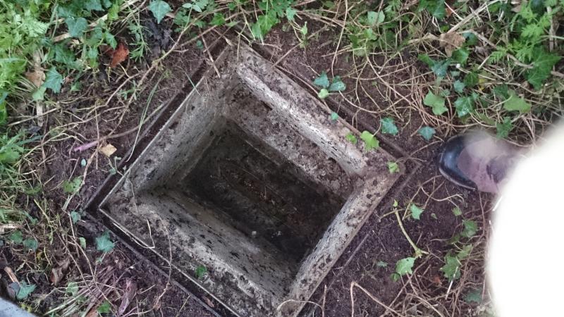

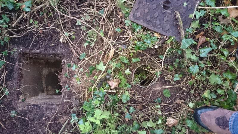

So for your viewing pleasure - an Irish Septic tank, circa 1974.
Access drain about a meter or two from the tank.
The tank itself with ventilation.
