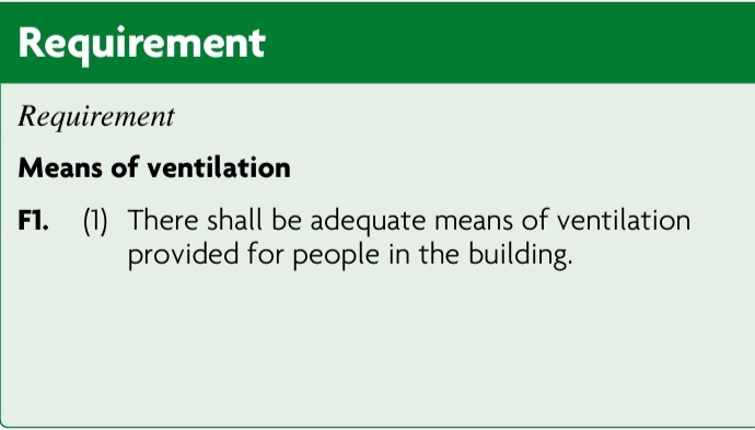

Mandatory is also a strong word, when all the actual law states is...
How you meet that requirement is up to you, although the closer you stick to the 'Guidance', the easier the journey you have with building control!
