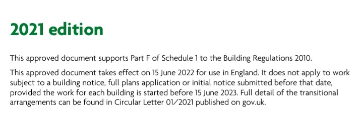

Be sure your quoting the new June 2022 regs, as I understood it there's no if's, but's or maybe's as there was with the previous ruling
Yes, 2021 edition, coming into effect June 15th 2022...

According to the window company im buying from the new regs came in a year ago.

They could be, nevertheless if the new room(s) are habitable then adequate background ventilation must be provided, be that from existing vents, new trickle vents or other mechanical ventilation, probably 99% of the time that will mean trickle vents. But all a moot point as the OP is unbothered by it all.
