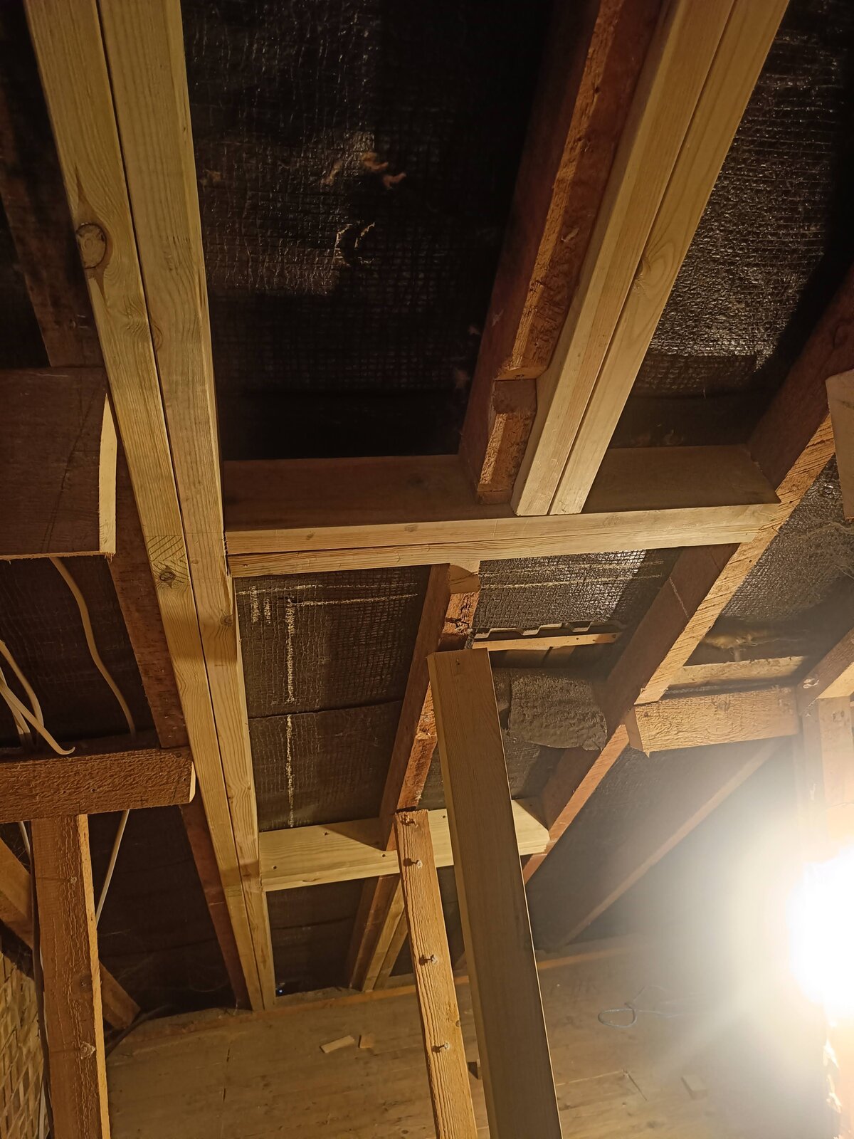

One other question that popped into my head on all this. I've included a couple of photos of where I am at with this so far.
You will see the horizontal trimmers installed that I will now move in light of this discussion.
In terms of the rafters you will see from the white line I have added to the left of the second image indicates that the window width (and Velux recommended gap) will be narrower than the rafter gap by approx 50mm. Am I correct in thinking that I don't need install an additional rafter timber to meet this measurement - it would just sit on the horizontal battens? My understanding is that the battens take the contact of the window - therefore the window could sit anywhere between the 2 rafters? (note that the right hand side rafter is yet to be doubled up)
