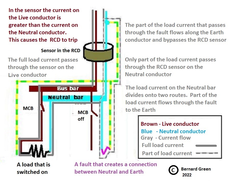

This is why an RCD will trip on an Neutral to Earth fault when the faulty circuit is not switched on but something else is taking current.
Would the above do it without load?? The immersion wasn’t being used and also isolated by a circuit breaker inside the appliance??
