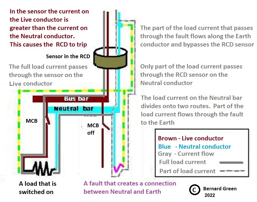

Some ( inexperienced ) electricians cannot see how a Neutral to Earth fault can trip an RCD when the MCB for that ciruit is switched OFF. They believe that because the Earth wire is connected to the incoming Neutral at the main fuse there cannot be a voltage difference between Neutral and Earth. Without that voltage difference they believe there cannot be a current through the fault to trip the RCD
One such electrician who was shown this diagram admitted that his training in fault finding had not covered this matter,
They may also believe that
"Current takes the path of least resistance",
which is not so.
Current flows in all available paths, in proportion to the "Conductance" of each "path",
which is the inverse of their "Resistance".
Hence, if there are parallel Earth and Neutral "paths" - of equal Conductance/Resistance -
the Neutral "path" will carry half the Current of that in the Line "path",
which will be detected by the RCD/RCBO as an imbalance of Current, between the Line and the Neutral.
