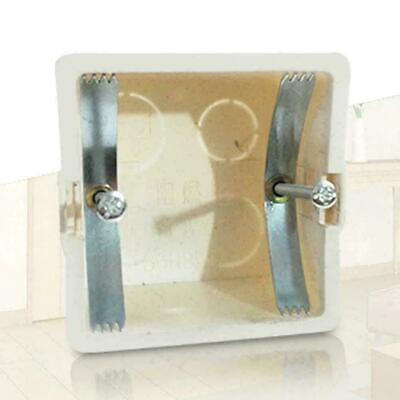

I need to fix a metal back box
Both the threads have gone on the screws
When I screw a new screw in, that screw loses its thread
I got some metal bits to fix the problem
But I can't figure out how to use! I think I got them from Screwfix - can't remember
See below
As it is, I can't push into the metal back box
I have to bend loooads and even then, it's really fiddly
Does anyone know the correct way to use?
I thought I'd ask before buying other fixing bits that look a lot easier to use
ELSE: what would be the best way of solving the screws losing their thread?
Thanks.

You can buy a bigger thread tool and bigger screw.
Standard m3 size but you can make it a m4 with m4 screws
Or just replace back box. Easy job tbh. Wedge in position.
I just set new box in toupret filler. Dries in 12 hours

@Wayners thanks. I think it might be easier to get one of the little bits to fix the backbox
Being lazy and tight - looking for the easiest and cheapest way
That thread tool cost £9 - I'll never use again!
Cheap tools available. I picked the Pro branded one.
BGS 1900-M4X0.7-B | Tap Set | Starter & Plug Tap | M4 x 0.7 mm | 2 pcs. https://amzn.eu/d/34EScpk
£3.31
Just need 2 screw.
Probably best find hardware store.
Normally get tool for £2.99 then pack off screws off the packet rack. Job done.

Not sure what you have will work?
Just looked those up and they are used for surface mounted plastic boxes.
Can be used on other plastic boxes. I guess those teeth dig in the plastic.
