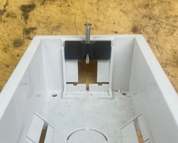

However, there is a problem (I suspect an insuperable one) which one rarely sees discussed. What if it is a plastic switch with a plastic ('plasterboard') back box? With many of the designs of such box, the screw protrudes out of the back of the bush into which it screws (see pic below) - and, since that screw (the head of which is touchable) could come in contact with a live conductor which had come astray, it surely still qualifies as an exposed-c-p, hence required (by BS7671) to be earthed....
... but how on earth (sorry :) ) could one earth that exposed-c-p? ... and if one wouldn't/couldn't earth it when the back box was plastic, why does it become 'more necessary' if the back box is metal?

How on earth indeed, but we are not talking about plastic on plastic because although they are exposed in the sense argued, they are not conductive
No, but unless one uses nylon ones, the screws are conductive and are exposed-c-ps - and so, per BS7671 ought to be earthed - even if I can't think of any easy way in which one could achieve that!
This reinforces what I've been saying - that what (if anything) needs to be earthed it is the ('exposed' and 'touchable') screws, not the back box (whatever material it is made of).

That is simply remedied by clipping on the plastic screw caps that are supplied with sockets.
As I wrote ....
.... Plastic caps/covers over the screws might be considered adequate to address this theoretical issue ....
... and if you are one of those who believes that they are adequate (to prevent the screws heads being exposed-c-ps which need to be earthed) in the case of a plastic back box, then, if you are consistent, you will presumably also believe that they adequate (as an alternative to leaving the screw heads exposed and earthing the back box) when the back box was metal, won't you?
