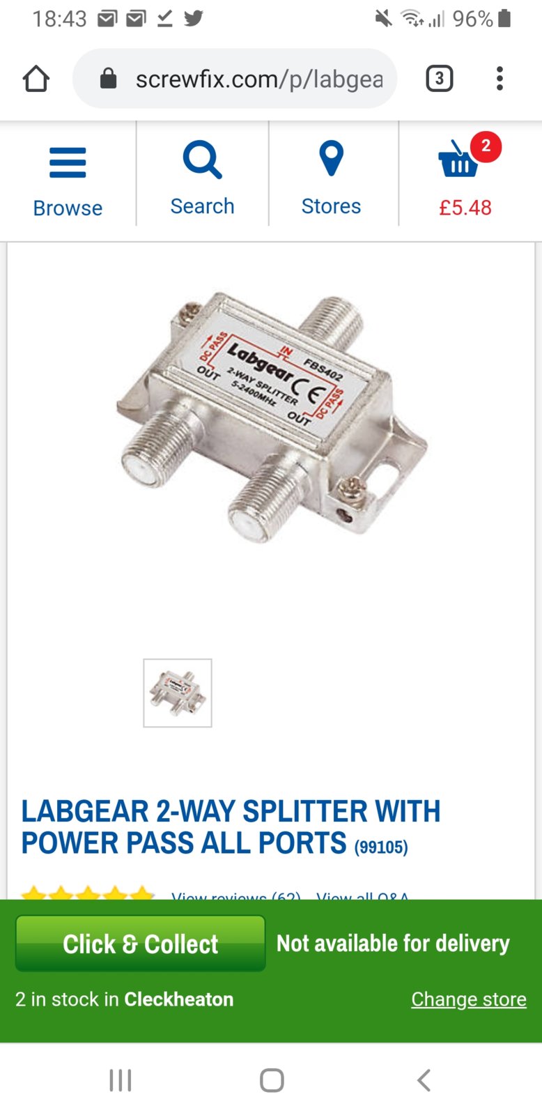

Now I want to split the freesat output from the triax out to the dining room using rg6 round the outside of the house , which was easy enough using a labgear 2 way splitter
Using It to get the picture from the triax then connecting upstairs to out and dining room to out, but theres no 9v signal to power with magic eye , when I put the dining room line to in and the triax to out I get the signal and 9v to power the magic eye but that just leaves me a none powered out to go upstairs ,is there a splitter that will accept the triax picture and run 9v up either leg to accept the magic eyes.
Nick
The clue why you're getting no DC 9V through the splitter is in the red arrows. The DC pass is not in the direction of the signal. It's in the opposite direction. Think of it like a one way street for DC. The power moves in the direction of the arrows.
I don't think you're going to find a passive 2-way splitter that also splits the power to both legs in the direction of the signal. The reason is that sharing 9V to two outputs means that each gets 4.5V and that's not enough to power the magic eyes on each leg. What you'll need is an amplified splitter with power pass. This powers each of the outgoing legs from its own transformer, but also passed the Sky Eye signals back to your Tri-Link so you can change the channels from any TV location with an eye. Something like this Labgear will do the trick: https://www.amazon.co.uk/Labgear-LDL204-Amplifier-Separate-Inputs/dp/B00J623OBU
