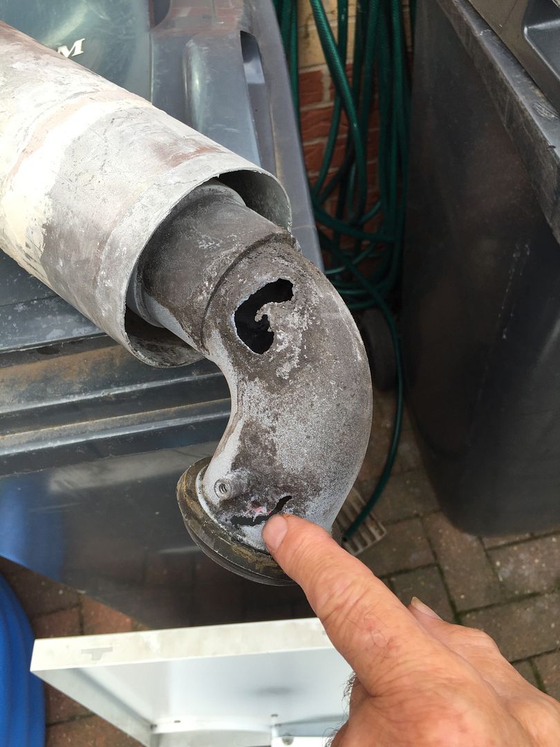

Thread update - I like to keep things current so other people searching threads for advice can find some. Not that everyone here would appreciate that.
So I had someone out to have a look, it was diagnosed as a holed flue pipe, unfortunatly these are aluminium on these boilers and prone to corrosion, they are also now an obsolete part,
This is my flue
So I've had my boiler replaced, thanks for all the advice given. I'm sorry if anyone felt like I was trying to 'entrap' them into giving more advice than they were comfortable with,
money spent on parts is not nessecary when you have the right tools to do the job ;) , getting a gas engineer was the only smart move you made in this circumstances and it has been proved , but glad you got it sorted thou.
