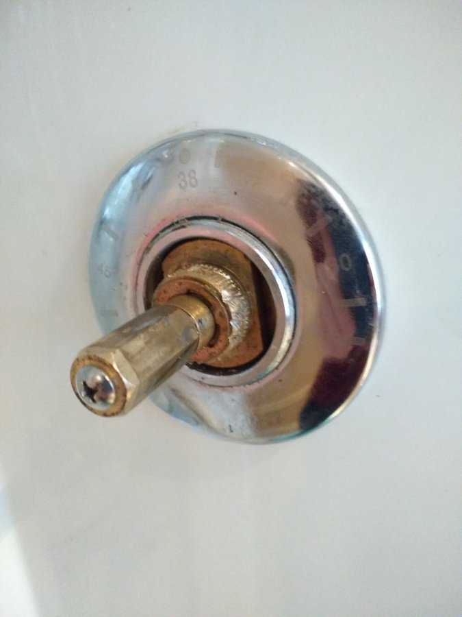

Hi - I'm new to these boards but am looking for some help please. We have a shower cabinet, not sure of the shower type but the control panel says "SaniNova by Maax". We've been in the house 2 years and the shower has been fine until recently where we now get temperature fluctuations and struggle to get a nice warm shower - the only way to get any warmth in it is to run the bathroom hot tap until that is hot (almost scalding) and then turn on the shower, but even then it tends to only be tepid, which is no fun. I've researched this a bit and reckon it could be the thermostatic cartridge. Our plumber says that the combi boiler is OK. The nice people at Showerdoc say they need to see it removed from the housing to be able to identify it, and therein lies my problem, I can't remove it.
I've removed the temperature control knob and the plastic temperature lock beneath it but am unable to remove the cartridge (turning anti-clockwise). All I'm doing is churning the brass knurled nut (see pic). I couldn't see a grub screw to remove (as mentioned for some cartridges) but there is a circlip in front of the nut - does that need removed? Showerdoc also said I need to remove the chrome plate and try to get a spanner on the two slots on the front of the cartridge as this one looks like its screwed in to the body. However, looking at it, even if I manage to unscrew the chrome plate, I don't think I can get a spanner onto the cartridge as it's recessed - unless I'm missing something. Any help/guidance would be most appreciated - the wife & kids are getting fed up with not having hot showers.

OK thanks jeff the gasman. Do you mean the chrome surround? If so, wouldn't this still leave the flats of the cartridge inside the housing so not sure how I'd get a spanner on them. Could you suggest how to do this please. I've tried by hand (anti-clockwise) but it won't shift.

Looks as if it may need a special tool.
Have you showed that photo to showerdoc?
