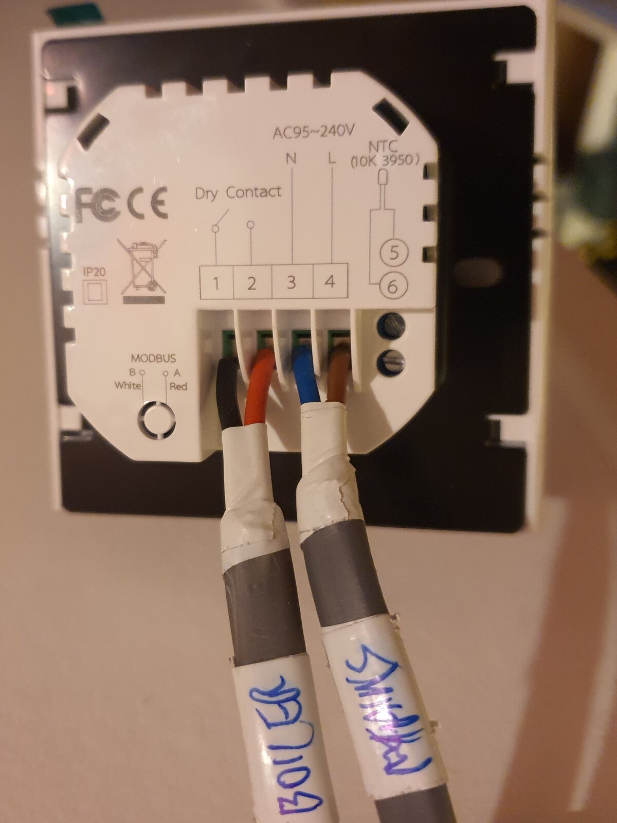

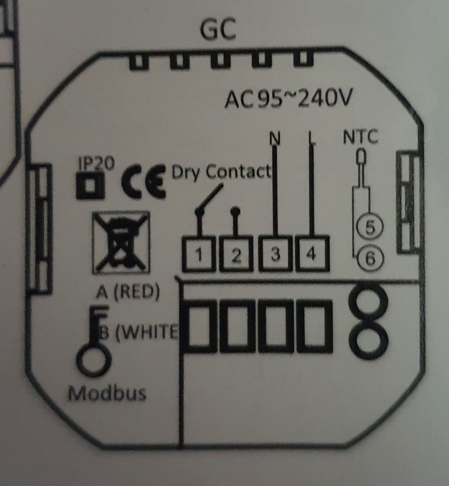

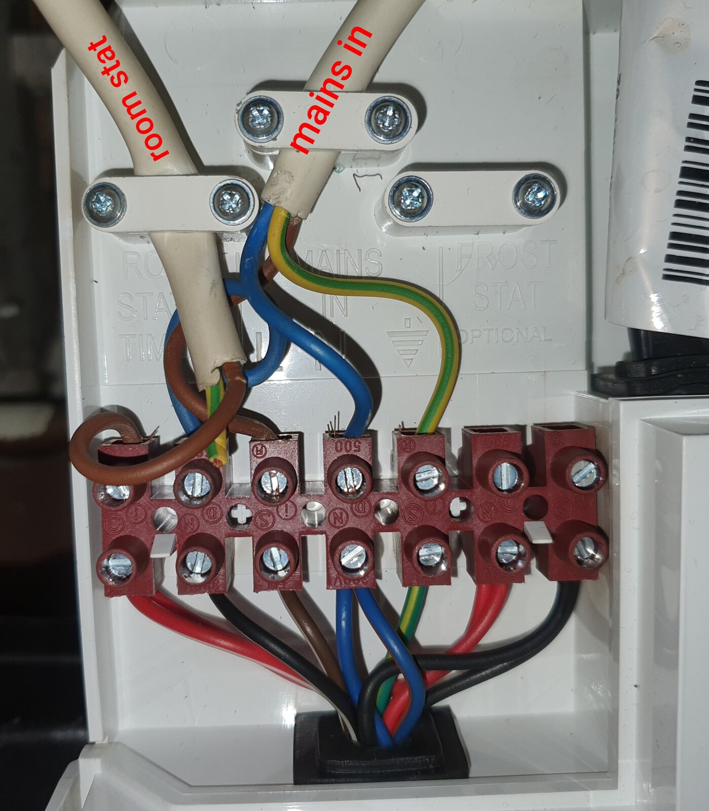

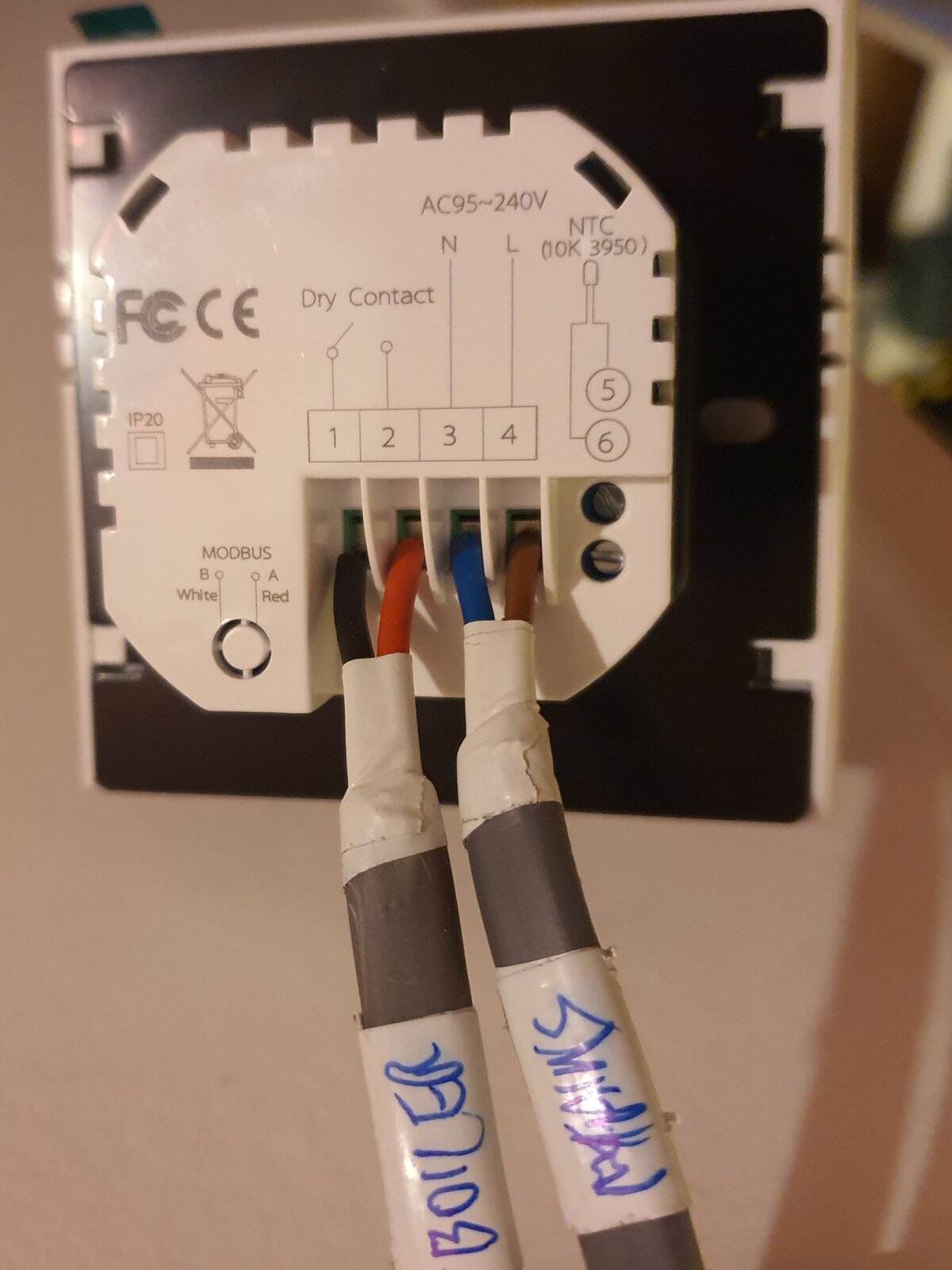

Hi there,
I'm new to the forum and am search of some help. I recently purchased a BHT-3000-GCLW smart thermostat. I own an Ideal Logic Combi 30 boiler and am trying to wire the new thermostat to said boiler. I so far have taken a twin and earth to the back of the thermostat from the spur which feeds the boiler and have wired the dry contact with a separate twin and earth to go direct to the boiler, to, hopefully, be connected to the terminals marked "room stat". Would this work and does it matter which side of the dry contact I connect to the live side of the room stat terminals within the boiler?

You should not have removed the casing from your boiler - that is for Gas Safe Registered Engineers only. It forms the safety room seal and your boiler should not be operated again until the Regulation 26.9 checks are carried out to ensure your safety. Your wiring looks OK, if a little scruffy, although it's a shame you're fitting an on/off room thermostat to an OpenTherm compatible boiler - an OT control would have made it more efficient

Thank you for your reply. First of all, I am an industrial/commercial heating engineer and although as I know that is different from a domestic heating engineer I am more than competent at removing the boiler cover and understand wholly the risks that come with it. The wiring you see in the boiler at the moment (the last picture with the white flex), was made by the guys who fitted the boiler initially, the Gas Safe Registered Engineer, and yes I agree, rather scruffy. In this picture is only the original wiring as I did not want to connect until I knew I would be doing it correctly. As for the open therm circuit, there is no connections on the right hand side where they should be, it is just blanked off! Why I don't know but hey ho, i'll just need to go with the room stat connections. What I need to know is does it matter what side of the dry contact I connect to the live?

is not permitted, and has not been allowed for any installation since 1966. That earth wire needs connecting even if the thermostat is class II, for an installation (not including portable appliances) an earth must be taken to the unit even if not used by the unit, yes I know plumbers and heating guys do flout the rules and I have even seen them use the earth wire as a live wire with tank thermostats, but that is still wrong, in the future some one may change the thermostat for one which needs and earth, and with people trying to persuade people not to inspect the wiring connections in the boiler, and a loop impedance meter is expensive so many DIY people don't have one, plus rules say earth must be provided, it is possible some one will just connect the earth wire without testing. Although 2 core cable would be wrong, at least no one would think it was earthed or bonded. The wire is there, so use it.
Yes it will work, but it will not comply with regulations or work in the most economic way.
Hi EricMark,
