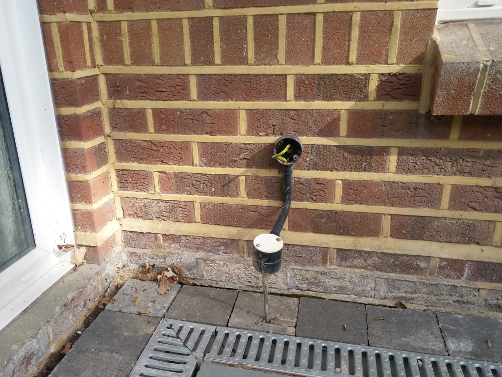

Existing is 10mm2 from rod to MET and plan was to change it to 16mm2.
As has been said, provided that none of it is buried (in earth) (which is unlikley), without protection against corrosion and mechanical damage, 10mm² is more than enough.

I will ask him why he wants to change the cable. Before I do, here is a pic of the rod. Would you say it was protected against mechanical damage and corrosion?
The figures that TTC quoted related only to buried (in the ground) earthing conductors (which yours isn't). If not buried, then the minimum for any 'protective conductor' (which is not part of a multi-core cable) is 2.5mm² if mechanically protected, otherwise 4mm² - both of which are clearly well under your 10mm².
I can but repeat that your 10mm² conductor is more than adequate.
Kind Regards, John
The cable is protected, it is inside the conduit. I would worry about damage to the rod though. I’d drive it further in so the terminal box is flat on the pavers.
