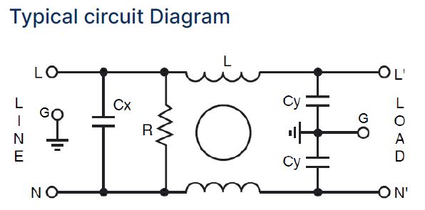

The typical circuit of an RFI/EMI filter is something like this...
The L in & L out, and the N in & N out terminals are both connected by inductors  L - they are very unlikely to fail open circuit.
If either of the capacitors on the load side pop, they are both connected to earth, hence the RCD trip.
He measures the resistance across the L and N terminals to test the filter. This won't necessarily give you an idea of the health of the capacitors - it will only let you know that the inductors and resistor R are healthy, and it would tell you if a capacitor has shorted out - something unlikely to happen, as class X and class Y capacitors are designed to fail open circuit.
But as earlier, theoretically (given the simplicity of the filter circuit), the capacitors can pop in the filter, with little consequence for the behaviour of the appliance.

An RCD can trip due to an imbalance in current between L and N - the difference in current, leaking to earth.
With the two series capacitors across L and N, operating correctly, the system is in balance.
If one of those caps were to blow, short, or both go at near the same time; there would be a brief moment where the currents through L and N weren't balanced; there would be a current path to earth through one cap and not the other, the RCD would trip.
After the trip event had occurred, as Harry says, the cap would have blown itself clear. The system is again in balance, and no more trips.
