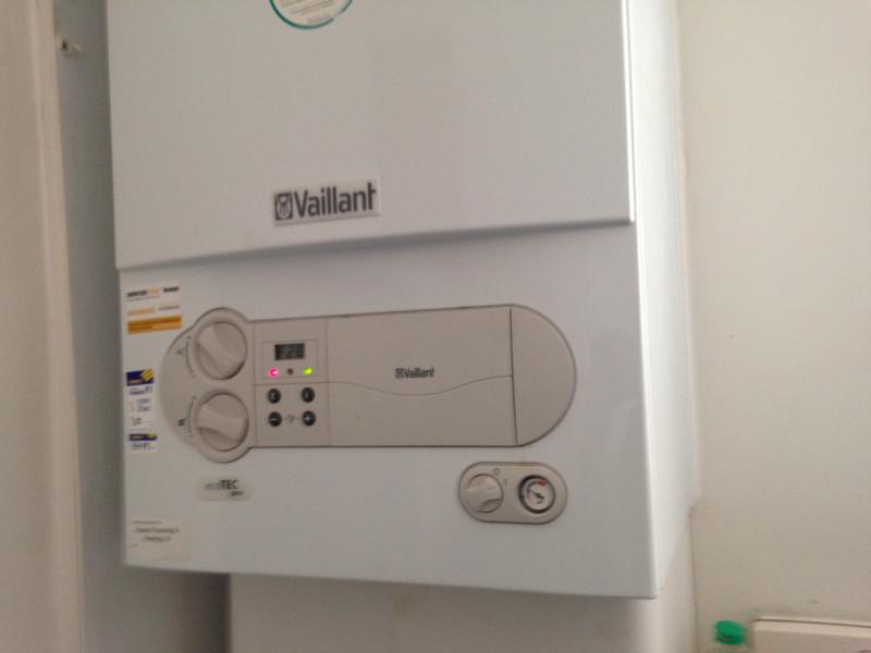

Just rented a new flat. The boiler is vaillant as per picture. Don't know how to turn it on. Will not get any help until Monday. If anybody knows how to operate this boiler please let me know.

F28 is the code that flashes up when the gas has been switched off, make sure the gas is on and then press the button with a flame with a cross and the boiler should reset and work.

Hi Gas supply was switched off. Thanks for helping me out.
