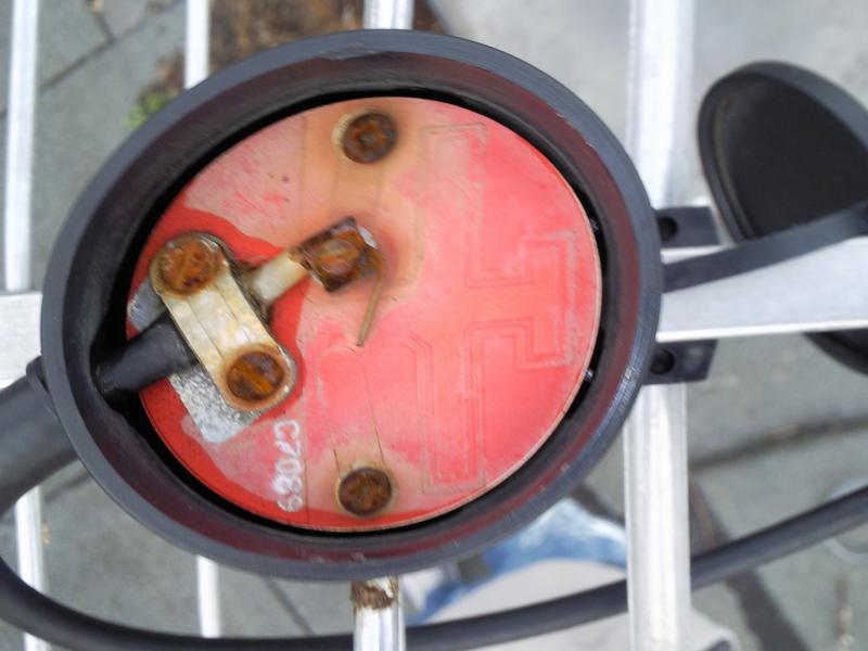

Hi radioredcat,
Just been up on the roof and taken a photo into the round plastic box on the aerial and your assumption is correct, the connections look pretty corroded. see below.
I have put the cap back on, it didn't seem to be split so I assume it just wasn't fitted properly. I'll order a length of cable and connectors from the website you suggested as there is a connection just under the eaves before the cable enters the building that I will connect to. Just wondering whether it is even worth doing if the connections in the plastic box are corroded. Is there anything I can do about this?

The connections to the aerial can't be replaced separately - the only solution would be a new aerial. However this may not be necessary, it may just be the two screws which are corroded.
You should also get some self amalgamating tape to wrap any connections with, this will ensure they are waterproof.
(as shown here : http://www.aerialsandtv.com/onlinecableandmisc.html#FconnJoiningKit )
Personally, i'd wrap the connection box with it as well, to ensure the lid is sealed properly and won't come off in future.
If the reception is ok when it's dry now i would do what flameport has suggested.
The coax is solid dielectric (inner insulation) so the problem is the corrosion that has takem place will eventually get worse so trying to undo the screws might break the aerial so it might be worth leaving it as it is put the cap back on and bind with self amalgamating tape.
Underneath that circuit board will be a matching balun which is a small coil.
How long it will last varies but i have done the same in the past and the aerials have lasted quite a long time,You could also spray it with WD40 which can help to slow down the corrrosion.
I have tried in the past to undo screws like that with little success but it might be worth asking the neighbours if they will chip in for a new aerial and coax.
