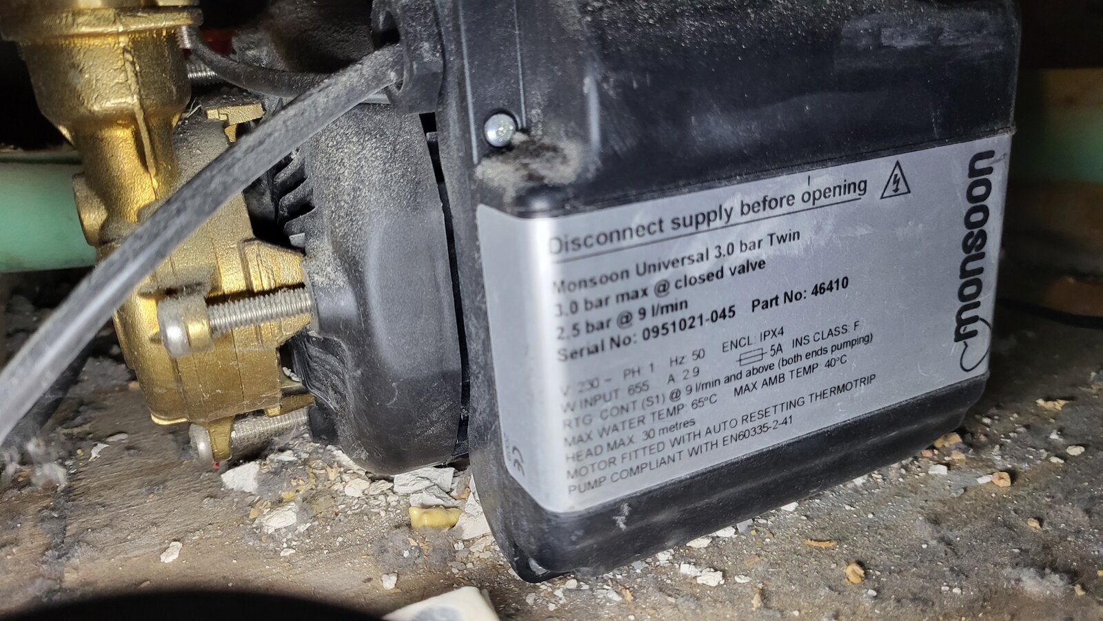

Don't know Madrab,pics would be useful. I suspect the OP's description of eves may be misleading.
Presuming the basin in the loft is a fair bit higher than 6" off the floor then the the hot tap will be above the level of the cistern, so probably no gravity flow, therefore the pump would have to be universal (negative head).
If so may just need the mini EV re-charged
Please post a pic of the pump.

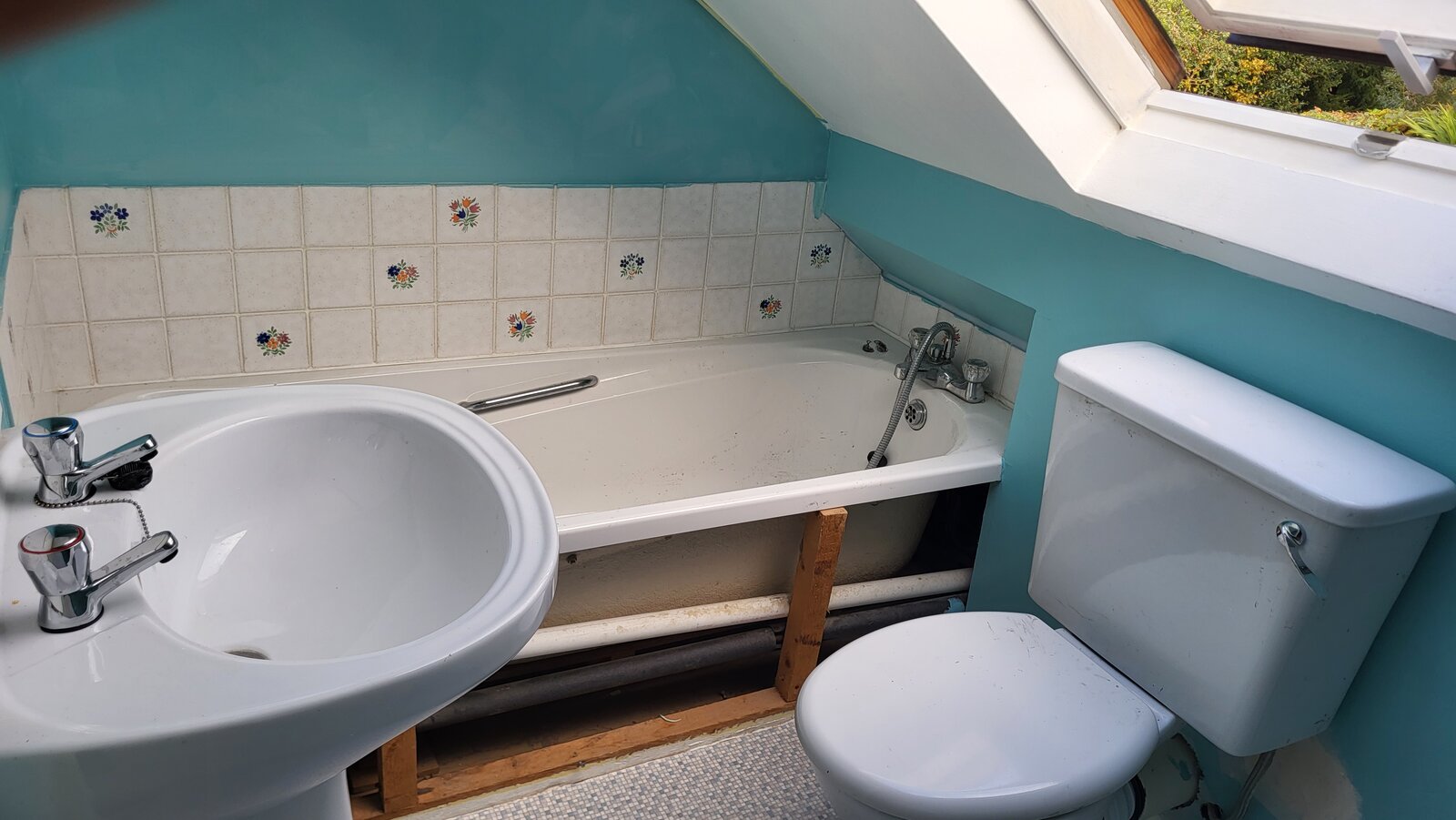

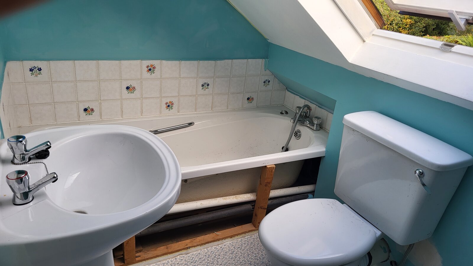

Yes sorry, the basin is on a pedestal and is around 800 mm off of the loft floor. The bath obviously lower! Pic attached. Excuse the mess..in the middle of decorating!

Ok you get upstairs hot tap running and shower is then turned off the hot water carries on running. If you the turn the hot tap off for 5 seconds and then turn it back on does any sort of flow dribble out
I turned off the shower and then the hot taps for 5 seconds and back on and they run fine. I tried this several times at differing intervals and it seems to stop working completely after about 30 seconds following turning them off and back on again. If that makes sense?

If it is what I think it is, then typically when the mini EV loses pressure, especially if it hasn't been used for ages, there's no longer enough pre-charge pressure to create the water movement needed to start the pump. The shower downstairs works fine as it's under positive pressure so there's enough gravity flow to activate the switch but not when it comes to the tap(s) in the loft above the CWSC, which is under negative head. It needs the EV pre-charge to hold the water under positive pressure and when the hot tap is opened the pressure creates enough flow to trip the switch.
