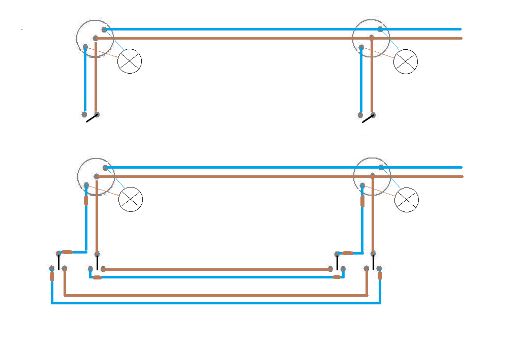

I have two separate one way switched lights in a large garage, with switches on opposite walls and intend to convert each to 2way operation for convenience, BUT maintain the separate illuminated areas.
I will need to replace the single way one gang switches with two gang 2way and could use two runs of 3core and earth between the switches as a conventional method.
I believe I could instead use three runs of 2core & earth if I used the brown and blue wires of one of the cable runs for the two separate commons.
Is this acceptable practice? If so what sleeve colours should I use on the interconnecting wires ends?
My only reason for considering this way is just that I have plenty of the 2+ cable and no 3+.
Any comments, please?
They should all be sleeved brown.
And I strongly advise some letter or number identifiers as well to tell them all apart.

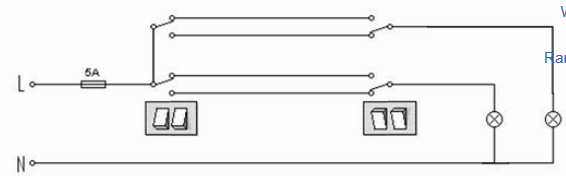

Or, if the rest of the light wiring is easy to get at:
Thanks for the quick reply. Brown it will be and the identifiers are a wise idea.
Would that circuit diagram, though, be only economically suitable for an "industrial" single wire cable set-up?
I would say chances are you won't follow the diagram, although the diagram does indicate good use of using 2 core+e, which is why it was posted I suppose.
Possibly more rewiring would be required to obtain something along these lines.
Alternatively stick to the more usual 'modern' methods, though substituting 2 core for 3 core.

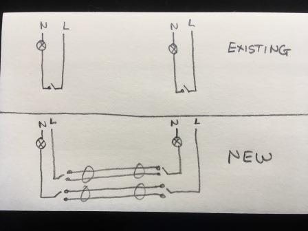

I'm not a spark, and I stumbled here as I have a similar situation, but... would it be possible to wire it with just two 2C&E between the two switch positions? I'm thinking as switch position "A" already has a line and a switched line (for lamp "A"), and switch position "B" has a line and switched line (for lamp "B"); then could you use the line at switch "A", via a 2W switch and strappers to a 2W switch at "B" to switch lamp "B", and vice-verca?
A rough sketch...
As long as the line conductors originate from the same CPD.
Good drawing, that would make good use of the 2 core+e, and clear diagram for the op, and minimal disruption.
Would there be any problem though, of an induced voltage at the second set of lights when the first set are on
I can't help thinking getting some 3 core+e and doing this is the standard conventional manner would be the best method.
