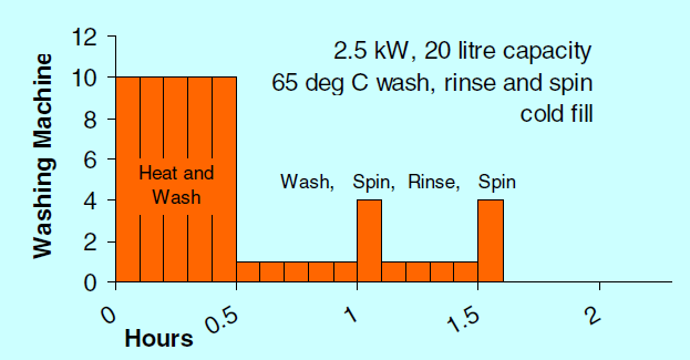

Indeed, and as for the WM (y-axis is {approx!} Amps) (courtesy of IET 'Wiring Matters' Spring 2002) ...
... so, a max of ~10A for 30 mins, and an average of ~4.2A over the 1.6h cycle ... and no dryer I've seen in recent times would draw more than 10A (max) and even that far from continuously.
