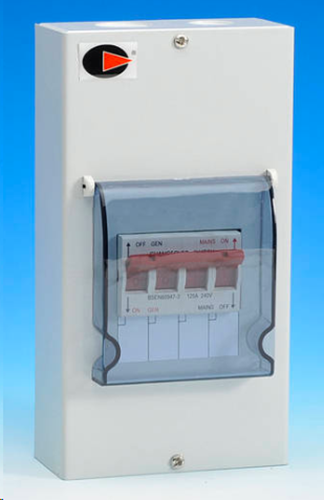

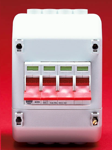

If that is a generic comment/question (i.e. about 'switches in general), I would think that many/most 2-, 3,and 4-pole isolators are essentially that ...
...but if you are talking specifically about 'plate switches' and/or 'change-over' switches, then I can't recall having come across that (previously) - but, having just looked, this is apparently a 2-pole changeover switch..
....however, none of the above are 'plate switches', and nor do any of them have intermediate switch functionality, so maybe they are not relevant to your comment/question?

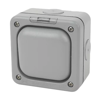

The only "6 terminal intermediate switch" I've encountered in the last 50 years has be an outdoor switch, this sort of style
but I cannot remember the make and it was simply 2x 2way switches clipped into a frame. I don't recall what instructions came with it but I just wired it up. Sadly I've encountered 'electricians' who've struggled with regular 4 terminal switches and I know they would not cope with a 6 terminal device.
