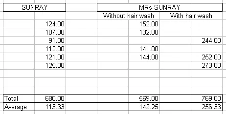

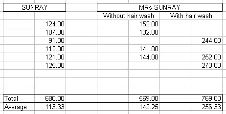

Are those figures minutes or hours?:ROFLMAO:
Oh my goodness what am I doing wrong:
I have a cheap event timer showing how many seconds a contact is closed for. Adding a current switch (clamp) to our shower supply I've been able to accurately show the duration our shower is powered for.
A random few days worth of showers from last year:
I reckon we must be walking around smelly or something as I'm getting 5 or 6 showers compared to only one by others.
