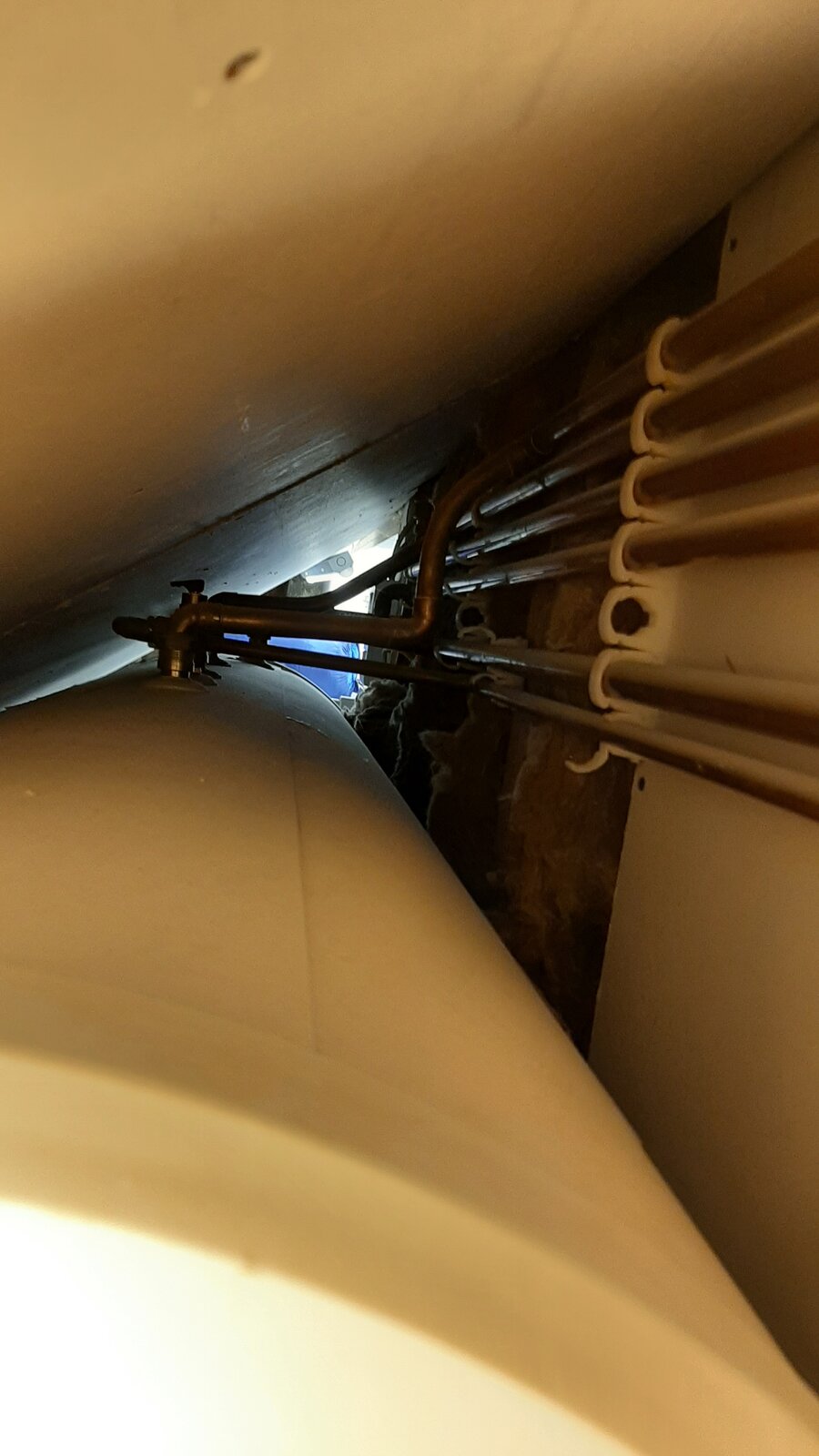

I've got a Gledhill tank laid on it's side with two 3kW immersion heaters.
If you have the cylinder on its side, where are you drawing the hot water from?

Strangely, from one end. It's like a vertical cylinder, but placed on it's side (and designed to be like that, or so I was told by the installer). And from my little experience over the last couple of weeks, the 'sink' immersion heater really does only heat up a little bit of the tank, while the 'bath' immersion heater heats up a lot of water. Not sure how that works seeing they are at the same level, so convection presumably doesn't come into play.

If the hot water is being drawn from the centre of the 'side' (as installed), then about half of the heated water will nor be 'accessible' (i.e. will essentially be 'wasted', since it will just sit in the top half of the cylinder). Starting from cold, you would have to heat half of the water in the cylinder before any significant amount of hot water could be drawn out - and, even if it started off full of hot water, you would only be able to draw off about half of it before it 'went cold', half a cylinder's worth of heated water sitting above the draw-off point and 'inaccessible.
It doesn't seem to add up to me, do you have a photo?
Oh! My mistake. Hot water is not tapped from the end - it's taken from the actual top (i.e. the long edge of the cylinder) when the tank is lying down. Harry's request for photos forced me to crawl in there and take a better look.
Photos are poor because it's such a tight space.
One end
T'other end
Side (see it's even got some proper feet to sit on!)
The only pipes that are attached all enter/exit at the highest point.
The only marking I could see on the cylinder
The first two pipes
The other four (I think) pipes
