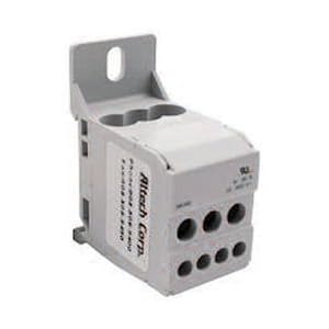

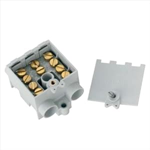

Where is a good place to get Henly blocks?
I assume from the name they must have been made by Henly originally?? Can you still get originals, or are they all copys now? I have read about some being better quality than others, as they seem pretty cheap, might as well treat myself to some decent quality ones.
OR - Plan B (a bit late now):
Use a larger enclosure for the isolator switch and put a couple of DIN rail distribution blocks inside.
