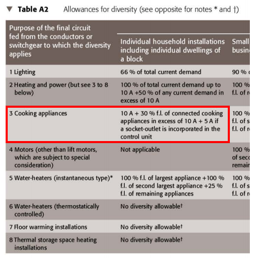

Please explain how I am in any way responsible for this:

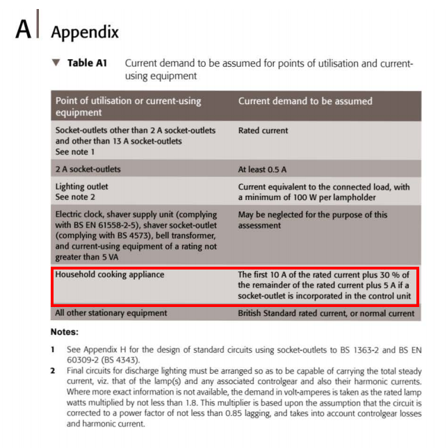

After diversity 18.4kW comes to 30A.
Depends on
1) At what voltage the load is 18.4kW.
2) Which table in the OSG you look at.
Doesn't make sense to me to only apply 10A to all three loads. Common sense to me dictates applying 30A + 30% remaining.

I must admit I'm back to the idea of 45A circuit, I don't really see why not...looking at forums, doesn't seem so unusual to me.

I get that completely, but just because that's the outcome of the regs doesn't mean it's logical. Theoretically if you had infinite appliances the regs would be ridiculous, so at some number of applicances it becomes stupid...if you get what I mean. So I don't think blindly following your logic is a good idea.
At 80A total load each would only have to be at 40% to max out the circuit. Am I the only one that thinks that doesn't sound so unlikely?
I would personally say that it's totally logical. As BAS has said, why on earth would several 'smaller' cooking appliances use less electricity if put together into one case, or one 'larger' cooking appliance use more electricity because it was split up into several different bits?
Don't forget that the diversity guideline we are talking about is the one for domestic installations - and the amount of cooking one does domestically will not differ according to how many or few #cases' one's cooking appliances are housed in. There are different guidelines in relation to commercial kitchens.
It's not just BAS's logic - it's the same logic that most people apply.
Don't forget that what matters is 'average current for appreciable periods of time'. If absolutely everything were 'turned on full' from cold simultaneously (which is virtually never going to happen) then yes, the full 80A would initially be drawn, but only for a very short period of time. Even if you continued using every single bit of the cooking appliances, the thermostats would rapidly start turning things on and off, and you would soon reach the situation in which the average current over any appreciable period of time would be a small fraction of 80A.
