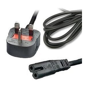

As a lot of people, under my TV I have a sky box, DVD player and also a small stereo. Three plugs, three cables... more mess. I was wondering two things. Does anyone know where I can buy a plug which has 2 or 3 or 4 of the two pin cables coming out of it meaning that I would only use one socket under my TV. Or, if I can't buy something like that.... is it safe to make it myself (with it properly wired). All the appliances are low draw.. no hoovers or anything like that.
this is the sort of cable I am talking about.
http://ecx.images-amazon.com/images/I/41IBttQoxyL._SL500_AA300_.jpg
Thanks for any help.
