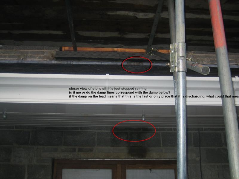

I have a problem with a tray that perhaps you may be able to help with?

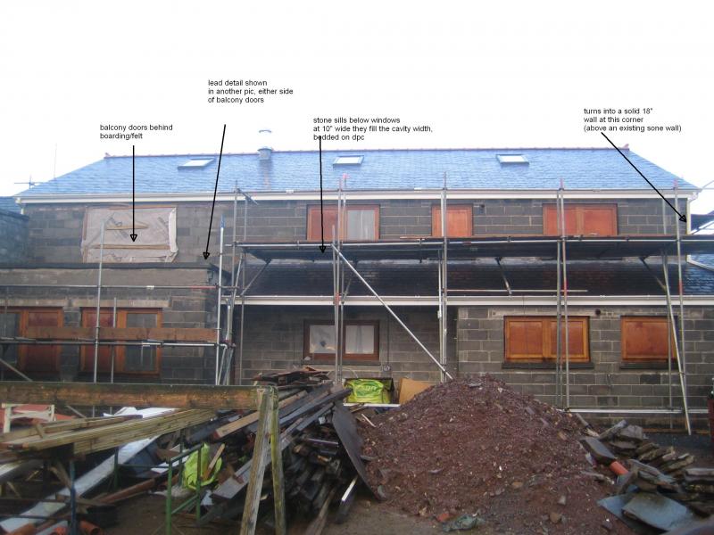

Newly built blockwork extension on rear (exposed, looking over valley) ground floor is larger than 1st floor so there were steel beams built in to build the block cavity wall above.

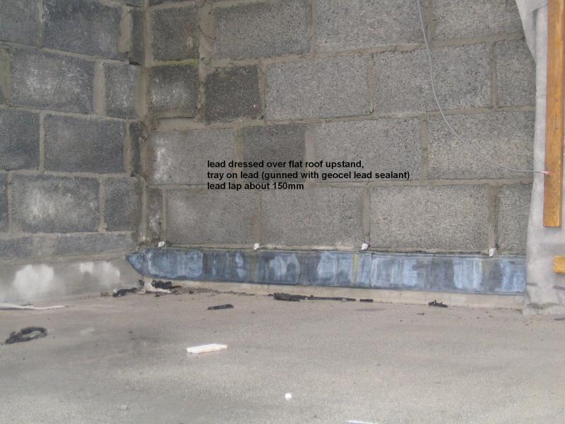

At the correct height a dpc tray was inserted along the length above a lead flashing, this then discharges onto a flat roof or pitched roof.
There are 3 stone sills below the windows. The dpc tray here is turned up around the sills.
The tray in the cavity is also turned up at either end where they meet the sills.
Blockwork at reveals was closed with insulated dpc.

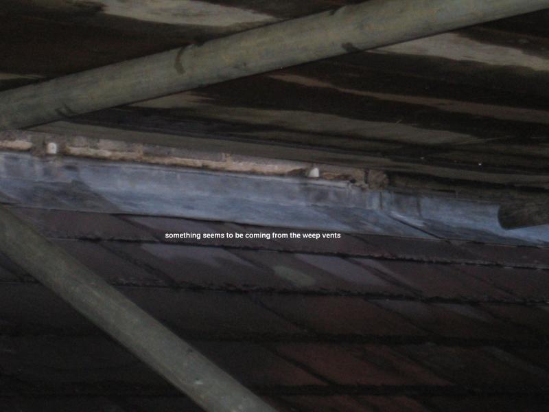

My problem is that when there is wind driven rain we have water leaks internally. Blockwork is now soaked through and pretty much leaks everytime it rains.
I cannot totally guarantee that tray hasn't been damaged, but I doubt it.
Render is not going on until this is sorted.
Any ideas & areas to check would be appeciated.
