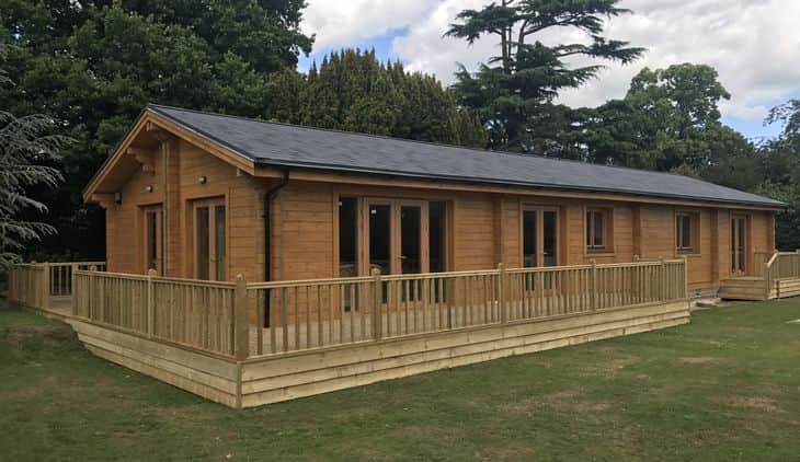

An interesting point is that 'mobile homes' appear to be explicitly excluded from BS 7671's regulations relating to caravans, even though they are usually made of metal and are really just 'caravans with engines' :)

As to the mobile home 1742031110055.jpeg, really, do you think one could really move that to another location? Clearly homes can be moved

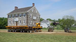

if one visits the likes of Beamish, most of the building have been moved there from elsewhere, this
is not a mobile church, but it is not its original location. I would call the picture top of page a prefab, not a mobile home, These are mobile homes,

As to the mobile home View attachment 376280, really, do you think one could really move that to another location?
That really is not the point. It's a legal definition. The one in the photo is, I'm assuming, the maximum size allowed for a mobile home, and all that's required is that it is capable of being moved in one or two sections. It doesn't have to arrive like that - in fact self builders can buy plans for a scratch build which if followed will result in a structure capable of being moved.
It doesn't matter if you'd need a vehicle larger and heavier that anything which could get anywhere near the site.
It doesn't matter if you'd need an enormous crane to lift it over trees and other buildings, which itself could get nowhere near.
If, as a structure, it's no bigger than 20m x 6.something, and is capable of being moved, it's a mobile home.
