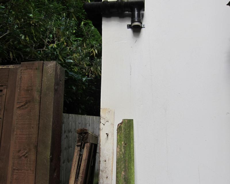

Types of rawlplugs used on this fencepost?
6 Sep 2004
1,069
71
This gutter has overflowed due to a heavily blocked downpipe (currently disconnected) and continually dripped onto the post and panel between the gate and these have rotted quite badly. I will need to replace this fencepost held to the wall with two 4 inch screws but I am unsure as to the type of rawlplug that has been used here – it does not seem to want to come out. In anycase should these be replaced?
Thanks for any advice.
Thanks, guys. Are they the type that are tapped in with the screw in place with a hammer or should a hole be drilled first? Certainly the screw was easily removed from its plug.
Not ideal for that application as they pull out easily. I would cut off and tap in some timber to get a firmer fixing.
Well I have tried to pull it out with a bit of a tug and it is not shifting. If I do what you say and cut the plugs can I just tap in a bit of dowel to firm it up?
