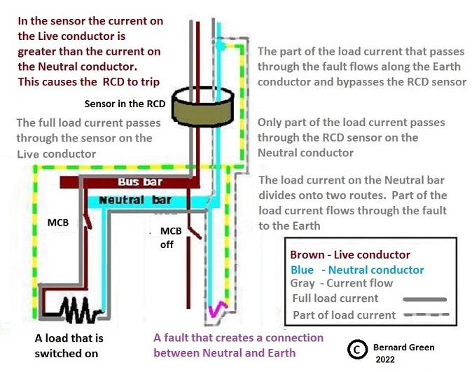

I think you have a neutral - earth fault.
The neutral with no load is same voltage as earth, so if there is a low resistance between the two, nothing will trip, as no imbalance. But as the load increases the voltage between earth and neutral also increases, not by much, but enough to cause current to flow.

I have seen it where a bit of damp toast in a toaster has caused a RCD to trip when kettle is used, as often we don't switch the neutral.
