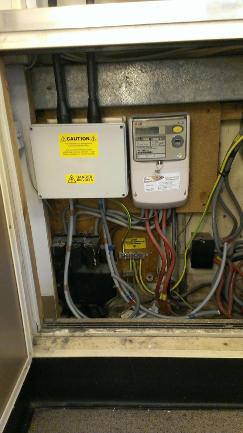

Hi all,
Just wanted to get a consensus.
Background is there is a shop, with two flats above it. The two flats get their electric via the electric head located in the shop below. The two flats have their own independent electricity meters
A week and a half ago, there was a problem in a flat with apparently blew the fuse in the head (located in the shop). UKPowerNetworks attended and disconnected the flat saying it had been connected by VIR cable which was unsafe and needed to be replaced. The fuse in the shop blew again a few days later because of another reason and the second flat was disconnected because of the same reason by UKPowerNetworks.
Electrical contractors were called to fix, and they have now replaced the cable with new 'armoured' cable and provided a certificate of work. They said however, they were not allowed to connect it to the main fuse head in the shop. They advised UKPowerNetworks were responsible for that.
A call to UKPowerNetworks resulted in their stance that it was for the 'electric supplier' to connect it as it wasn't their responsibility.
The flats are supplied by British gas and southern electric. I called southern electric first who advised it was the responsibility of UKPowerNetworks and they would not attend. I explained I had been told it was their responsibility. After holding for 20 mins on the phone, I was actually told it was the electrician’s responsibility and electricians are now allowed to break the seal on the fuse and connect to the main fuse.
As you can see - a nightmare. in the middle of all this wrangling they forget there are two families living there with children; both without any electricity.
I really would appreciate some advice on who you think is responsible for connecting this new cable to the fuse head? I may be able to upload a pic (pre fix) if it helps.

How has the cable been left in the flat?
Better post a pic of how it is presently.
To confirm that you need an electrician first to convert the armour cable to tails first. I would expect him to know that and fit a switch fuse.

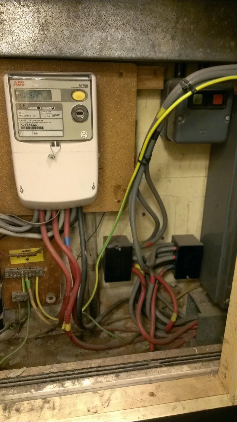

Here is a pic of how it is presented now after the electrical contractors fitted the new Armoured cable. I believe there is one cable for each flat
Thank you all so much for your comments and advice.
The suppliers reluctantly attended this morning, however they were extremely helpful and even tried calling the DNO on my behalf.
Please forgive any mistakes I make with the terminology I use! They explained the shop is currently using a 3 phase supply. The flats above were sharing a fuse each (via VIR cable) to supply power to the independent meters for each flat.
They then explained as the DNO had disconnected the VIR cables, the new rules meant they were not allowed to connect the new tails back into the existing fuses - the DNO should have known that when disconnecting. The suppliers said they need independent fuses where they can the connect the tails and that it is the responsibility for the DNO to do this. This was verified by two different suppliers (one for each flat)
Of course the DNO (UKPowerNetworks) are having none of it. You would think there would be mechanism where the DNO's and suppliers could talk to resolve such issues. They keep reiterating its a supplier issue but don't seem to understand they need to supply 'two new cutouts' (is that right?) for the tails to be connected into.

The suppliers said the cables terminating in the flat are fine. Once the tails are connected in the fusehead the flats should have power
