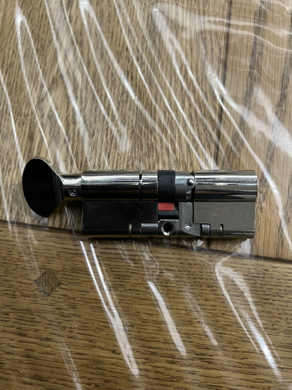

can I please have your views on the above eurocylinder or recommendations on which one I should use as a replacement?
Let me preface this with, I have changed at least a dozen of these euro cylinders over the years and never had any issues.
On this occasion, I purchased this Yale eurocylinder:

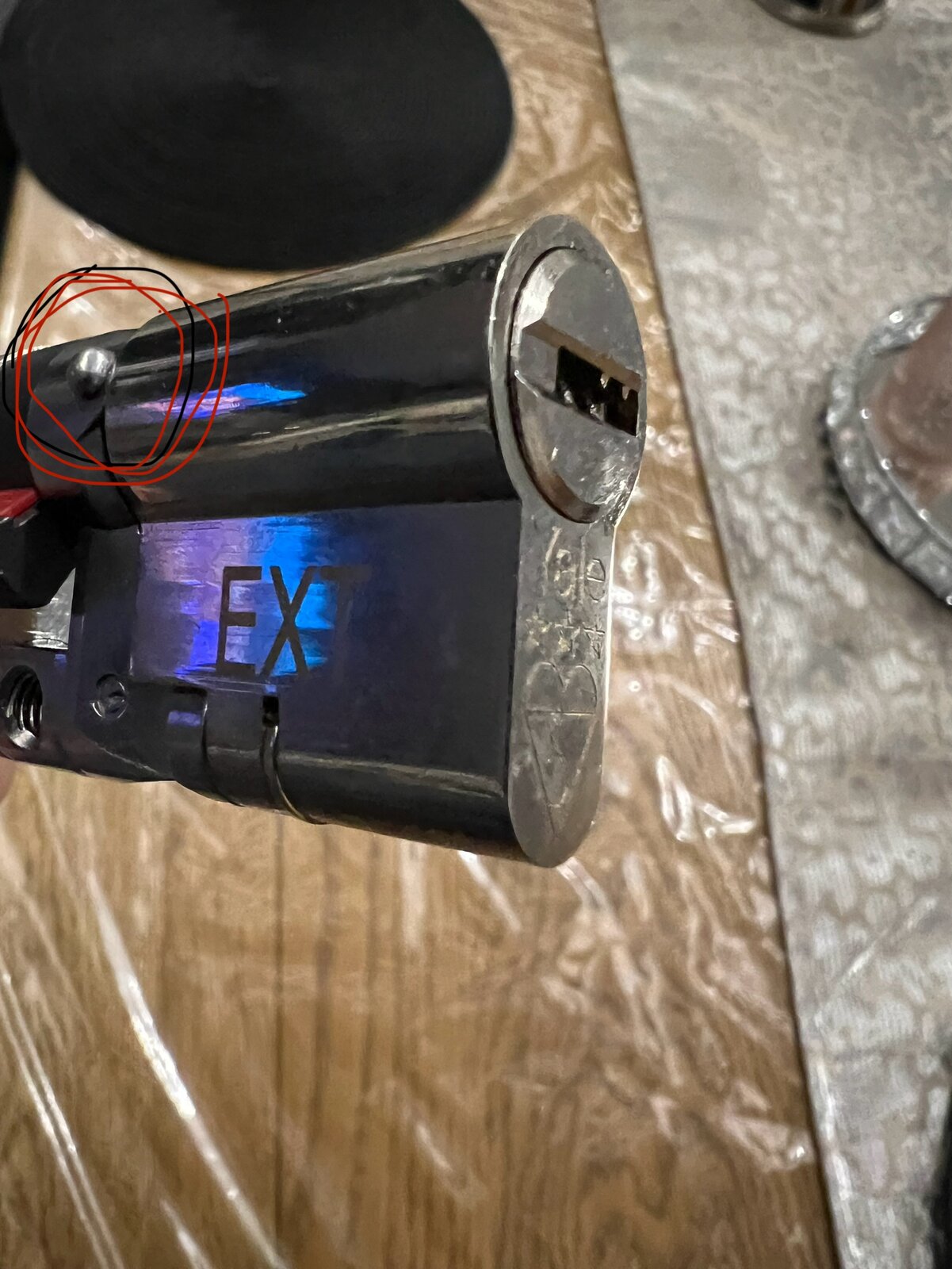

This lug (there is the same in the other side sticks out and stops me from sliding the cylinder through the lock.
I tried it on a different door and get the same issue. It’s too wide to slide through the lock because of these.
Any ideas on what they are and how I can fit this eurocylinder?
perhaps I need to slot it in through the outside of the door? Just dawned on me…
