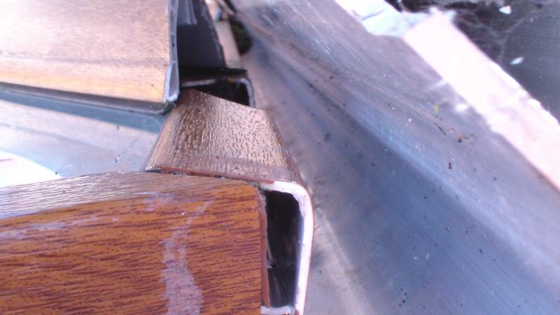

Those are the glass end covers. They have been cut poorly but I very much dought that would have anything to do with a leak.
While you have them exposed though it would be a good idea to take them off and run a bead of silicone across the top edge of them before replacing.
The idea of them is to protect the most vulnerable part of the units from the elements (the seals). With them sealed on the top edge any water should run over the trim instead of soaking the edge of the units which would cause them to mist up prematurely.

In response to Gazman16. I guess I can look forward to the 10' x 2' 6" glass panel misting up soon, as two 3" sections of the brown glass trim protecting the glass seal have been cut away and fitted badly by the installer.

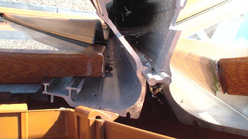

I have attached another photo. This time of the inside of the conservatory, at the bottom of the valley. This is one of the places the water is entering.

Ive got pretty good eyesite but that last pic is tiny lol.
Are the top caps knocked right down to the last clip? If so could you measure the overall thickness of the roof units when you get the chance.
Im not 100% sure about about Ultraframe but I think most roof systems are designed for a 24mm unit now-a-days.
