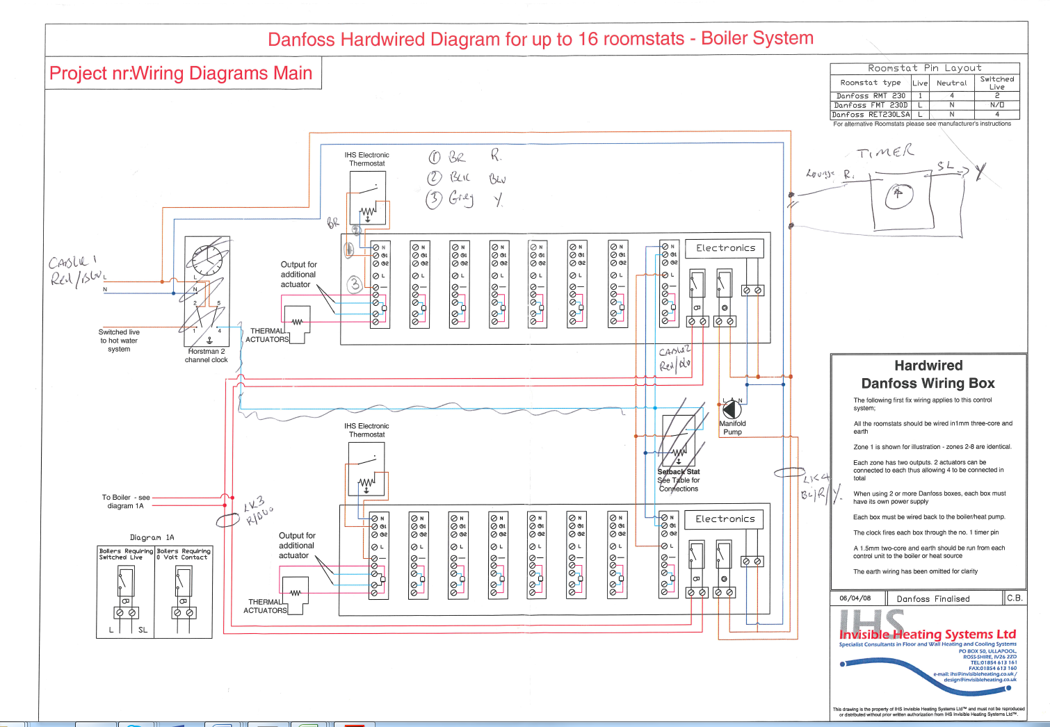

It does need an electrician who knows heating circuitry to establish where the pump gets it supply from when the ground floor programmer is off as the action on turning off the programmer then switching back on is a clue to the problem probably being in the wiring centre.
Did you get a wiring diagram from "invisibleheating" for an electrician to follow as you don't know what others before you have done!

There is a wiring diagram that I dug out of docs on house, but despite it having two wiring centres, it only shows one pump.... So I don't know how that transfers to my system? I do have two wiring centres, but I have two manifolds and two pumps. I'll upload it shortly :)

I have attached pdf of the wiring diagram I found and a jpeg. PDF is better quality - as I say, I don't know if its as installed, and I don't know how they handled the second pump, this diagram shows only one pump.
When looking at invisible heats manual, they don't have any system diagrams with two of their manifolds featured, so they never describe a system where zoning a manifold is required - HOWEVER, they do show two port valves in relation to systems with a hot water tank or similar, or radiators and underfloor , so I guess this is similar to having a second manifold.

Any thoughts ref that wiring? I know that there must be some additions to that since I have two manifolds and pumps but with what seems to be a lack of zone valves, is there any way with this wiring that could explain the weird behaviour with the stats and pump triggering?

I would start a new thread in the electrical forum section explaining the action of the pump and appending the above wiring diagram.
The electricians are always discussing CH problems and could point you in the right direction.

Ok will do. I did some more fiddling again in 10 spare minutes, and if I knock off all stats upstairs and downstairs, when both pumps were running, the pair both knocked off. But then only bringing a downstairs one back turns both pumps back on. It's not possible as far as I can tell to bring the upstairs pump on by itself. I'll link to electrical based thread from here once I get time to start it, maybe later or tomorrow. Andy
