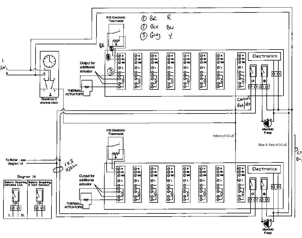

Yes. See the time clock that's scribbled out, and the blue line that's scribbled out - you want to be using that arrangement. Omit the hand drawn clock on the right and leave the WCs permanently powered.
Basically, if you cover up the lower WC in that diagram - that's how each should be wired. For your two wiring centres, you need to connect the supply L&N and timer signal (use the 3 core & earth) in parallel to both wiring centres, and parallel the boiler contacts between both WCs. Then connect the pump for each as it's shown for the top WC in the diagram.

For L&N for the timer, you can take these from the L&N terminals on the block you connect the output to - shown here as the right hand one but you can use any spare block. Note the separate pumps, each connected only to it's wiring centre and not the other one.
Use the 3C+E link cable - Red=L, Blue=N, Yellow=Timer signal.
Same for the timer, use the 3C+E that goes to it, same colours as above.
The boiler connections are already in place.
Try this.

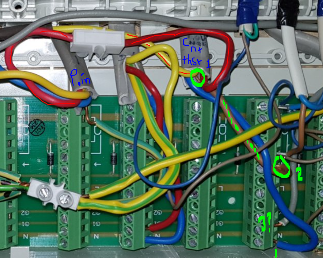

OK so here is the next update, seems it is possible to still get power to upstairs, but im not sure I can write down the conditions.... dont ask.
However, with a bit more poking about, and reading the older comments over and over, looking at the diagrams, wiring etc.. it became apparent to me that it looks like the thermostat in the living room, and the main controller (next to it) are possiblt using the same 3 core + earth cable, whereas between them they should need 5 cores... I suspec there is something really screwy going on here now, but I need to pull off both devices from the wall later today and see what the hell is going on there.
In my previous images, its the wire ive dotted in green thats an earth core, but with a sleeve in brown at this end, that I think is going to one of the thermostats, and the other wire going to that stat is the blue one from the same cable. The red and yellow cores from that cable, i think, are now going to the programmer, and thats where is making or breaking power to the whole system by joining or not joining the yellow to the red at its contacts (tbh this does seem a bit sketchy?).
So now I need to confirm my suspicions. If this turns out to be the case (there might still be some full sketchy wiring at the stat and programmer end, im not assuming anything here as I cant quite work out how the stat can do anything without its third wire.... ) then I think the first step would be to wire that stat in correctly, as well as moving the controller near the cupboard where this all is, so i can use a new piece of wire to connect it correctly. Ill also have to then remedy the connections from this box, to the upstairs wiring centre, but I think that will just involve removing a link not needed, and connecting that pump link, instead as a new link feeding the switched live to the timer rail, that provides the power when the system is on, to the thermostats and the actuators.

One thing that I hadn't grasped was the timer track in the board, was responsible for powering the stats, and once I realised that when i spent more time looking at the diagram, and reading back, then it became more clear why the upstairs system behaved weird, and also why the downstairs pump stayed powered - there was a route from a live back to the downstairs pump even when the relay was open downstairs.
I also couldn't work out how the stat and programmer were sharing cores - but i found out last night that the programmer is making and breaking the power as expected, but they have also powered the stat off that switched live locally at the wall plate, which will work, and gives a live when require to the stat, and allows it to send 240v to the central "make hot/close relays" line in the W.C.
Once I knew that, I was more confident that side doesn't need meddling with, so last night, i shut it all down, and pulled the link between the two pumps, and used that link to join the "timer 1" rail between the two W.C. I also re-made a few connections which were sketchy where 2 or 3 wires were in one side of a choc block - not nice. Why they didn't make better use of the large Live track and free connections in each zone block, or the Neutrals along the bottom, Ill never know!
That seems to have sorted a lot of the problems, but generated a new one! The boiler initially wouldn't fire up, if it wasn't late at night and I was worried about today, id have left it longer, and it may have just been it going through siphon prime mode or similar, but I also noticed that the downstairs W.C. was using the wrong relay block, so I switched that around, so the right relay was used for pump and boiler trigger respectively, and also that the polarity was the same on both WC for the boiler relays, I couldn't see why that would be the issue but seemed best practice...
And that seems to have fixed it. I did also stick the boiler on comfort always mode, and it seems to be switching in and out when demanded by the underfloor system. I did learn last night that the big combi I have, R40 , is known for not being the easiest to control, although I couldn't find any real info to qualify that it is/is not, just a bit of hearsay on a few other threads about whether or not external controls work with them or not, it seems to work fine in this install, at least now it does.
So I have essentially followed quite a bit of the recommendations from SimonH2, although for now the power will remain made or broken using the controller to both W.C., and the "hot" link will provide 240v to the timer line, instead rather than the timer powering those on both boards. Is it clean? No, does it work better than before.... yes, 100%. Will it remain like this? probably not, as there are a few changes we need to make to the house, and it will end up involving the heating at some stage, but at least I understand the oddities it has now, and that means I can label the wires up, so next time someone looks it will be clear whats what...

If you follow the switched output of the timer, it connects to one of the unused "stat + valve" zone connector blocks. There's a L&N on that block you could use to power the timer - just needing a 3C (+E) cable from the WC to the timer.
In the WC, the N, clock1, clock2, and L terminals are all commoned across the zones. So you can use the L & N of any of them for anything needing L&N. The clock1 and clock2 take the output from one or two time clocks and use them to feed the stats for each zone - as shown in the example connection on the left hand block.
Then the terminal with the arrow in takes the switched line from the stat, and connects it to the L connections for the valve actuator(s). There's two L & two N connections in case you want to control two valves from one stat - nothing more complicated than that.
Anyway, as I altered the diagram for you, the yellow core of a 3C&E takes the clock1 line from one wiring centre to the other. What I'd be doing is connecting the timer to one of the zone connector blocks (using the L, N, and clock1 terminals), and connect the yellow core of the linking cable to the clock 1 of another spare zone connector block. In fact, to make the wiring easier (less wires stuffed into one terminal), just connect each end of the link cable to a zone connector block (red to L, blue to N, yellow to clock1).
Hmm, been back and read things again. Do the time clock and room stat share one 3C&E cable ? If so, then that complicates things a little as it's not possible to (safely and regs compliantly) wire that up to work properly - it's not acceptable to oversleeve the bare CPC and use it for anything but an earth. If that's the case, I'd simply move the time clock to be adjacent to either of the WCs so it can have it's own cable.
