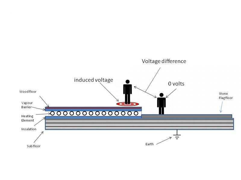

I was called in to investigate exactly this problem with a Carbon Film UFH in a kitchen (wooden floor).
Shocks were encountered if on person was on the wooden floor and touched another person standing on an adjacent (slate) floor. Also if you touched the taps etc.
The supplier (Flexel/Ecofilm) at first denied this ever happening before. After much prodding they said that this was known by the maker (Scandinavia, edit: Scotland) and they could supply a conductive mesh that needed to be earthed.
Floor lifted, earth film installed, floor relaid, problem solved.
PS they are still arguing about who is gonna pay for it!

It was suggested that it might be an earth or neutral fault on this one too, but it is surely EM induction.
This is how I explained it to the customer:

Do you think laying a bit of aluminium foil, say 300mm square, on the floor, and measuring any induced voltage between the foil and earth with the UFH turned off, then again with the heating turned on would be a valid test for capacitive coupling?
That is the way to measure it.
Use a high impedance meter measuring volts located next to the earth reference point and a long lead to the test pad will show the induced voltage. The voltage should reduce if a resistive load connected between the test pad and earth.
If you want a thorough test result then move the pad until you find the locations with highest voltages per mat and use those as the test sites.
Note the voltage without a load across the meter. Then connect a load across the metter and adjust the resistive value of the load across the meter until the voltage drops to be half the un-loaded voltage. Then the resistive load is approximately equal to the impedance of the capacitive coupling between heating mat and the area of the test pad. From that you can then work out if the capacitive coupling is sufficient to permit a dangerous amount of energy to be capacitively coupled into a body that is in contact with an earth or other route for that energy to pass through the body to cause injury.
