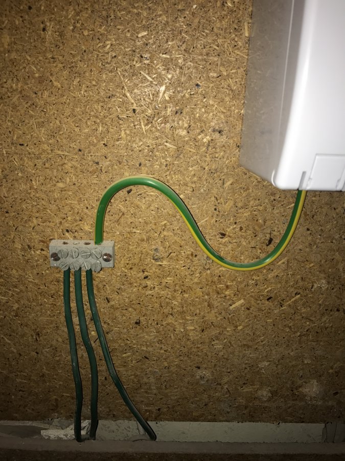

The terminal strip I mentioned before has 3 thin Earth cables connected to it and then a single Earth cable going up to the Earth bar terminal marked "E".
Whereas the gas bonding is 10mm squared Earth cable and goes directly to the consumer unit Earth bar marked "B".
Does that give any clues?

Here is a picture of the connector strip with 3 earth cables in it that connects directly to 'E' terminal on my CU's earth bar.

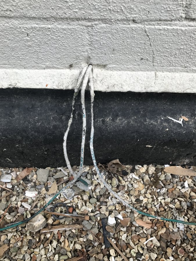

I assumed that these 3 cables were connected to various locations around my house, but they are not. They exit my house here:
They go under my brick driveway (away from the house) so I can't work out where they terminate.
The Gas Pipe earth cable attaches to a connection on the mains water pipe and this goes directly back to the CU in 10mm squared cable to the Earth bar terminal B.
Any idea as to what's going on with these 3 earth cables that exit my property? Why are there 3? The are not connected to my Earth rod. Could they go back to the supplier somehow?
No.
Please stop thinking that you could have any earth cables going back to the substation in any way. You can't, you don't, and they don't.
They go under my brick driveway (away from the house) so I can't work out where they terminate.Any idea as to what's going on with these 3 earth cables that exit my property? Why are there 3? The are not connected to my Earth rod. Could they go back to the supplier somehow?
There could be multiple earth rods - and all is well. Although they should be inspectable.
B for Bonding conductor - so correct.
E for Earthing conductor.
You were right, EFL.
Mystery solved.

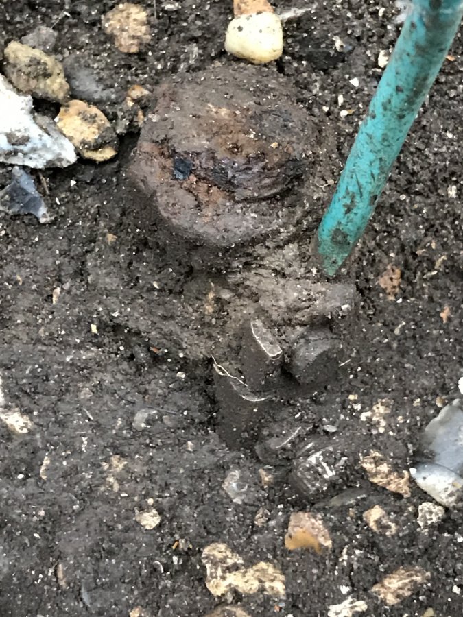

I managed to dig out one of the earth cables (about 10 inches!) and low and behold it's connected to a rod!
I assume the other 2 are also connected to rods but they are no longer in serviceable locations.
I think this would be a good time for my electrician to do some testing on the rods and install new ones if necessary.
I think the disconnected rod that I mentioned was a bit of a red herring and this was originally installed to connect directly to the gas mains, but in recent times this was changed and now connects back to the CU instead.
